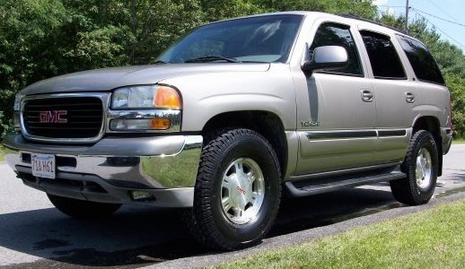

2000 GMC Yukon w/ 285/75 R16 Procomp All terrains. Slightly cranked front T-bars
Edit: No trimming, rubs inner fender ever so lightly at full steering lock. Doesn't rub the body, even with the new Sierra bumper.
