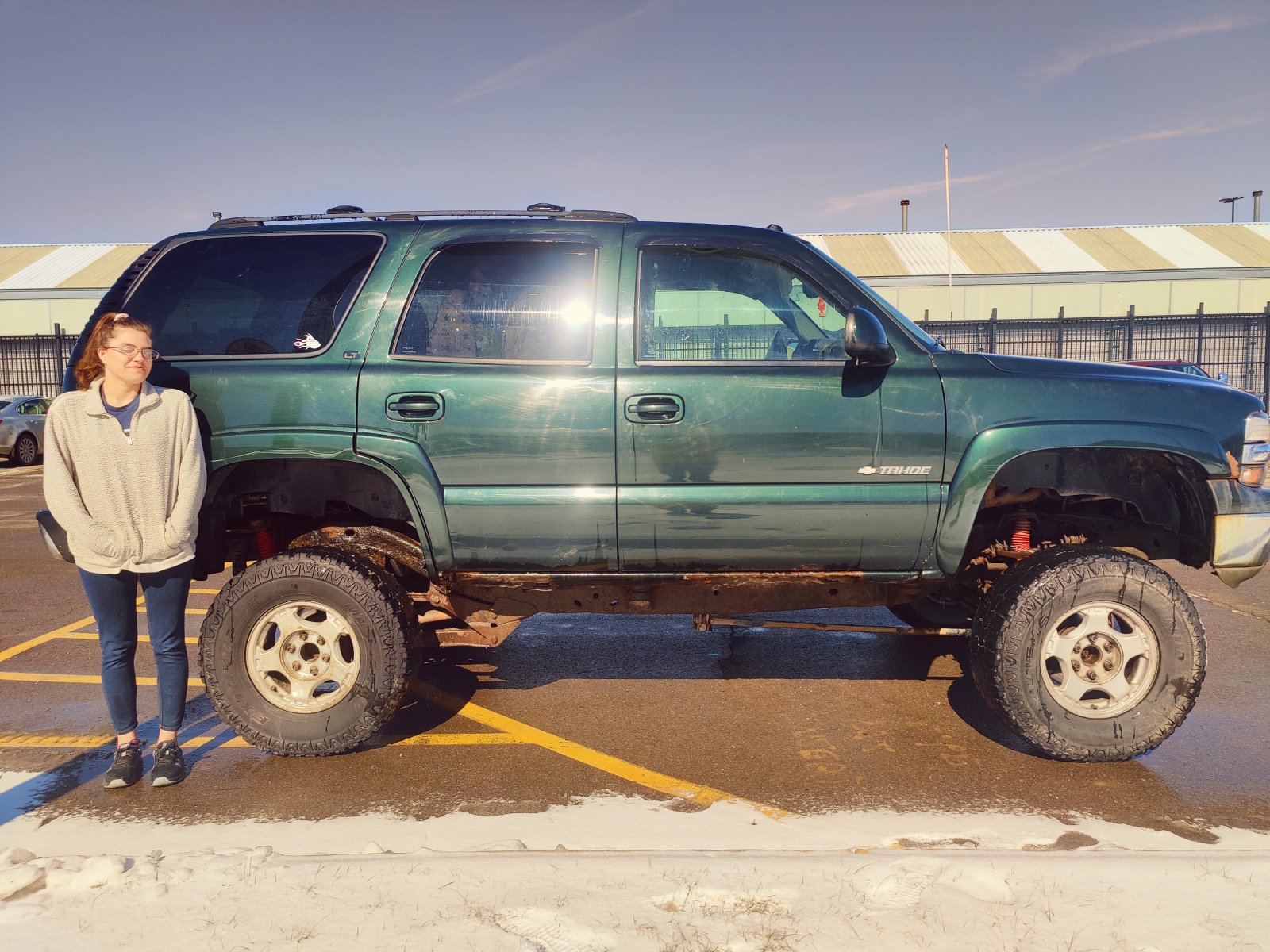

I will attach a picture of my truck. Mostly the truck will be used on pavement, some highway use. But I do want the ability to go off-road, go in the mud or drive through fields without getting stuck. We have a very muddy area when warm and a lot of snow when cold (2+ feet normally). Our driveway and many others turn into mud pit during spring, fall and anytime there is rain (3+ inches of mud) and we find ourselves driving through fields and other areas often to access part of our land. Currently we have always relied on my dad's Yukon xl to go anywhere on the property other than the driveway as none of our other vehicles could reach them.
