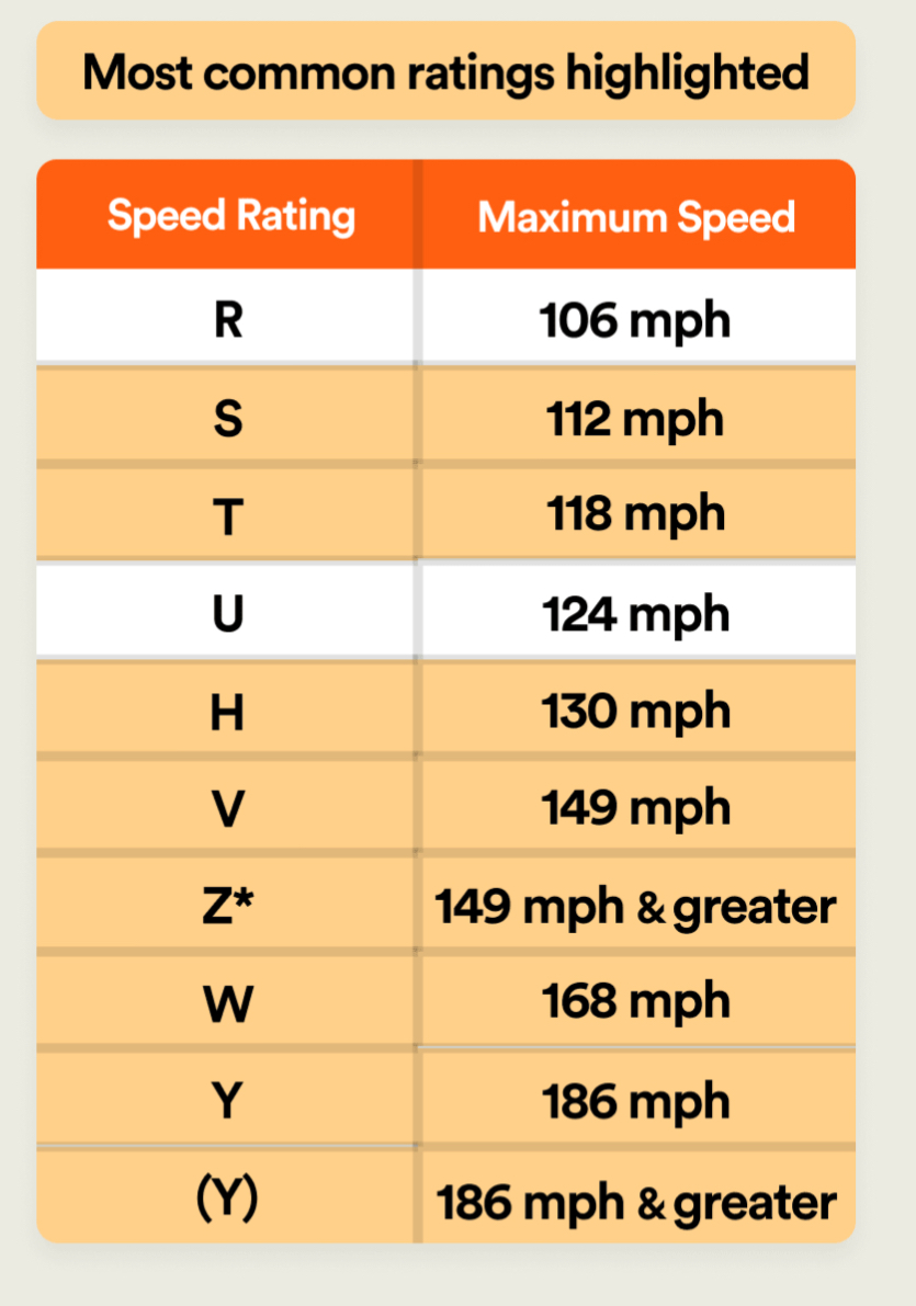

Be wary of the change in the tire speed rating that determines its steel cords in the sidewall and tendency to roll or feel slushy.
H should be the bare minimum you should be running. If the price is right I will buy all the way up to W rated because the can take a nail puncture and you may not notice it for months.
