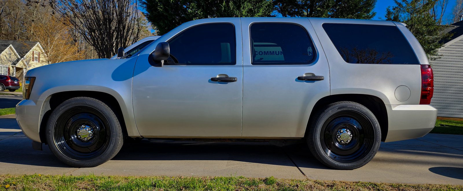

In case anyone was wondering that hasn't found what they need elsewhere, this is the Belltech 752SP kit (3"/4" drop). With the 22" Transports and 275/45, I have zero rub at full lock both ways.
