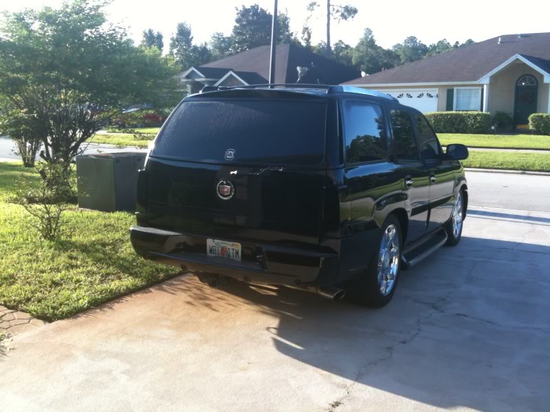

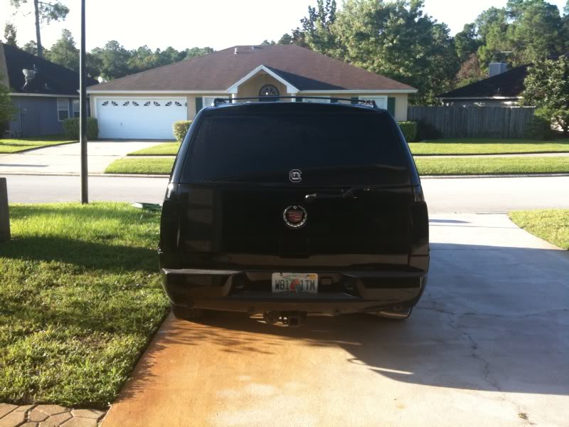

Well, yesterday I tackled the tinting of my tail lights. I've been putting it off for a month now. I've had everything at the house, but to busy (or lazy) to do it...
I used:
2000 Grit Wet Sand Paper
Gravity Feed Paint Gun
High Speed Buffer
Polish
Wax
Clear Coat
Black Paint
- First I took off the lights and wet sanded them, keeping the sand paper wet. After about 1 full minute, I stopped and checked the lights. When a white haze/fog appears, your done.
- Dried off really well
- Mixed 75% clear with 25% black paint and sprayed 2 coats, waiting about 20 minutes between each coat
- Let sit overnight (about 16 hours)
- Wet sanded using the same method as above
- Used the buffer and polish to smooth out any ruff paint
- Applied 2 coats of wax to the lights with the buffer
Sorry for the crappy cell phone pics...

Looks great! How well do they light up at night?
I'll find out tonight. They aren't as dark as they look in pictures. You can still see the red tint of the plastic in the sunlight. I'll take some pics tonight and put them up in the original post
