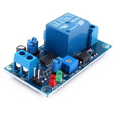

The only delay relays that seem to fulfill the niche are based on 555 timers. While is an IC that I have a lot of experience with, and tolerates voltage fluctuations extremely well, another project may solve issue. Was looking for a drop in relay preferably to replace existing headlight relay(s).

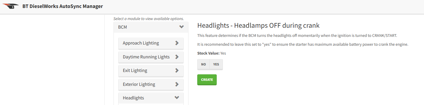

when mine is turned to start the headlights go off, then come back on when the key is returned to run.
and no a tech2 will not change that but could be used to troubleshoot why it is happening.
Yep.. That sounds about right. So there will still be one "pulse" as you crank it.
If you want your lights on during cranking because you have plenty of juice, autosync programming can do that also.
