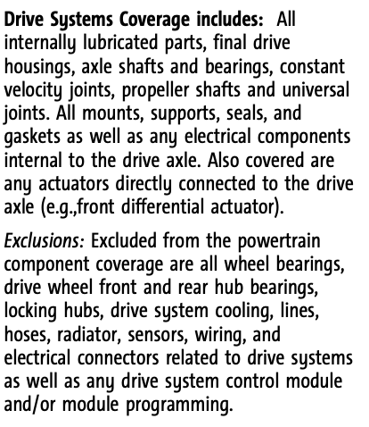

Axel shafts are part of the Powertrain coverage and are 5yr/60K miles, from the warramty booklet, see below and go back to dealer...

It may or may not help but you could call GM and open a case. Good luck and it looks like it should be covered for sure.
