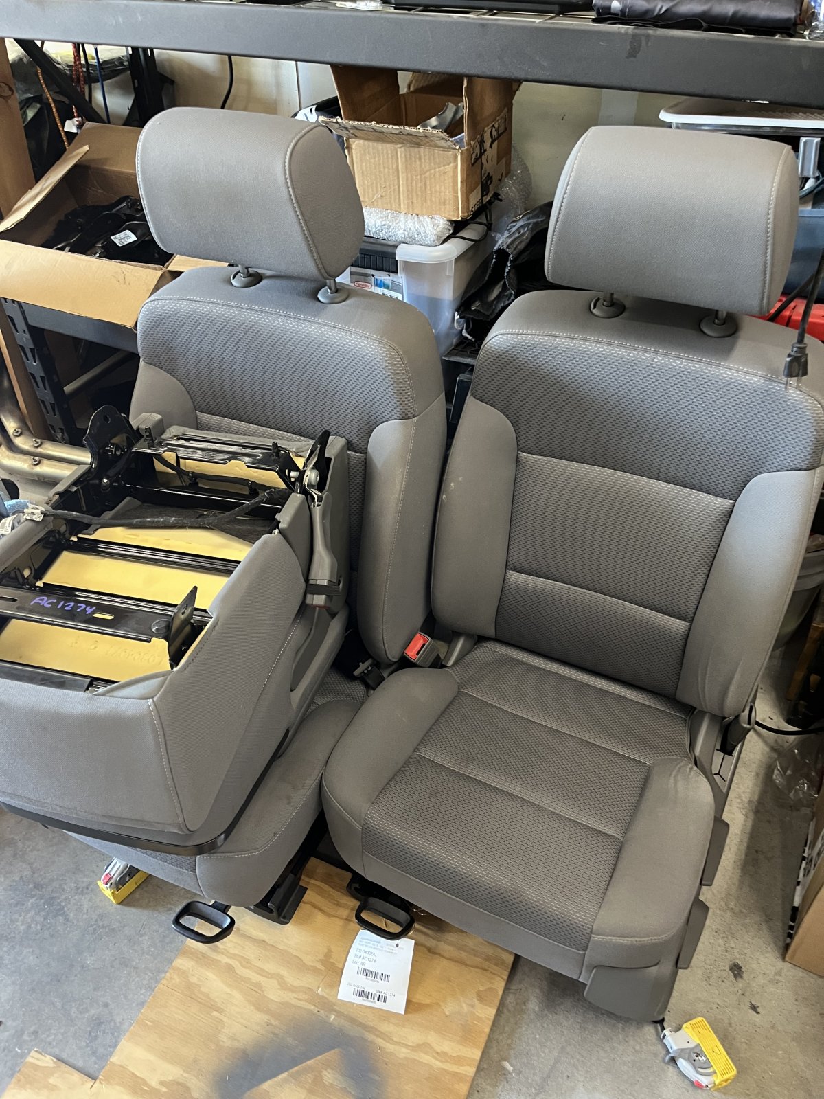

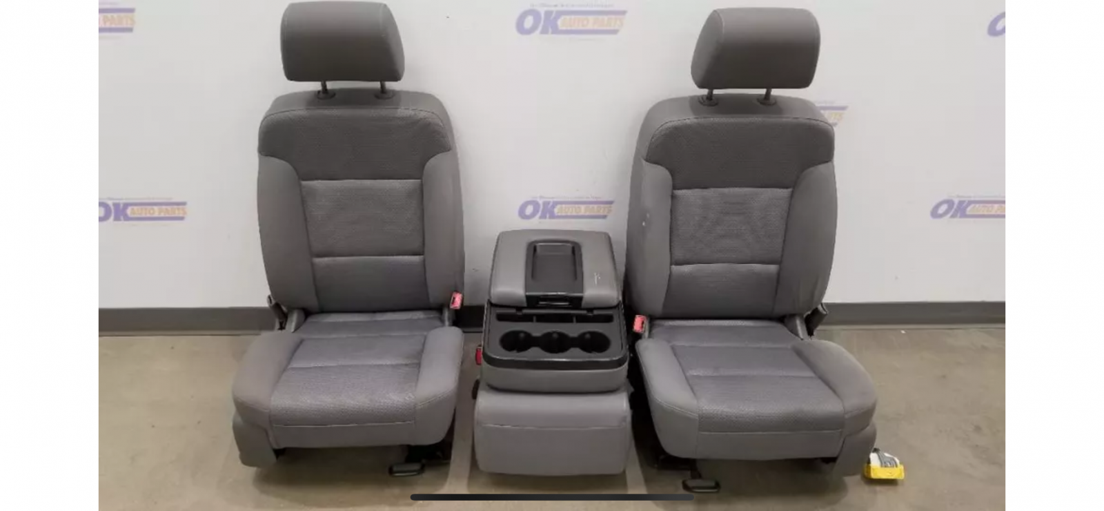

New update again… really starting to crank on this Tahoe, just bought new seat set. A few years ago re-did the seats with new OE covers, seats cushions for both passenger and driver. Still didn’t like the way they sat or felt.
So I bought 2014 seats, as well as the center console/jump seat from a Silverado. I also plan on putting the Gen5 third row seat into my 2nd row. I’ll be using OBSoutpost.com for the seat brackets

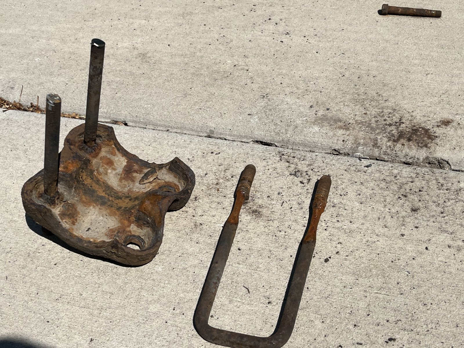

Yeah my comment was more of a joke.. I had to cut the U bolts off, no way I’m using that crap, new plates were already bought.
Update: my seats arrived from OK dismantling.. came in a huge crate, I’ll get pics tomorrow when I open it. Spent all day putting in the add-a-leaf and doing the rear lift, 101* heat and I’m not in a garage. But I got them done except one last bolt, the damn thing must have gotten some debris in tte threads, good thing that it happened on the first inch, cut it off and got a new nut

2014 Silverado. The SUV’s of the same year won’t have the jump seat console, which is what I wanted. The seats are manual, non-power, which is also what I wanted since I have a 2dr and it’s easier to slide the seats to get people into the back.

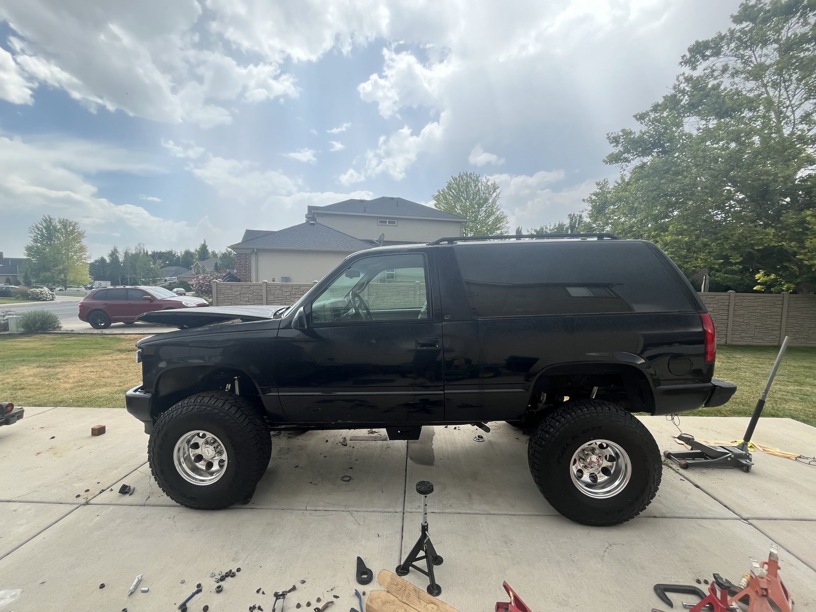

Finished with the rear suspension. This is with the blocks and the add-a-leaf,
Kinda “stink bugs” a bit.. I do have room to crank on the front bars so maybe I’ll do that. Need to change off the hood and put the grill on

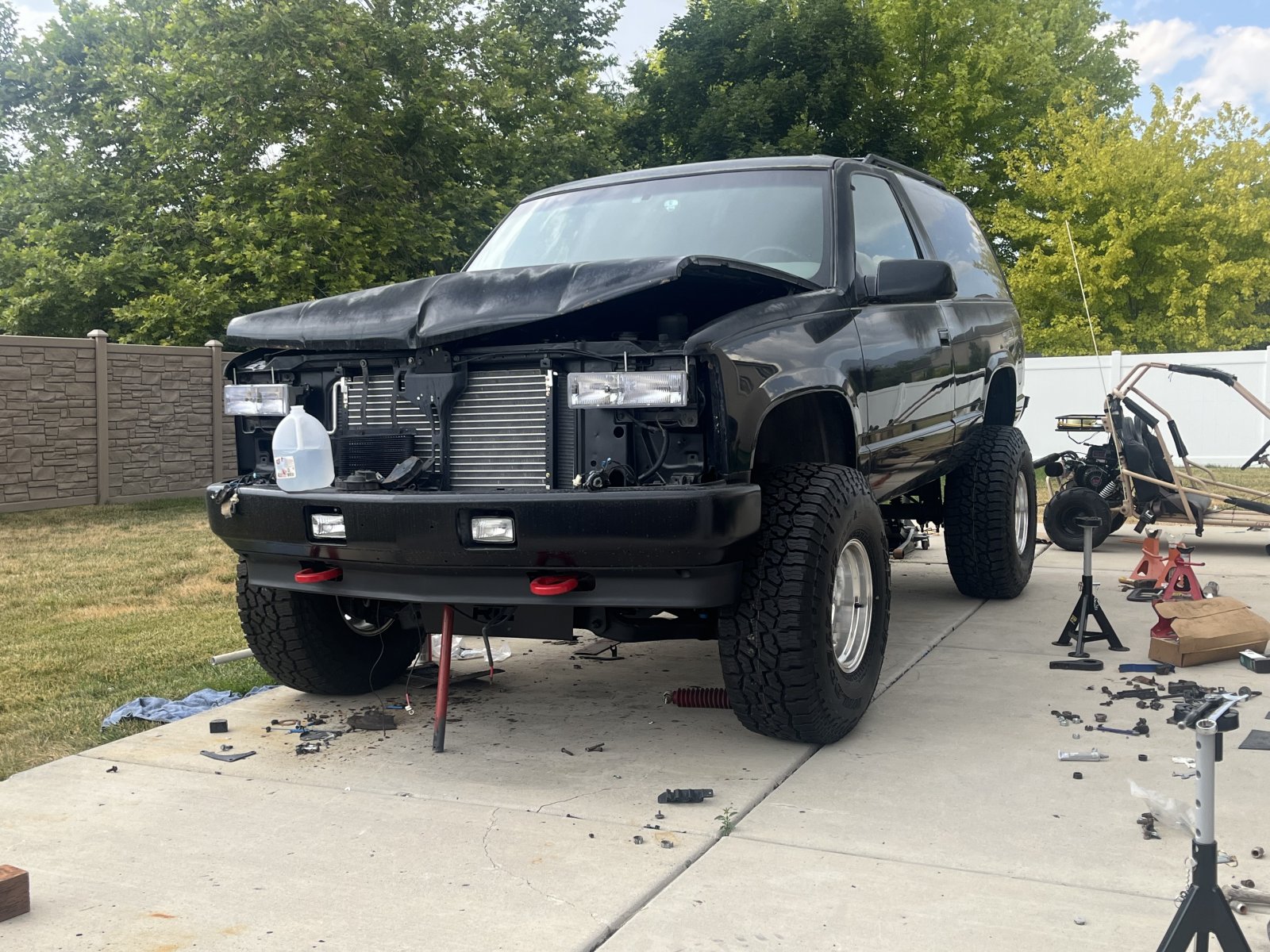

This truck is just great. I love the wheel combo as I’m not a huge fan of the big rims. These deep dish hit just right. Good crust around them and a few pepperonis. Can’t wait to see it completed!!

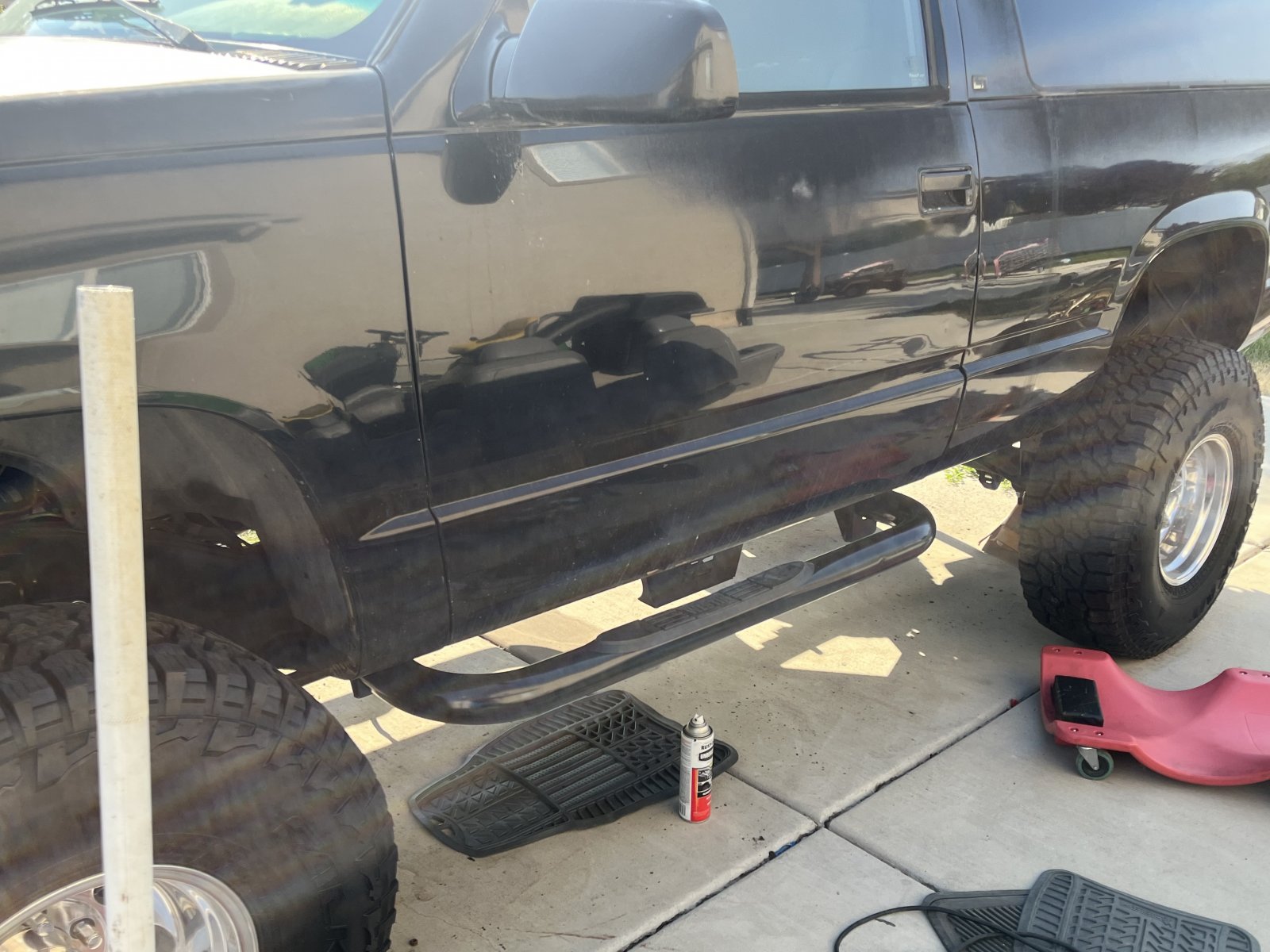

Thank you . I also need to pull off the rear bumper and send it for powder coating to match the front bumper. I’ll do that this week on Wednesday. I also have some black side step bars by Weston that need to go on.

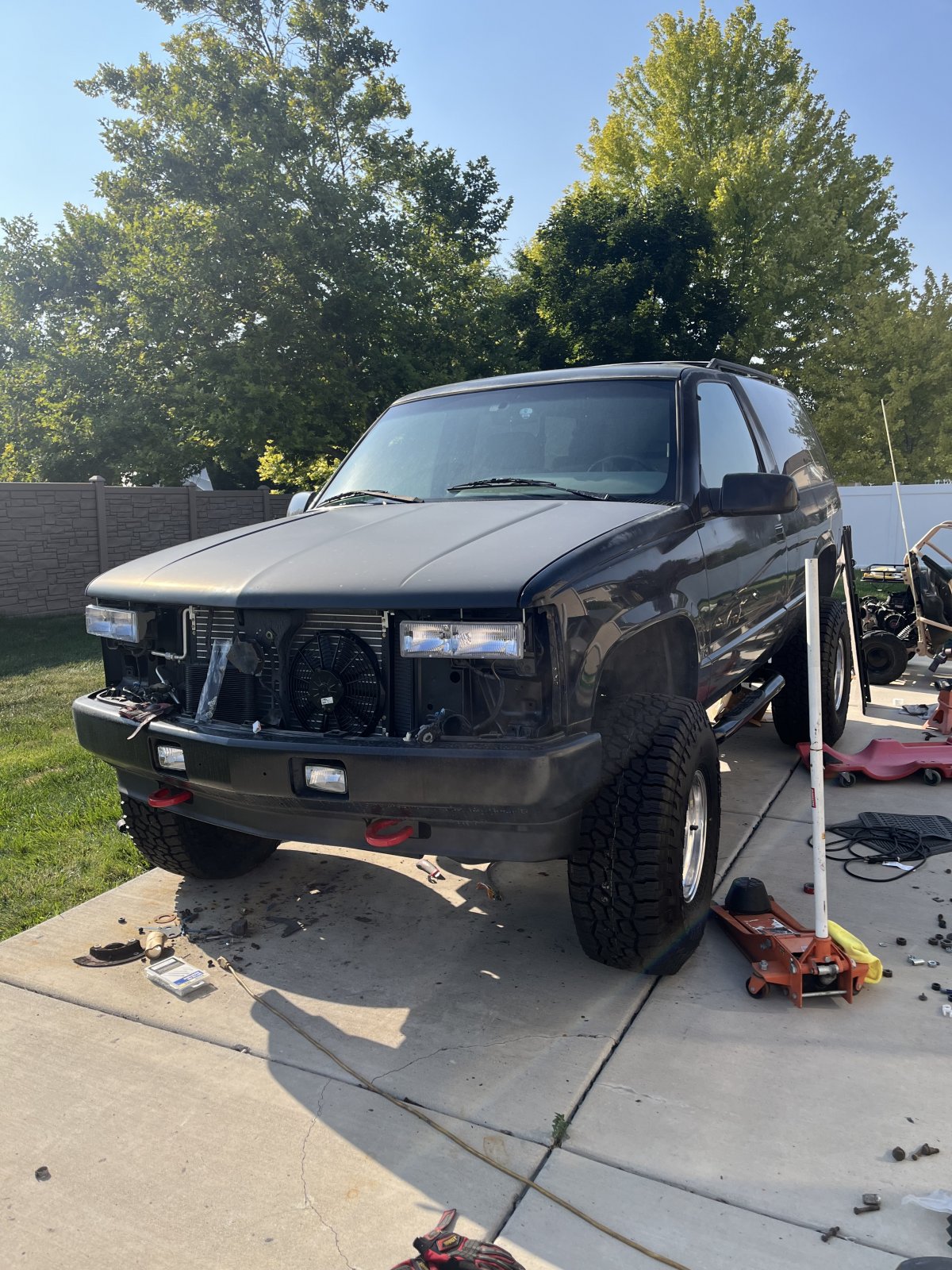

I read in a thread here that someone installed a small electric fan on their condenser to help cool the AC in stop and go. So I bought a SPAL 12” pusher fan and relay kit, I’ll be installing that tomorrow. I also go the damaged hood off and the new one from LMC on. Just need to finish up a few wires, put the battery back in, and fire it up.

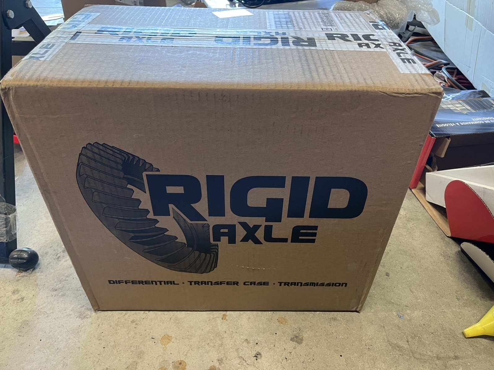

4.56 gears and truetrack (will have a shop do this)
