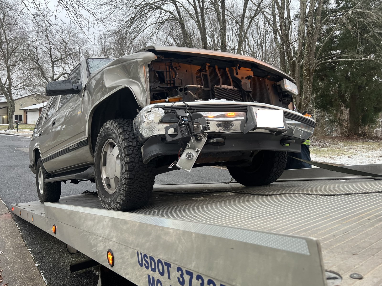

This is what happened to my tahoe in May

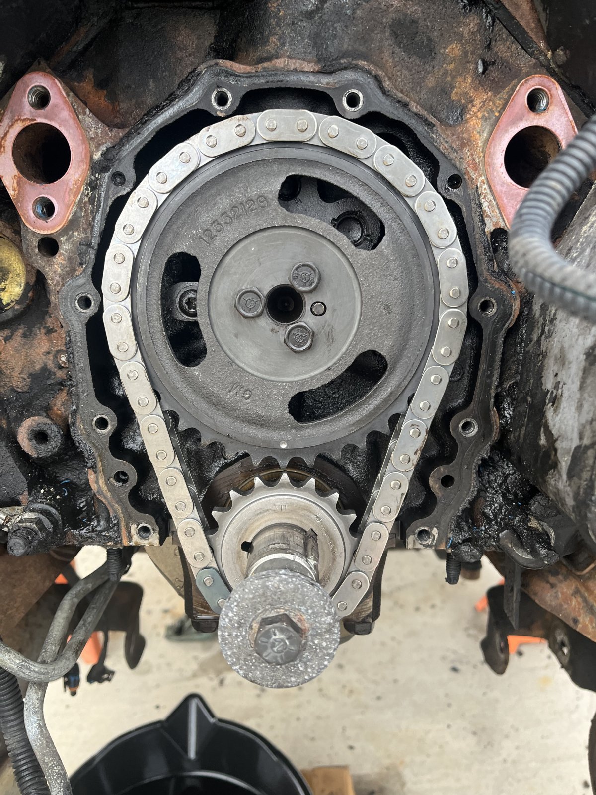

Update: got the axels out, and wrestled the front diff out, I took it out completely in prep for the Rough Country lift. Probably gong to send it to the shop to have 4:56 gears put in it. The I removed the oil pan and put it in the parts washer, probably going to have to wire wheel some parts of the outside and repaint.
I also picked up a new melling 155HV oil pump, shaft, and a cloyes timing set. I’ll take more pics tomorrow but here’s 1 for now

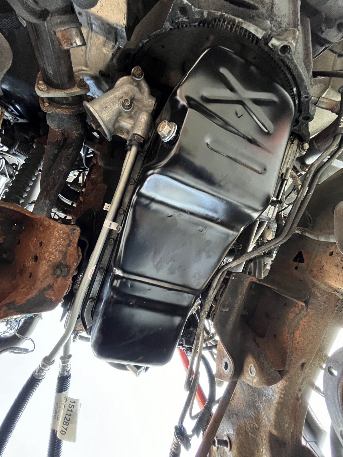

Got the oil pan back on, felpro gasket, got the oil cooler adapter on with new gaskets, also new GM oil lines. I also started to pull the power steering pulley, only to find that it’s leaking from the pump shaft, so I ordered a new BBB unit from rock auto.

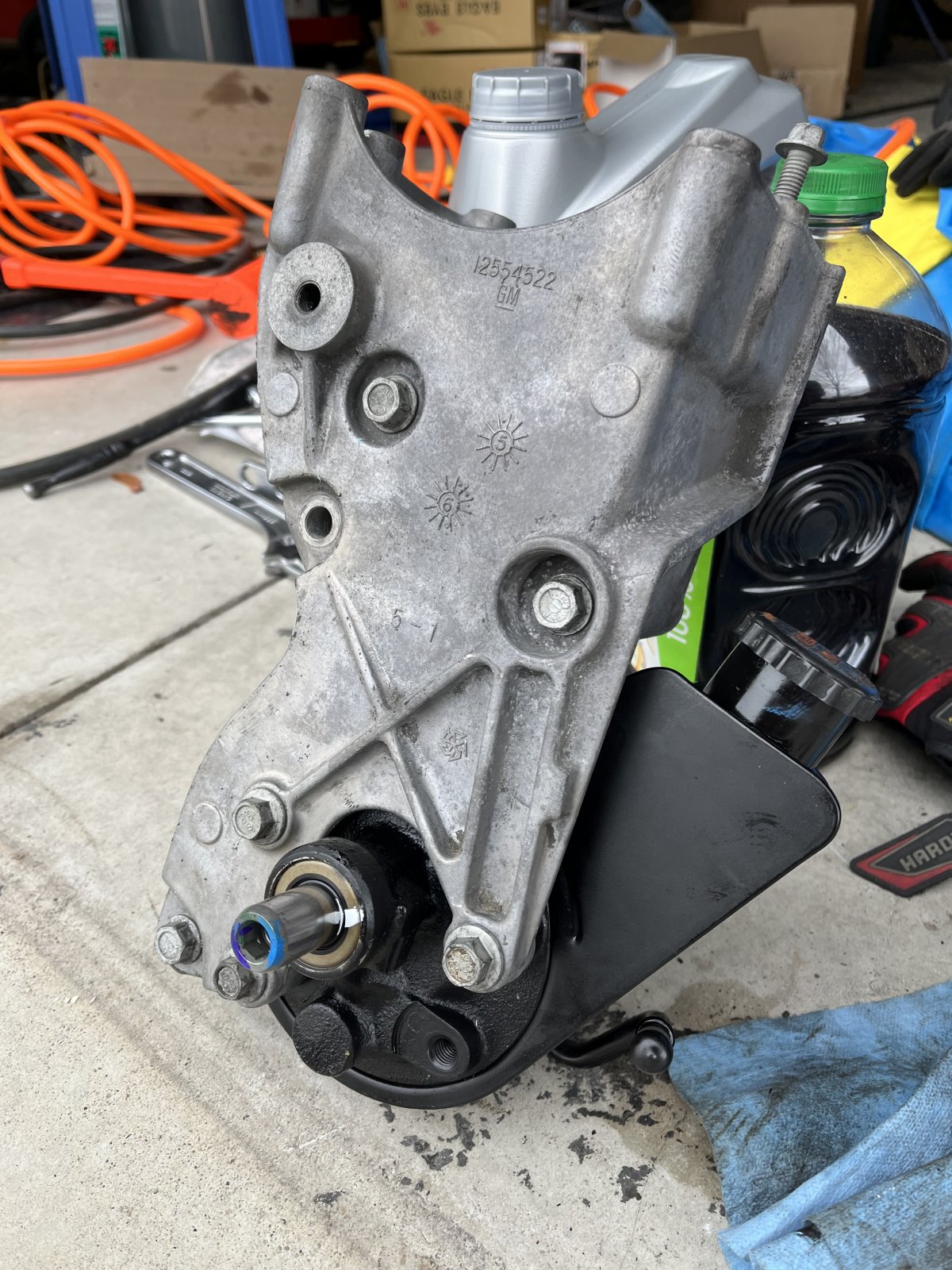

Had a decent day. Got the passenger inner fender well on, had to cut and modify the body/radiator mount a bit to make it level and even with the driver side, mocked up the radiator support. Then I got a delivery, my balancer installer came, got the balancer on, cleaned up the pulley and painted it.
I also received the new power steering pump, so I got that installed, as well as the new lines for it.

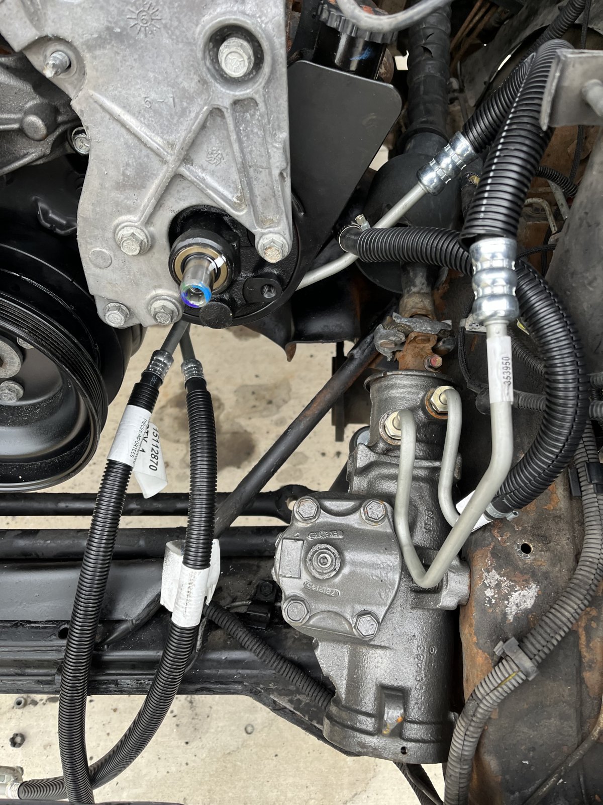

The update: so I got the power steering pump on, need to put the pulley on on, new lines are also in and attached to the new rebuilt 83 steering box unit.
I also got a new alternator, I picked a 140 amp that said would fit, there are 2 issues. #1 it’s a square plug, can I convert my plug to this square plug? Issue #2, it’s not quite fitting due to the small metal hose for the heater core, any ideas on that?
