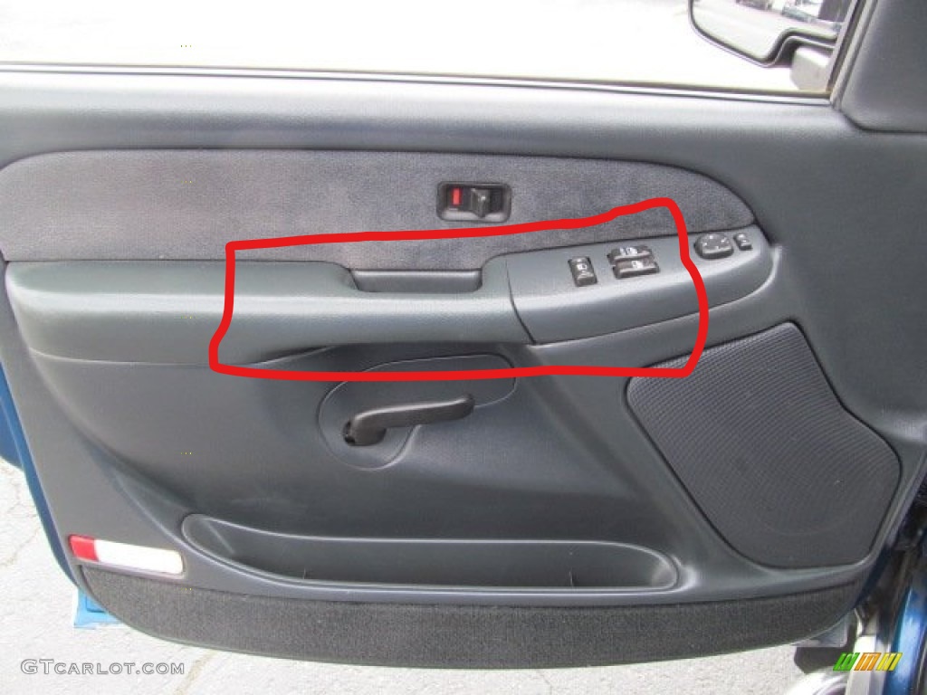

I have search high and low all over the internet and maybe I’m just not good at wording things but I’m looking for some kind of fix for the interior door grab handle. Not the Oh S*** handle above and not the handle to open the door the one right behind the window and door lock controls. Over time from grabbing it to shut the door it’s falling off.
Has anyone came up with a fix for this instead of replacement? Much appreciated folks

Just so were clear, you are talking about this?

Yes!! That’s the handle

There are 3 and 1/2 thousand youtube videos on door panel removal. Have you ever taken it off (probably for speaker install)? There is a bolt at the bottom, that might not have gotten reinstalled? The switches pop right out. I don't recall how the handle is attached without looking, but a little flat head for the lock, switches, and door open handle, then a 7mm socket will get the door panel off in a minute. I want to say there are bendable tabs for it.
Could try lubricating the hinges, to make sure its as easy as possible.

for as much as that arm rest will cost you, you can get a complete used door panel at your junk yard or ebay or lkq

On my old door panels I put a quarter inch bolts and nuts through the front part into the door panel and it was there for years until I swapped panels but you can actually Unbolt the armrest from the back of the door panel with like four or five 7mm Bolts. Here in Arizona it’s hard to find an armrest that’s worth a damn they all start peling up

The best place that I have found them is on offer up anywhere from $20-$60 if you can’t find one let me know what color you need and what year because 99 through 02 and 03 through six are different. 99 through to the window and door locks which is pops off the door panel from the front 03 through six have to pull the door panel off and unplug that little switch panel from the bottom side. I learned that the hard way and broke a panel In an armrest trying to pull the switch is off from the outside. My dad owns a repair shop here And him and my brother run it. Do you do a lot of work on that body style ship with all the work trucks they do and believe it or not When I was talking to both of them about the way the door panel comes off they had no idea even because they haven’t had to take any off from a 03-06 not even to change a single window regulator yet. 99-02 yes. If you need more help just shoot me a message
