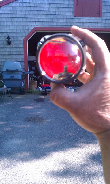

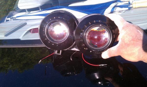

More tinkering today. I decided to try painting the cutoff shields
picture.php
Lights disassembled
picture.php
Painted cutoffs
Reassembled
Mounted on housing with shrouds

Thanks. I still got to Check alignment of lights, Fitting back into teh housings and not to mention, Resealing them.

Looking great sumo ... love the red.
Man you are really steaming through this mod. I just handed in my housings today to the dude that's doing them. Hoping to have them on the truck next Saturday.
