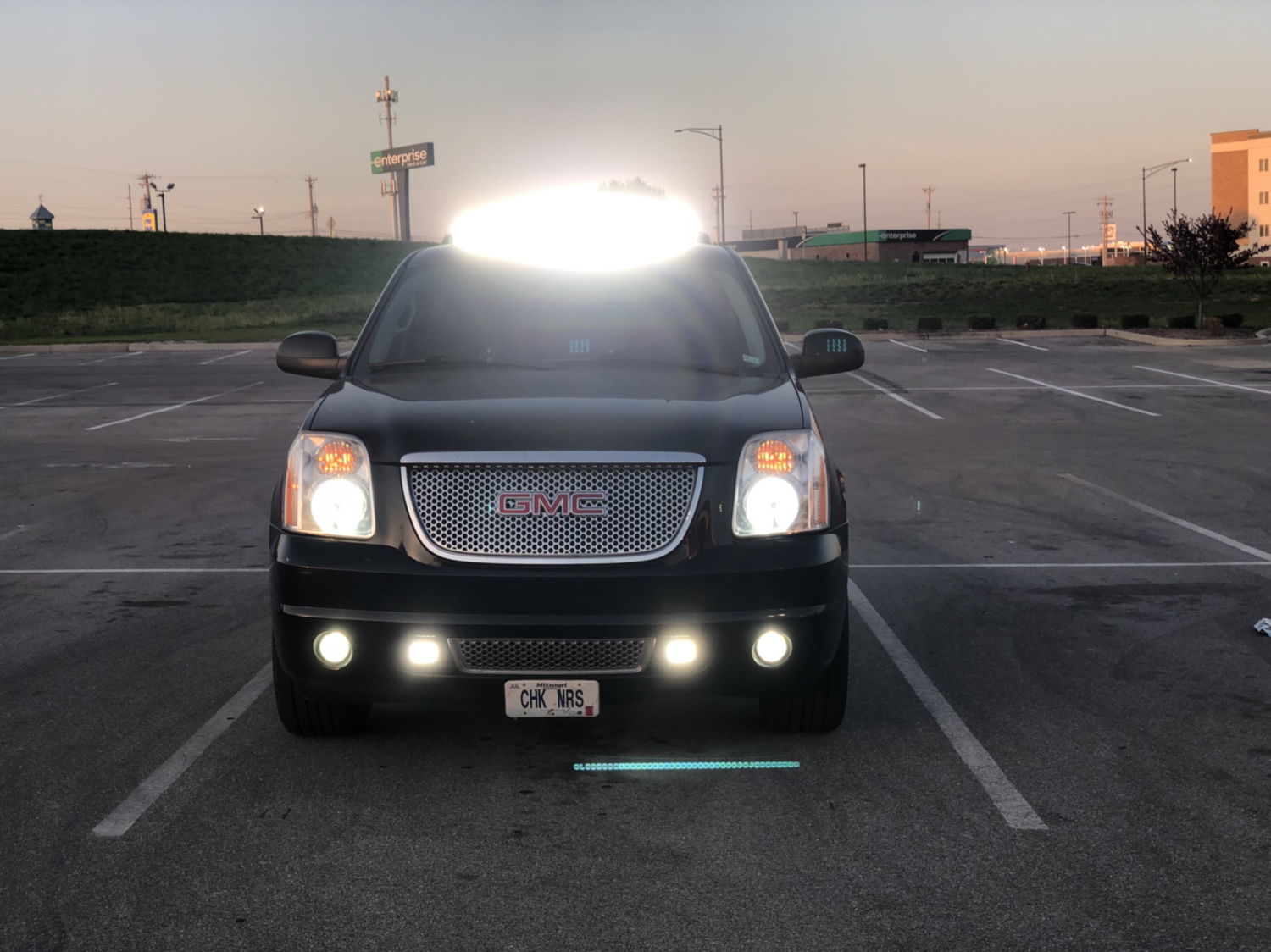

Here are 2 night shots. It is too bright to get a good shot with my phone.
It is aimed really bad right now. Beam hits the road about 30 feet in front of the car. I didn’t have anything with me last night to adjust it. I will try to get some better night shots tonight after it is adjusted. In person though it is super bright.

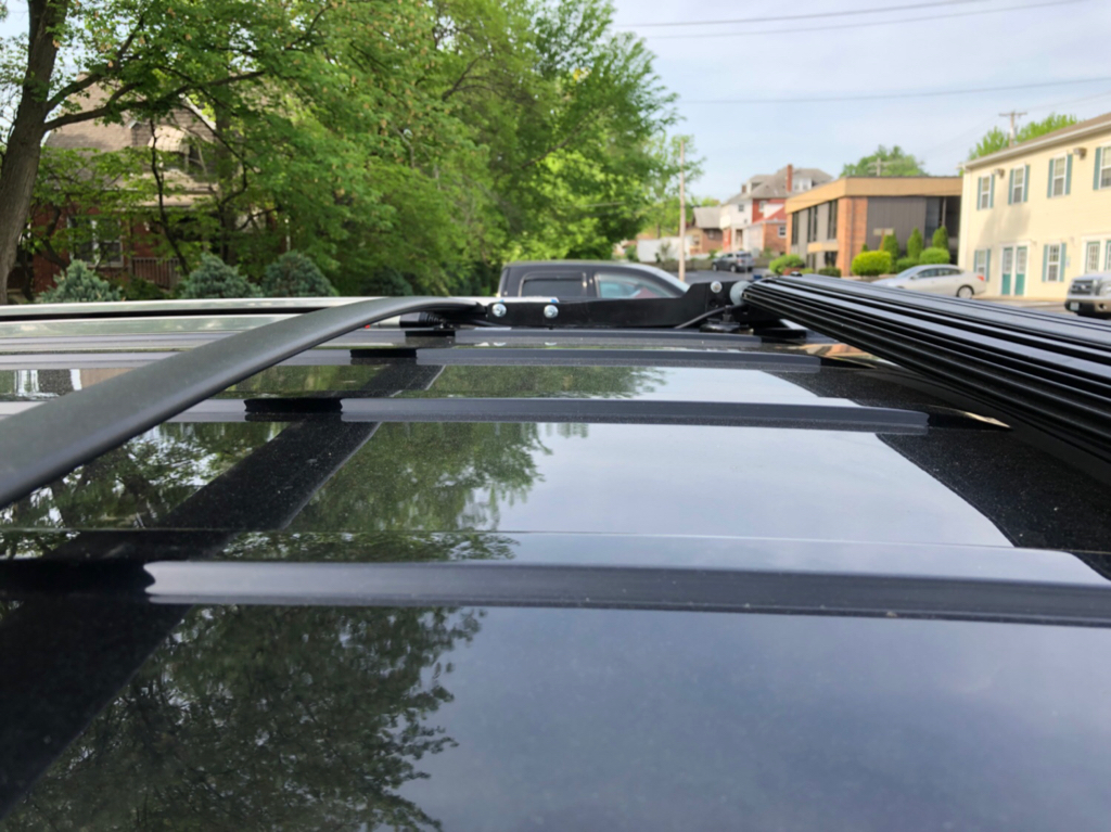

Here is the quick fix I came up with. I used a bracket I had and a 250lb pull magnet. I have 2 of these and 2 brackets already. Just put one screw in it for a test run. I am sure it will work since I can’t force it to move up or down anymore. If it does work fine I will add the one to the other side. I will paint all the hardware Black to blend in.
Yes that is black duct tape under the magnet. it is not there to prevent scratches to the paint as you Might think. It is there because all good jobs need some duct tape. :)

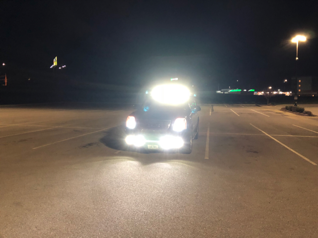

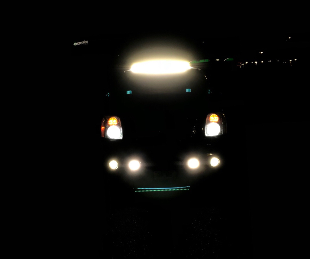

Here are a few night shots after I aimed it better. Might need to tweak it some more.
Low beams
High beams with fogs
Low beams and roof light bar.
Roof light bar only.
Cant say how far away this is, but between 1/4 and 1/2 mile.
This one is hard to see, but the reflectors are a little more than 6/10 of a mile.

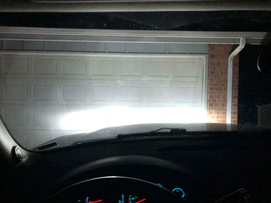

Headlights on garage.
With light bar.

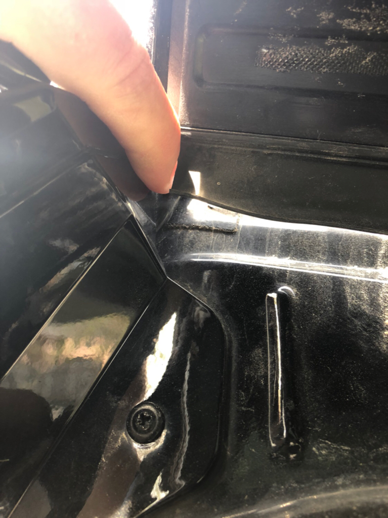

Here is the pic of the wire coming up through the back of the car. This is the only place you can see it in the hatch area.
I have the wire running in the roof rail track on top, but there is a few inches where it can be seen. I may notch out the trim and run it right under the plastic.

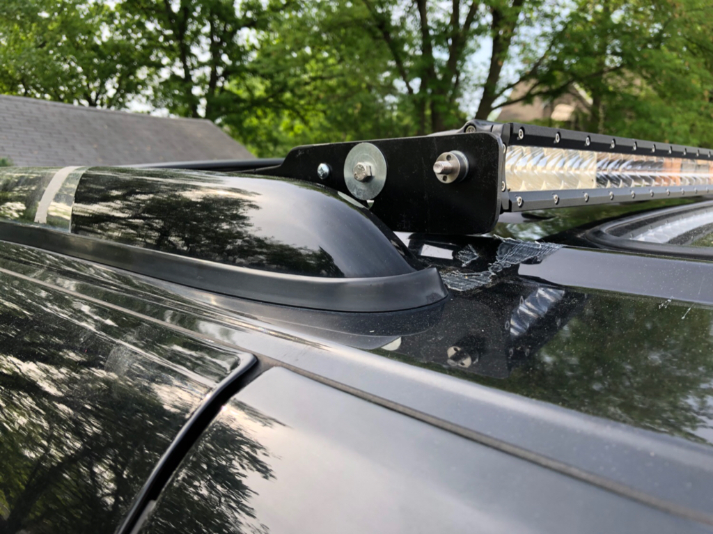

Here are a few pictures after the bracket was painted and shaped. I still need to paint the hardware, just fitting it back up.
I have my kydex too and am going to try to mold a cover. If I don’t get anything I am happy with, some of the hardware will change to countersink screws ect. Not worried about that yet since I hope to cover it all anyway.
A close up view.
This one shows what you see from eye level at 6’3”
This is looking across the roof at the bracket on the far side.

Looks good. Definitely hide that hardware. Use a washer too? Different metals, corroding?
