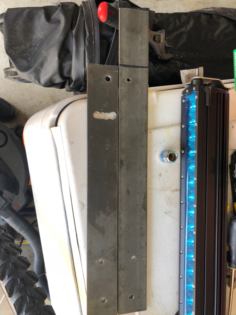

Ok I have made some progress. Here are the 2 brackets. Not finished but most of the holes drilled.
Still need to round off those corners and trim the top. Going to make it close to the cardboard shown here.

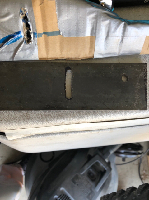

Drilling some holes for the adjustment slot.
I didn’t make the slot quite big enough for the screw so I will have to make it a little bigger.

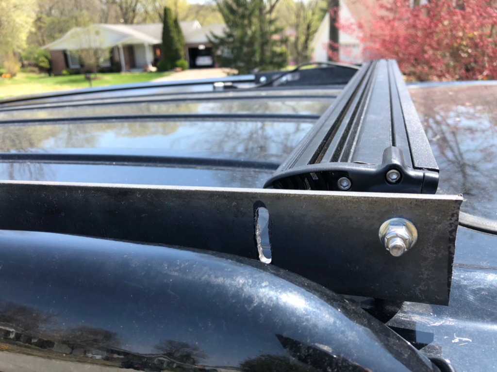

Here it is for a test fit on the Yukon.
And some of the mounting hardware and fitment.
I still have to run the wiring and shape the brackets. After I get the shape I want I will either send them off for powered coating or paint them. It is solid though. And I didn’t get any noticeable noice, though I haven’t got to drive over 45mph yet. I will post more as I get more done.

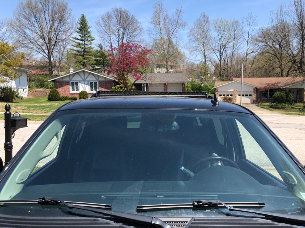

Good news. Drove 75mph for 20 mins with no detectable noises.
Bad news. Drove on a rough road and had some vibrations from up and down movement. With the light forward this far it puts a lot of leverage on the roof rail. Enough to let the roof rail flex and cause a noise. I have already came up with a fix for this, I will test fit it and take more pictures.
