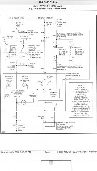

Here's what I found with Mitchel On Demand...
http://69.60.238.10/ira/Doc.pdf
Hope this helps!

i did find how to wire this mirror up. i got the mirror in today but
i still need to hook the grn wire to the reverse wire .
so adding up the cost for the mirror the wires,wireloom,
connectors $15.00 not bad and the mirror works

Anyway, enough rambling, I remembered seeing mirrors in the wiring diagram section of MOD, so I went back in, looked it up, printed it up, scanned it then posted it. Simple.

i got the grn wire hook to the reverse light wire. i got lucky to find this in the junk yard i went today and all of them
gone . the temp is off 2 degress off compared to the weather
channel.
