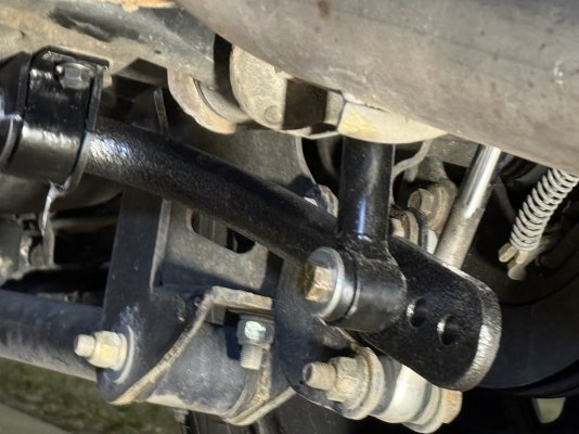

Hellwig bars installed!
The weight difference is astounding. I literally threw my rear bar out from under the truck with one arm. It took me both arms and grunting to get the Hellwig installed
This 5500 lb truck handles HILARIOUSLY well now. Body roll is 99% eliminated. I took my normal exit for work, which is a 180° loop back, without turning my cruise control off—set at 70 mph. I’m not saying it wasn’t a little sketchy, but the truck did it.
All in all, I can’t believe I didn’t do this before now.
OH! And set at max stiffness, I was able to use Hellwig’s BEEFY endlink setup in the stock configuration, without any contacting the trac-bar.
The endlinks are about an inch too long, so I’ll be machining down both the male and female ends to resolve that problem.
Stay tuned!
