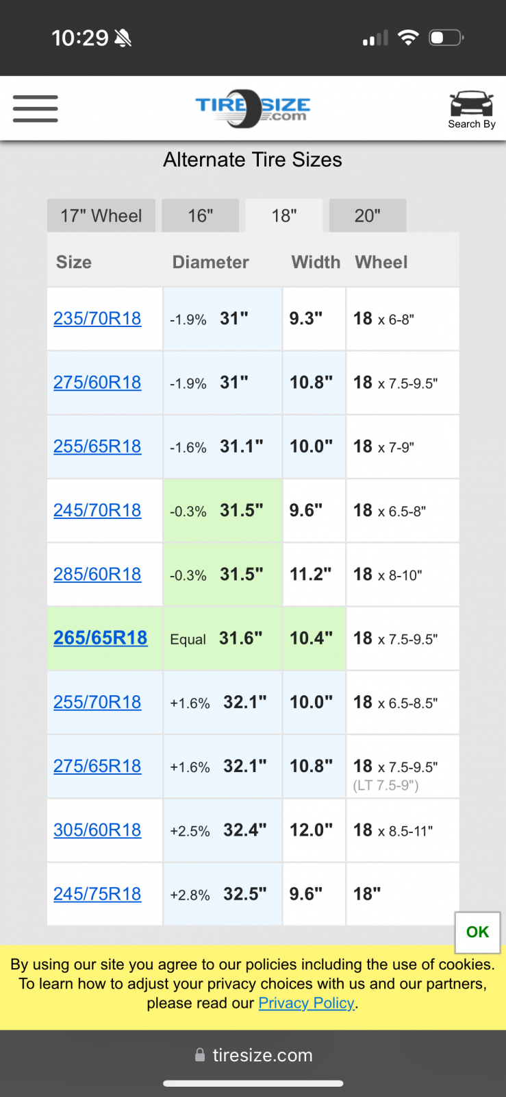

If you haven't used it, this site will let you compare the relative sizes: https://tiresize.com/comparison/
Thank you. That’s how I figured out which 18 inch size was identical dimensionally to the 17 inch size. The question i’m pondering over is if I go up slightly in size, will I have any rubbing on the wheelwells? Ordinarily, there would be many other people who have answered this question, but these 3500s are so rare that I haven’t found anyone who’s done it yet.

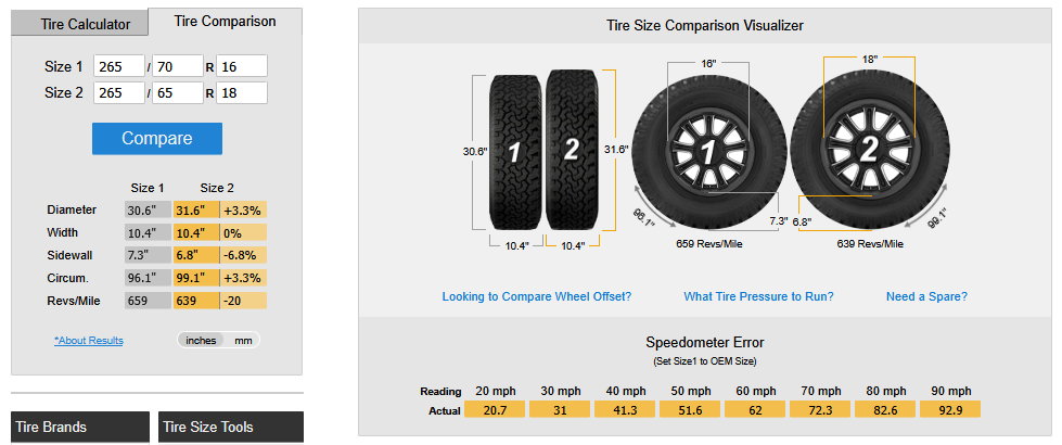

I'm running 2015 Silverado 18x8.5" wheels with the 265/65-18s in an AT format (obviously, with nothing else available in that size), and they're perhaps 1/2" taller (radius) than my OE 16x7s were with the OE-sized tires. Of course the wheelwell on mine is different from yours, but I don't think you'd have any trouble with one size wider (with the same aspect ratio: 65) if you have decent clearance now.
Here's how my comparison looks. In reality my tires ended up being a little less than 1" overall in diameter.
Most cars I've had the tires up-sized one level when they needed new tires and never had a problem. Messes a little with the speedometer but not by more than 1 mph or so. Speedometers generally read a little low from the factory.

That’s helpful, Steve. Thank you. 275/65/18 would be another half an inch in diameter and half an inch wider, and brings with it many more options, including the Michelin Defender LTX and the Continental Terrain Contact. I think I’ll go that route and drive around the parking lot before I leave the shop.
