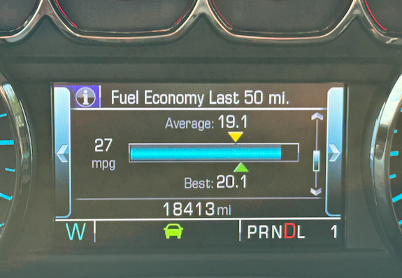

Hard to say on the mpg because we only use it for towing our camper. The rest of the time it just sits in the garage with a battery maintainer being driven every 2 weeks or so to keep everything moving and happy. That said, when I drove home from where I bought it in Maryland, it was mostly highway (I-95) and I averaged 19 doing the speed limit (no license plates, didn't want to draw any unwanted attention besides looking like secret service :p)

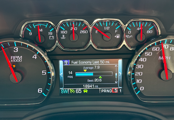

When towing our 7500 lb camper, I'm averaging between 8-9 on the flats, and 7-8 in the hills. This picture was taken after driving through the mountains of NC last Labor Day with 5 people + dog + camper. Note that the gas gauge flaked out and went to E for about 200 miles, but the fuel mileage kept computing normally so I had plenty left when I stopped for gas. Hasn't flaked out before or since:

Oddly enough, my truck did the same thing with the gas gauge recently. Then as quick as it stopped working it came back to life?

Huh. Wonder if the 1500 Suburbans have a flaky gas gauge from time to time or if it’s something unique to the 3500. We stopped at a rest area while the gauge wasn’t working, and I shut it off and restarted it but it didn’t fix it. What fixed it was stopping for gas and leaving it shut off for 15 minutes while we got some food in the store afterwards. Fired it back up and the gauge was back to normal and hasn’t flaked since.

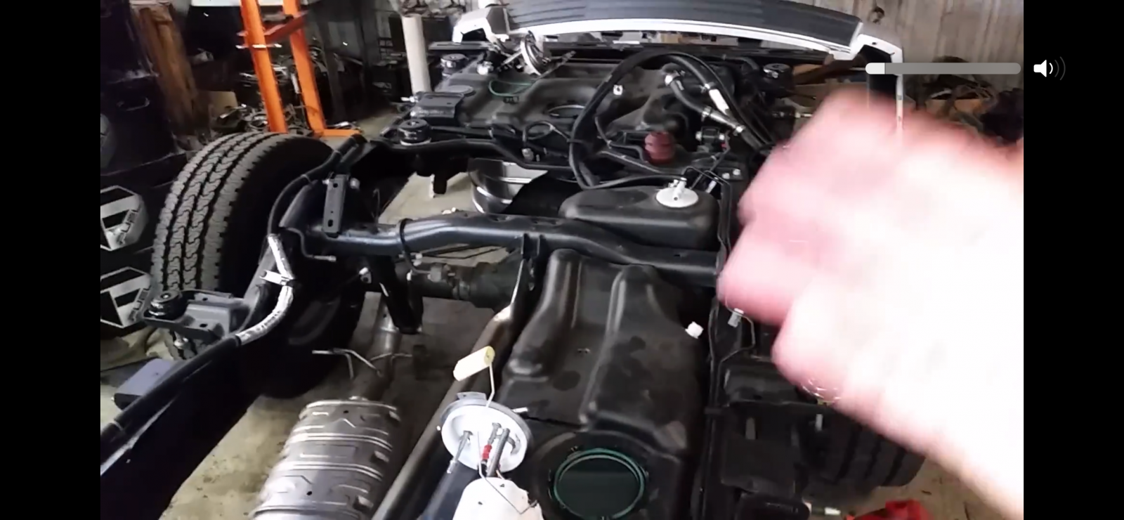

I may be hallucinating but do these have dual tanks? I thought I recently read about a second fuel level sensor in the second tank that could affect this.

They do indeed have dual tanks - pretty much the same setup as the GMT900 2500 SUVs. I had a similar thought but since it only happened once, I haven't been too motivated to try to figure it out. That said, I will put some time into it anyway - if for no other reason than to figure out a reliable workaround when I experience it.

I wonder if there's a way to monitor both fuel tank levels via PIDs with a scanner. Maybe graph them over time to see if there are glitches or other weirdness (technically speaking...)

Picture is a snip from Duraburb’s YouTube video and you can see the split tanks here.
Interesting thought, would be cool if we could flip between front/back tanks like the old Fords with dual tanks.

Part of the beauty of the dual tank system that we have is that all of the fuel transfer is automatic. But I can also see the value of having a reserve tank to switch to… Especially when pulling a camper.
