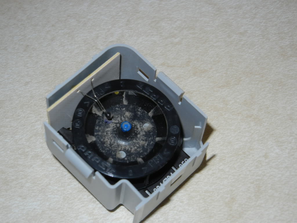

Anyways, if you pull the liner down, you can unplug the beast. Once you have the part in your hand, you'll probably notice grime on it. Spin it w/ your finger, and you'll hear it sound like a fan that is going bad.
Bend the little dohickey that's hitting the grime up about 1/4" and spin it again.
Abracadabra, that's all I had to do to mine. Nice and quiet again.
