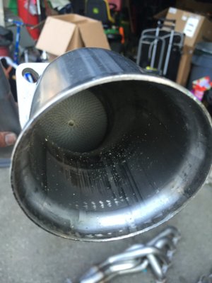

American Racing. These are absolutely beastly. The sound it gives my truck and believe it or not, I am running oem piping cat back system. I did the resonator delete, welded in a magnaflow muffler. I run their 1 7/8 header with a catted y section, but honestly, it looks like a bump in the piping. I chose to use cats because I use it to haul family. I have a rich tune to compensate for my blower so I still get a strong exhaust smell when I get on it.
View attachment 204873 View attachment 204874
Do you have a video of how your truck sounds after the ARH install?
