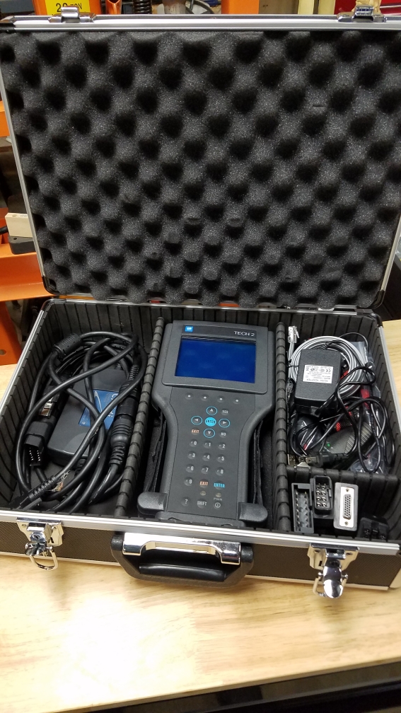

I picked up a 18x13 Voyager case from Harbor Freight. It has the pluck foam or dividers. I used dividers. About $20 using the 20% off coupon.

Perfect fit!

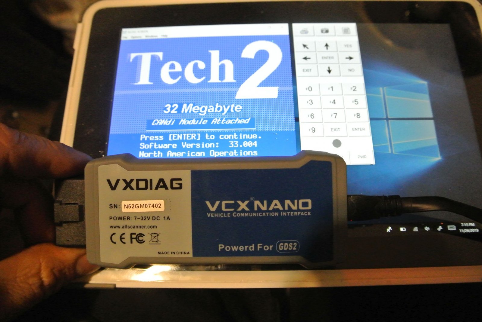

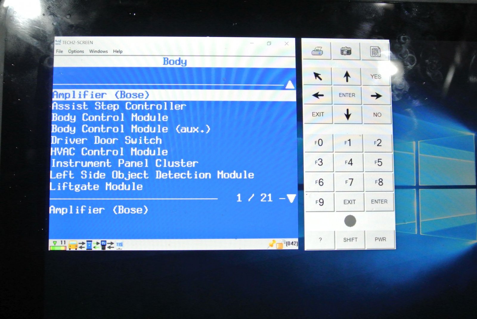

you can also save a few bucks and pick up a vxdiag it does most of the same functions as a tech2, they run about $135, it's been an experience getting the software to work but it functions as a tech2 ok. I almost have it doing gds2 also I can get the gds2 software to run in a virtual machine but it wont detect the device, the ebay seller has been pretty helpful so far were still working on it.
View attachment 234942 View attachment 234943
What’s the downside to this as opposed to the tech2 ?
What can’t it do that the tech2 can?
i'm not sure exactly but I think it's very little difference if anything it was just something I read and there were no specifics given
It needs a windows laptop correct.

tablet or laptop would be the best option, it can run a pc also but wouldn't be very convenient
The tech 2 is a better option for me then. I have a MacBook. I’d have to buy a separate windows laptop or tablet.
