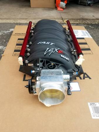

Check this out:
https://newyork.craigslist.org/lgi/pts/d/west-hempstead-fast-lsxr-102mm-intake/7130166359.html

Thanks for the link but I’m likely going to stay with the Trailblazer SS intake and the drive by wire setup. I’m just going to look at whether the stock truck TB will work well enough for my engine setup as opposed to the Trailblazer SS 4 bolt throttle body.
