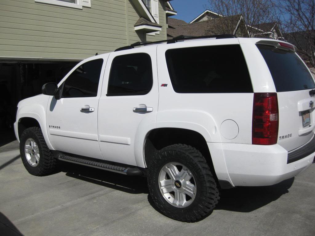

tahoe z71 with leveling kit and stock wheels with 285s? pics please
Zed 71
Sep 30, 2009
1,229
12
Pacific NW
That is not bad at all. What size tires did you end up going with? Since I have the LTZ rims (20") I don't know if I should stick with the 285's or go with the 295's....:shrug:
Depends if you offroad and how much trimming you are willing to do. I flex the suspension and had to trim ~2 inches from the from bumper valence.

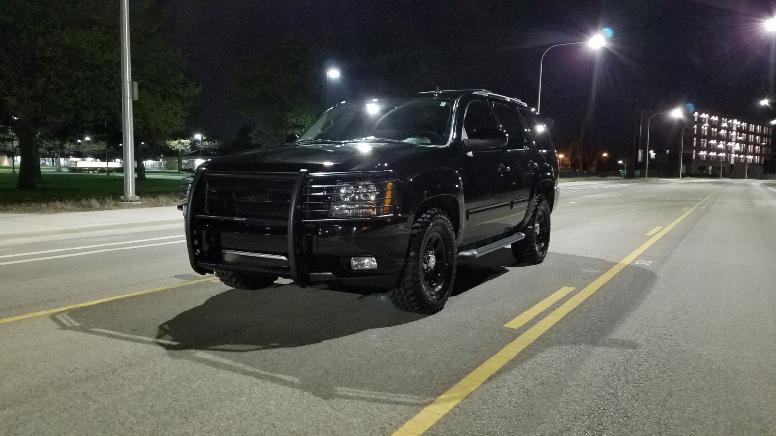

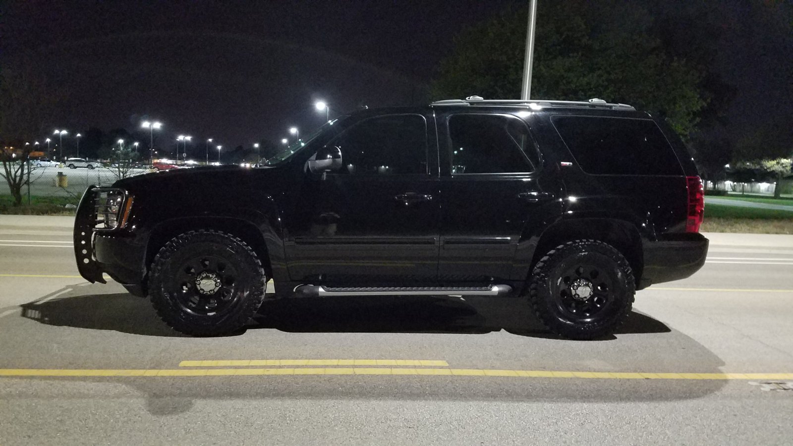

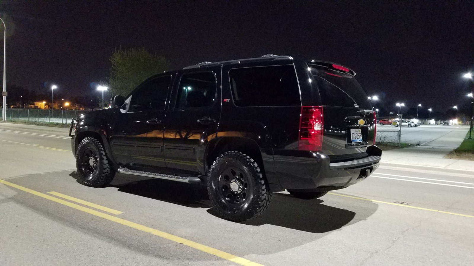

20180507_024820-jpg.198896
20180507_024811-jpg.198897
20180507_024729-jpg.198898
20180507_024721-jpg.198899
20180507_024654-jpg.198900
img_20180506_104156_908-jpg.198901
mine isn't leveled but its a 285-70-17 on firestone destination MT tires

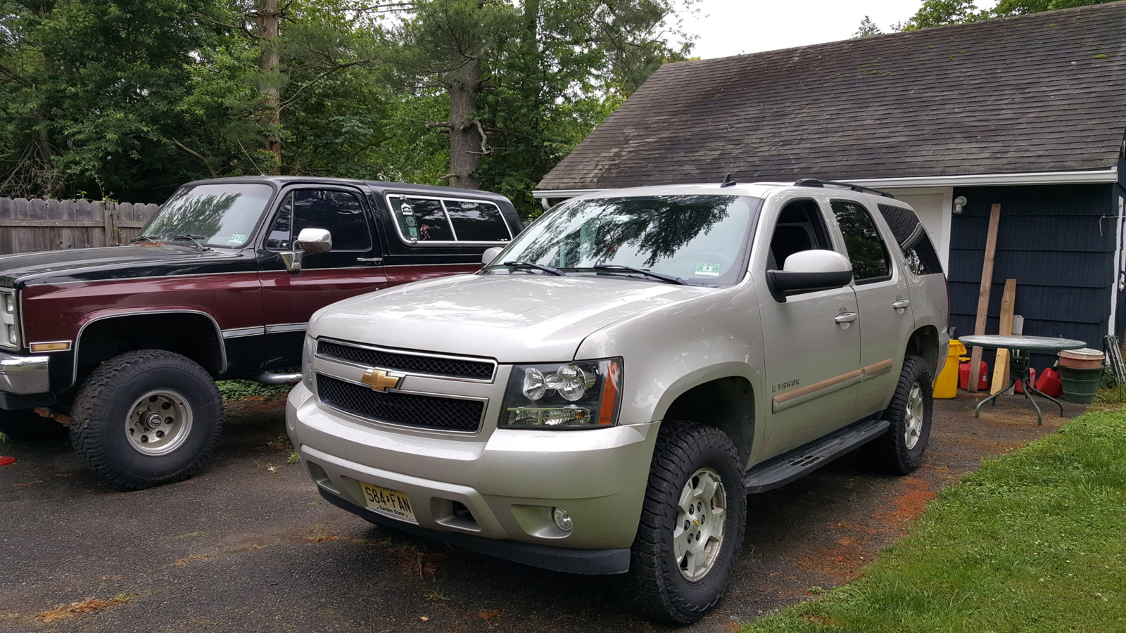

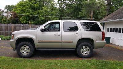

2007 Tahoe 2.5 front and 1 inch rear CCM Level. On P285/70R17 Falken Wild Peaks AT3 and stock wheels 20180610_185045.jpg
