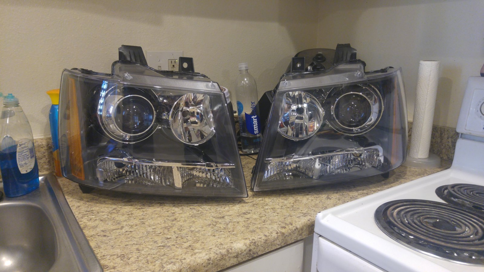

Ordered my well-illuminated future from Retrofit over the weekend, with D2S 4.0 bi-xenon as well. Can't wait to get it all installed. Thanks for the help again. :drunk:
You will enjoy the d2s 4.0! Be prepared to dremel the stock socket out. And have fun baking those suckers!

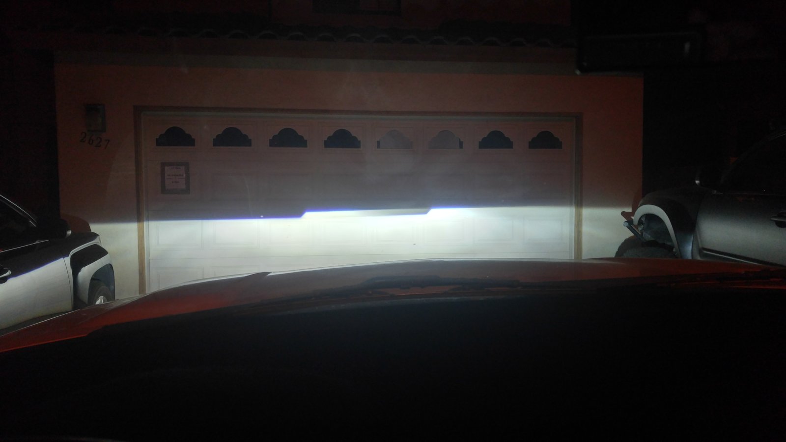

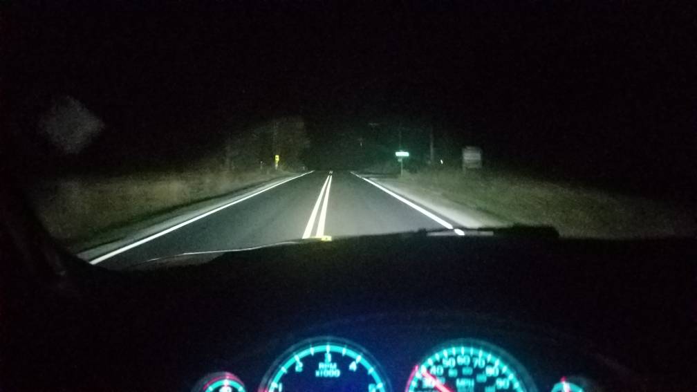

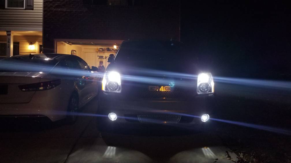

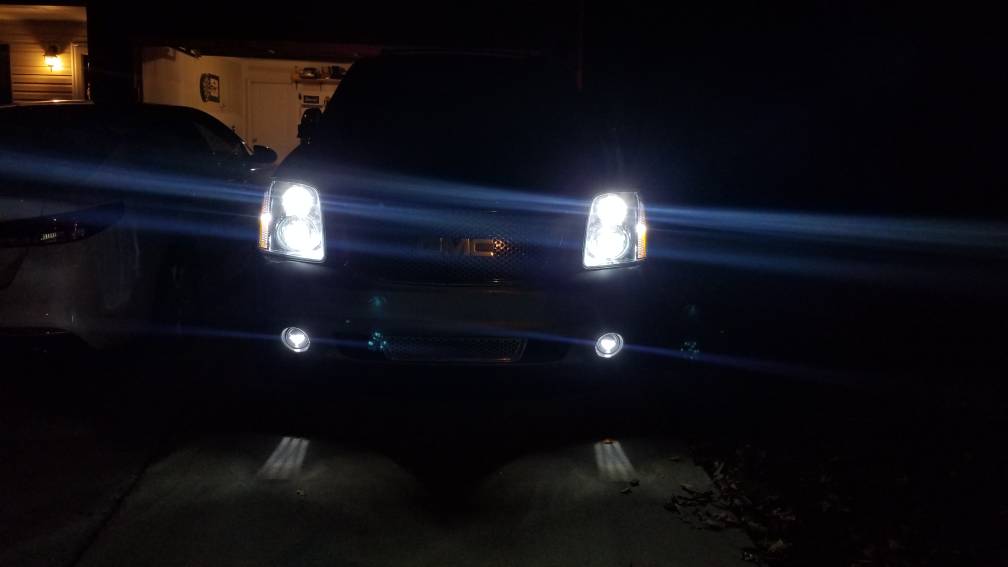

Low and Hi beam shots from this evening from.the D2S 4.0

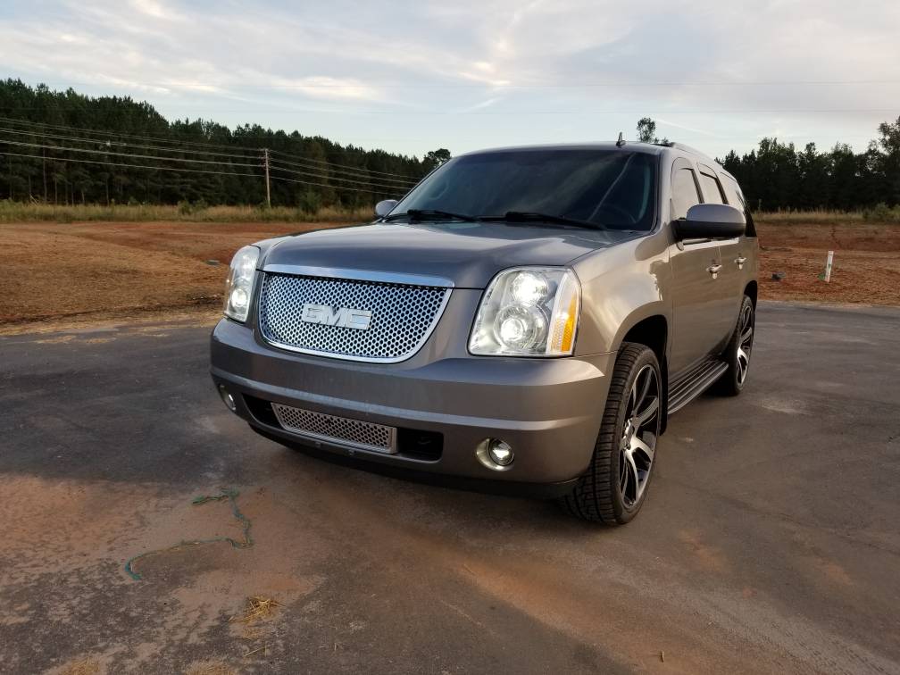

I have a question about the stock headlamps for the 07-14 Yukons.
I have been searching for days on the right place to ask this question since I couldn't find my answer.
I have a 2014 Yukon Denali and I was going to purchase a set of ebay headlamps (Don't worry I changed my mind) and when I went to possibly order them they said they would fit a 2014 Yukon SLT but would not fit a 2014 Yukon Denali??? I figured it was just some moron selling products they had no clue about.
Im going to buy a retrofit projector set from someone but my question is...
Are the headlamps different at all between the 07-14 Yukon and Yukon Denali?
I know its a dumb question but I just want to be sure all of this generation of headlamp fit between each other and that there were no major differences?
I know that I read somewhere that the Denali headlamp looks slightly different inside the lamp or something?
Im asking about the sizing though and spacing of the back of all of the headlamps.
I want to be sure that this used retrofit from a few years back still fits the 2014 Yukon Denali.

Well let me start by saying I'm spoiled when it comes to HID because of my S2000 which till this day along with the LS430 projectors are the best HID projectors out there as far as beam pattern, cut-off and light output.
So as far as low beams for me it's HID (S2k Koito projector), LED/Halogen depending on the application. It'***** or miss. (This doesn't include OEM LED, can't beat that with an LED in a housing meant for halogen). And lastly OEM halogen.
Like you mentioned, turning ON/OFF HIDs is a HUGE No No due to possibly frying the ballast. We're talking 23,000 Volts at start up every time you turn them on... So for highbeams like on a Yukon I would defenitly do a Bi-Xenon set up.
Again I'm use to my S2k with the HID/Halogen set up from factory. I'm not a fan of two sets of HID set ups for both Low and High beam applications. I would probably test out an LED for the high beams on a vehicle with seperate lows and highs like my Tahoe or the S.
A set of RX350 Bi-Xenons would be nice or Bi-LED Koito or Osram would nice to or some OEM Bosch E46 BMW Bi-Xenon projectors.

People convert the LS460s to bi-xenon, so if the space is available, that is an option. I wanted a quick retro in my nnbs, so I went with the d2s 4.0, switchbacks and morimoto xb LEDs for the fogs.
And the Denali headlights are different than the regular Yukon headlights. The inlay is silver instead of chrome.
