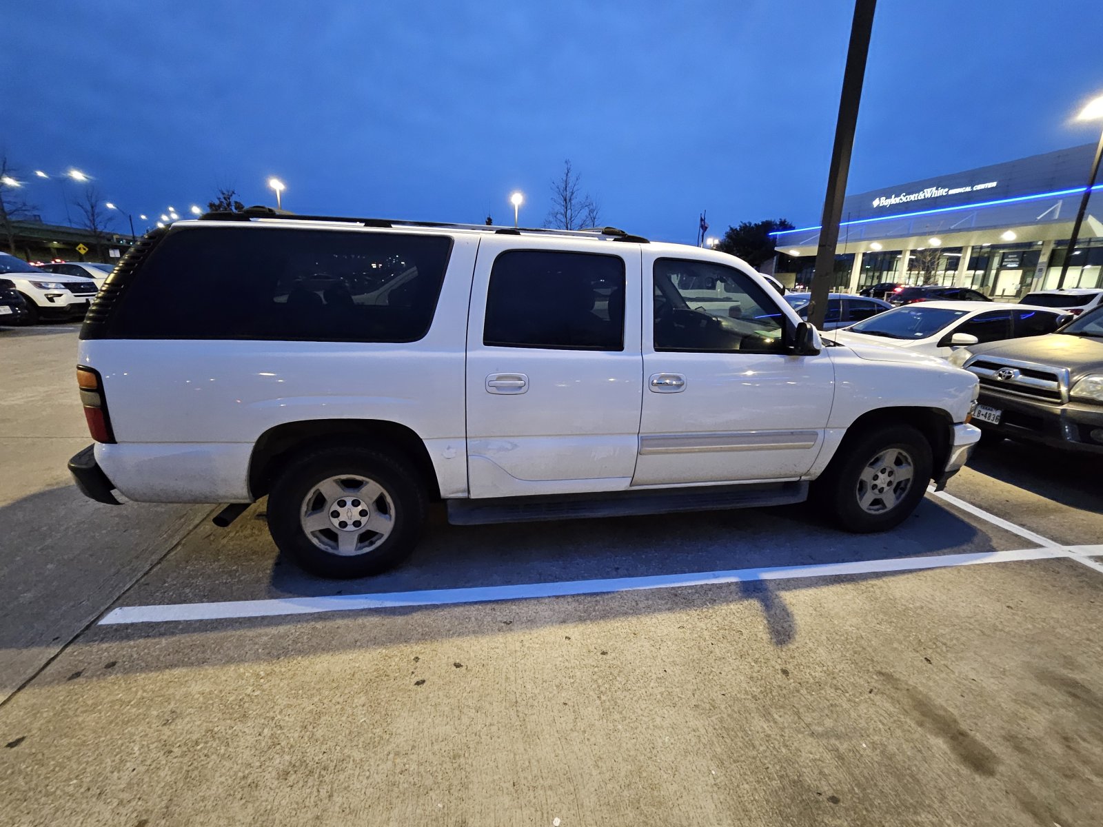

Tahoe rear doors will swap with Suburban rear doors, but make sure there is not body cladding. The body cladding on the Tahoe door on the Suburban body looks terrible.
This was before I was brave enough to swap window motors -- don't make too much fun of me, please. Two, functional doors with all pieces including the interior panels and switches, $100. Swapping the doors out? Less than 30 minutes per side, solo.
But you can see how awful the body-cladding looks for yourself.
Tahoe rear doors cut around the wheel well, they're not the same as Suburban. Tahoe and Yukon interchange, Suburban and Yukon XL interchange.

Tahoe rear doors will swap with Suburban rear doors ...
I'm sure one COULD put rear doors from a short-wheelbase Tahoe/Yukon/Escalade, on a long-wheelbase Suburban/XL/ESV ...
... COULD ... but WHY?
