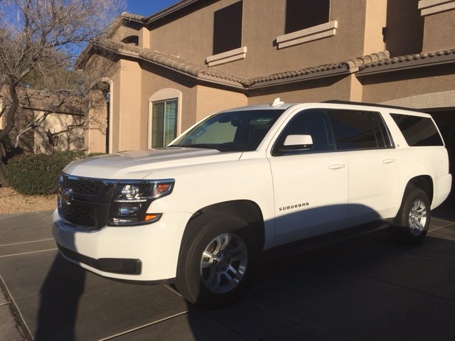

I just installed this on my lowered Suburban. Here is a comparison of the ground clearance from both deflectors.
Stock height and stock air deflector:
7 13/16in. Of clearance at the sides of the deflector. And 9 5/16in. of clearance at the center of the deflector.
Lowered height (2/3 drop) with PPV deflector. 11 11/16in. Of clearance at the sides. And 11 1/2 in. In the middle. It slopes slightly inward towards the middle.
Amazing how much clearance I GAINED with this even though I’m lowered. Win win !!!

We just finished putting on GM Part # 23365760
It is the Lower Deflector that comes on Tahoe PPV. it is about 1/4 of the length of the stock piece.
It's a small mod but I believe it has changed the look on our suburban quite a lot, we like it.
I got it at, for 281 plus shipping
https://www.gmpartso...lector-23365760
The main reason was to gain ground clearance, for these off-road times, like when parking at a mall to clear curbs
Also already helps on steep driveways and coming out of parking lots...
The removal of the old piece and installation of the new one was quite simple. Remove some bolts/ torque screws, pushing down some clip, partial removal of front wheels liners.
