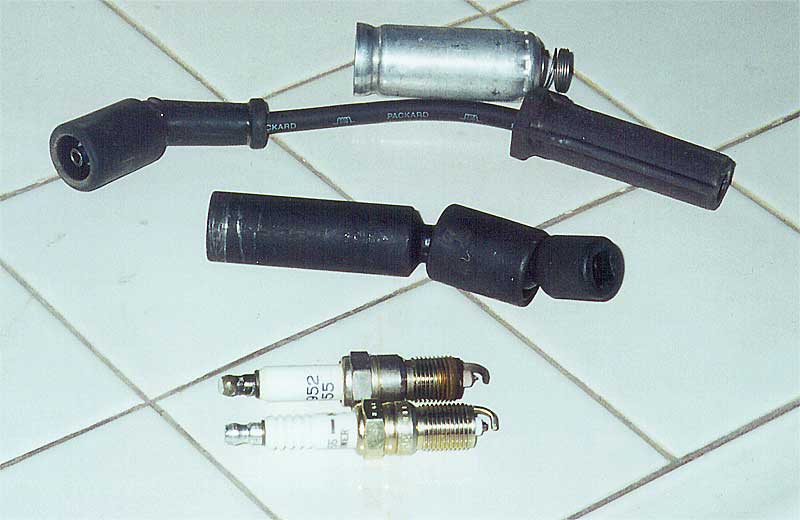

Only issue im having is according to the mechanic there was some arc from the wire causing the stumbling.. Could that be due to the spark wire heat sheild? are they nesissary to have on or could they be causing some of my spark arcing issue? Im still having the lack of power and a touch of rough idle but not bad at all.. just thought taking them off might help...
Below is a picture of the spark plug sheild.. its not my setup just a picture for refrence..

Heat shields are there for a reason. The arcing is because of weak wire insulation. The shield just provides a closer ground for it to jump to. Make sure you plugs and wires match. Use either delco or msd wires.
