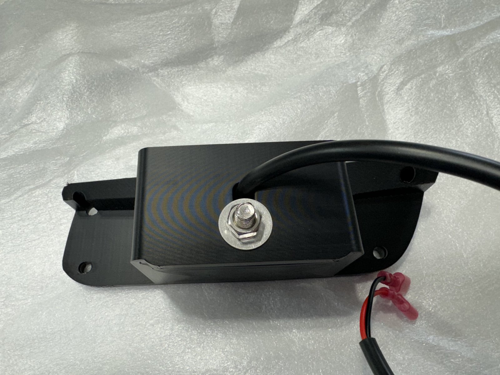

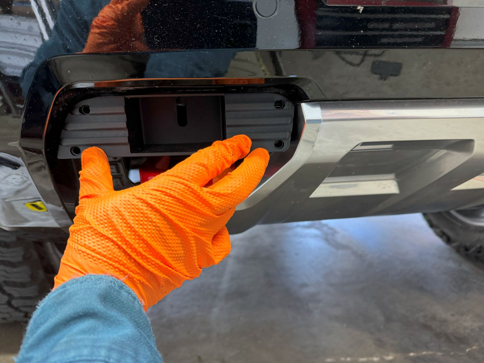

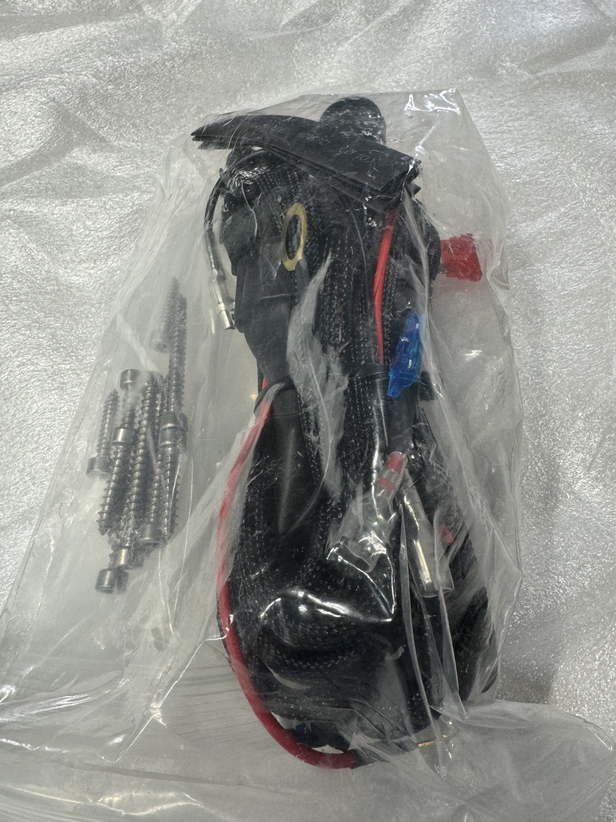

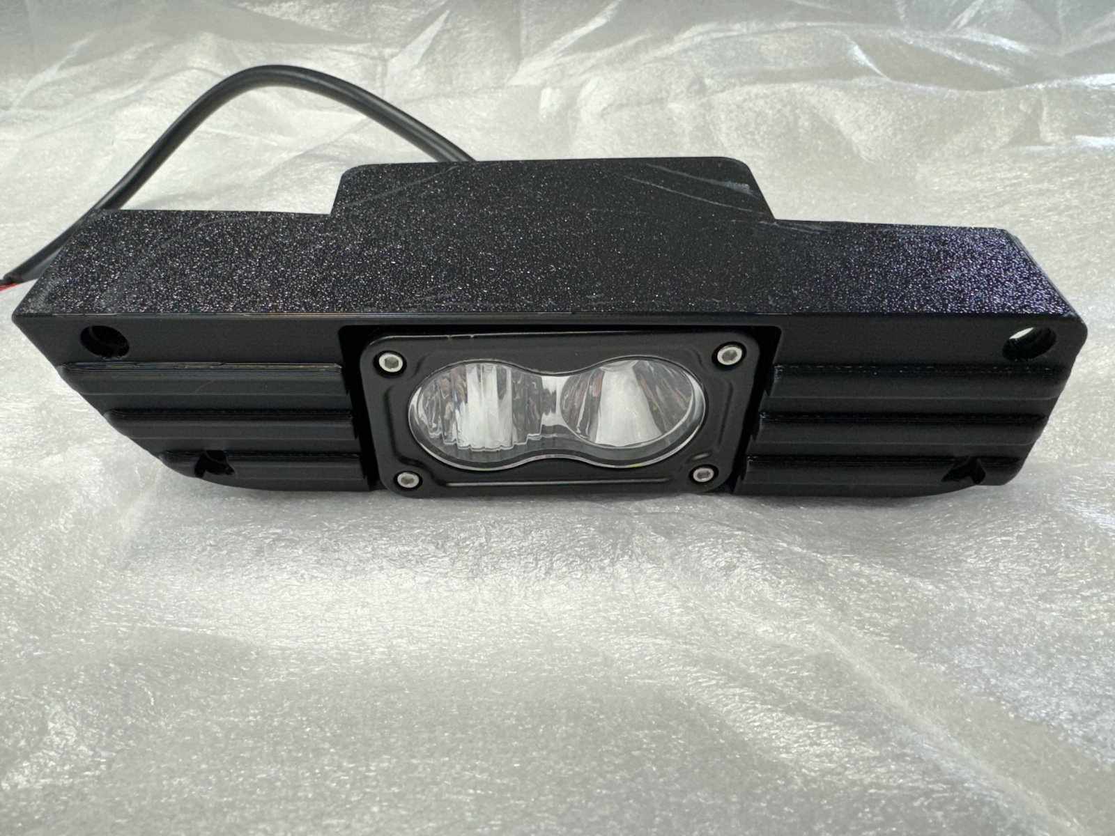

I got them Wednesday. Been traveling so haven’t had a chance to put them on or try them out.
Kpwweb
Dec 11, 2015
771
357

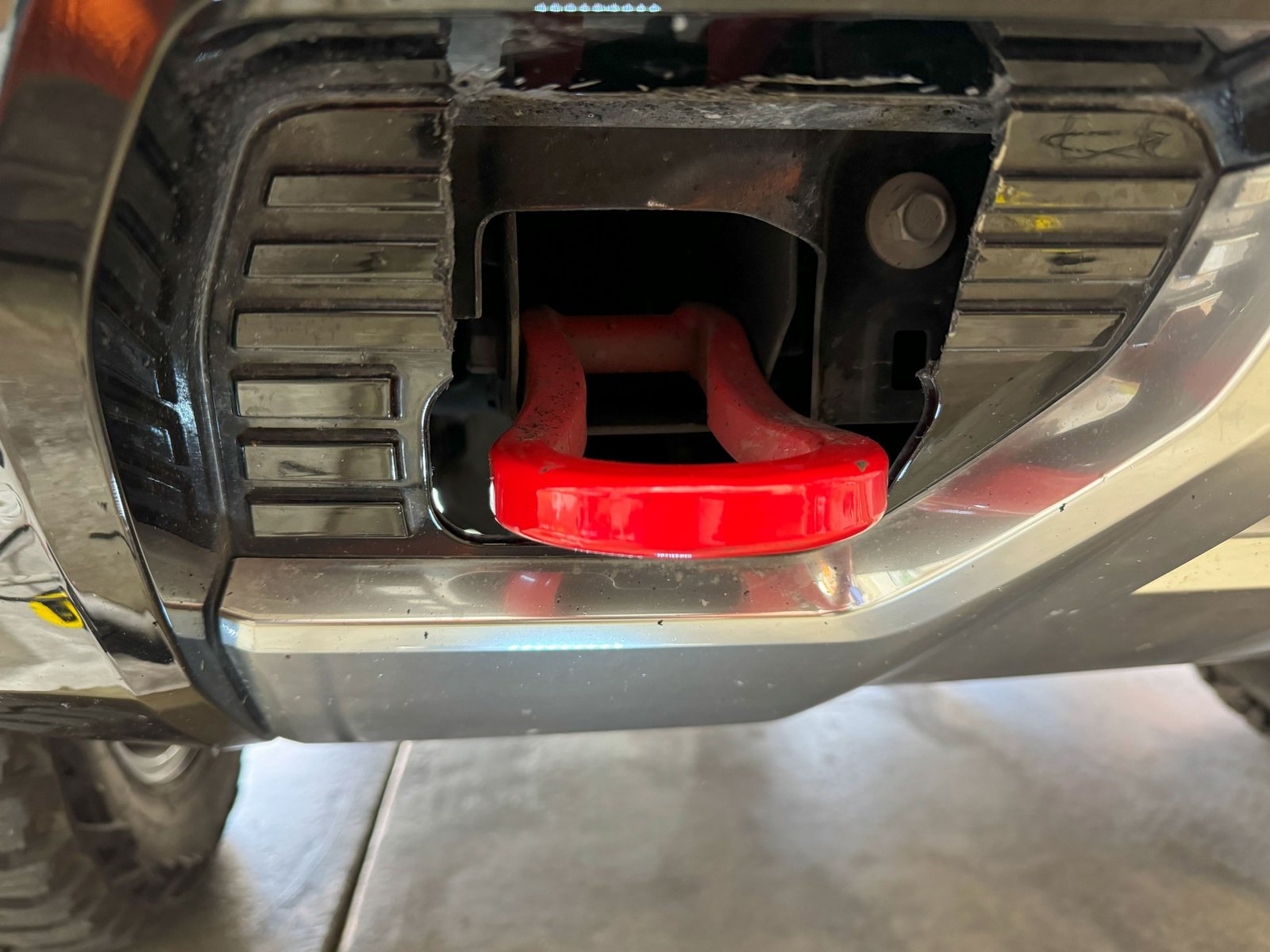

I installed the right side yesterday. I got the model that mounta above the recovery hooks, so cutting was required. See pics. Sorry for the long process.

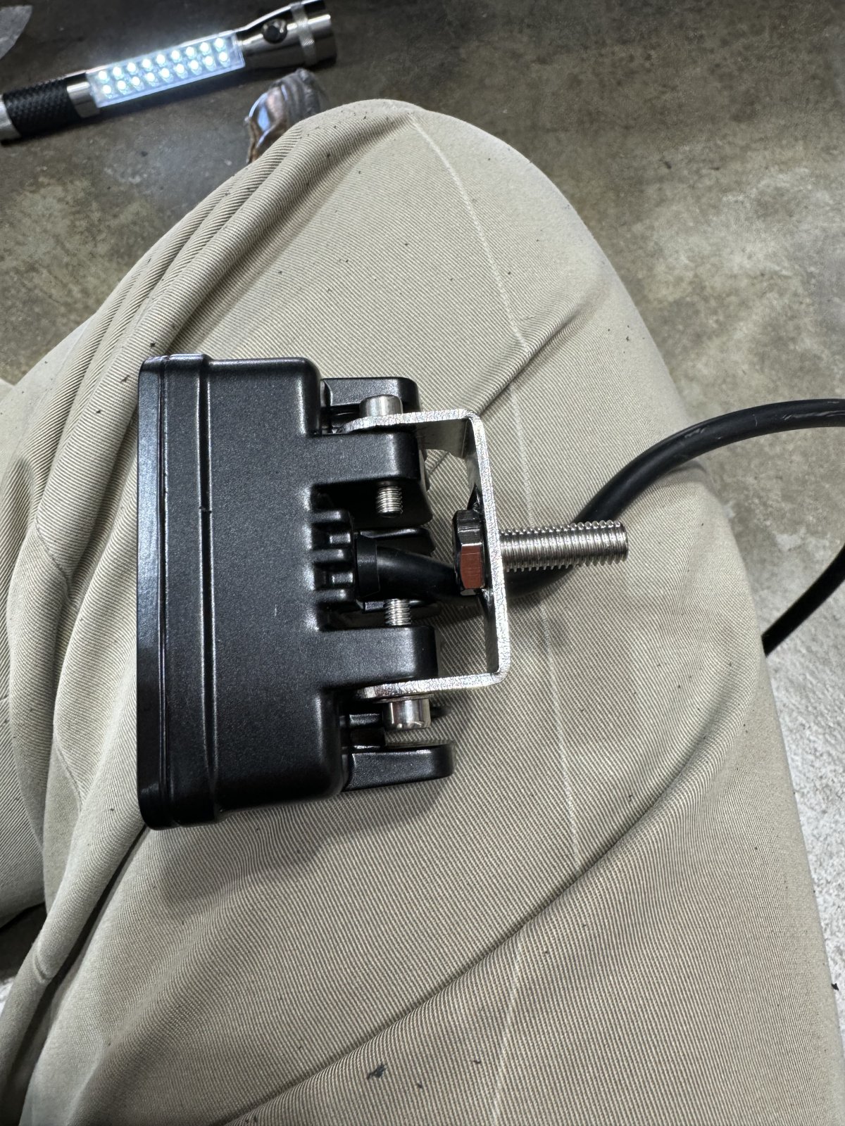

I’m going to have to post the rest of the images tomorrow—site doesn’t like my heics on my phone.
Kpwweb
Dec 11, 2015
771
357
The look great, but pretty much rendered the tow hooks useless, or at least at high risk of putting your fog lights in harms way if you were to use a shackle or a metal hook.
With a strap with loop ends, you may be ok.
Kpwweb
Dec 11, 2015
771
357
There is a little more room than what shows in the photo, but it is somewhat crowded there as well. I was told they may be working on actual clevis hooks, like the at4x has. I should also say they have the same setup that snaps in the grill instead of mounting above the tow hooks, leaving that area completely stock.

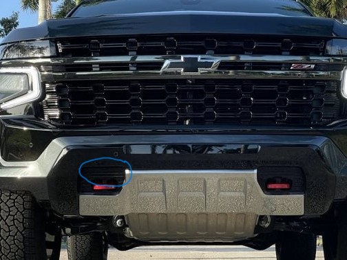

h0m3w3CkeR
Feb 26, 2025
12
Virginia
Has anyone purchased these for the RST or similar models? Considering these since its the only option I have at this point.
Tried installing some in the same area, and on the passenger side there is a small short range radar sensor an inch behind the panel.
