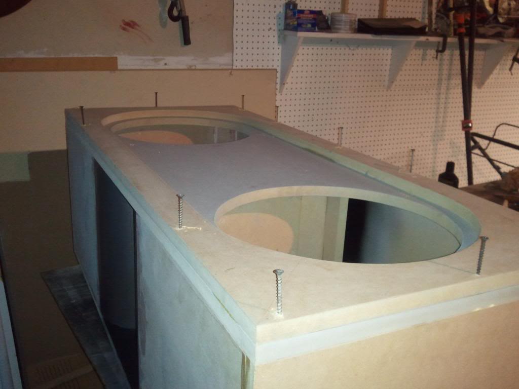

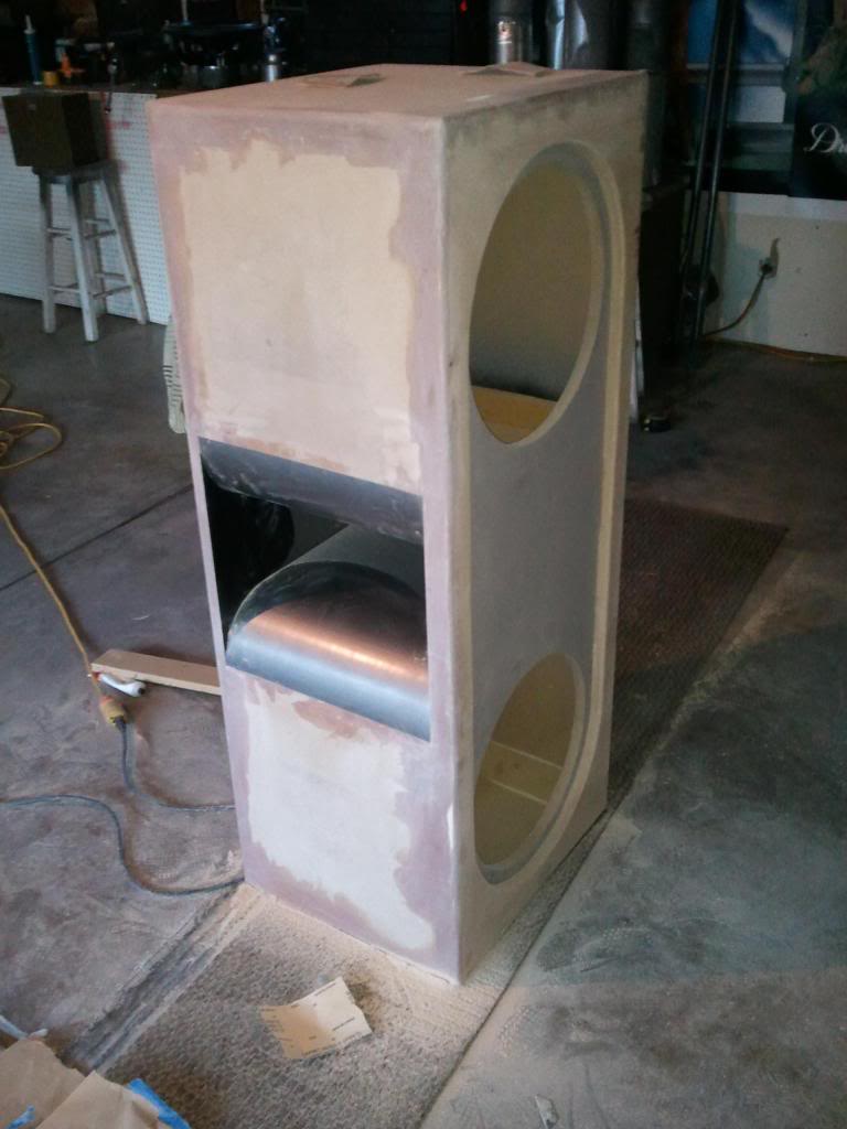

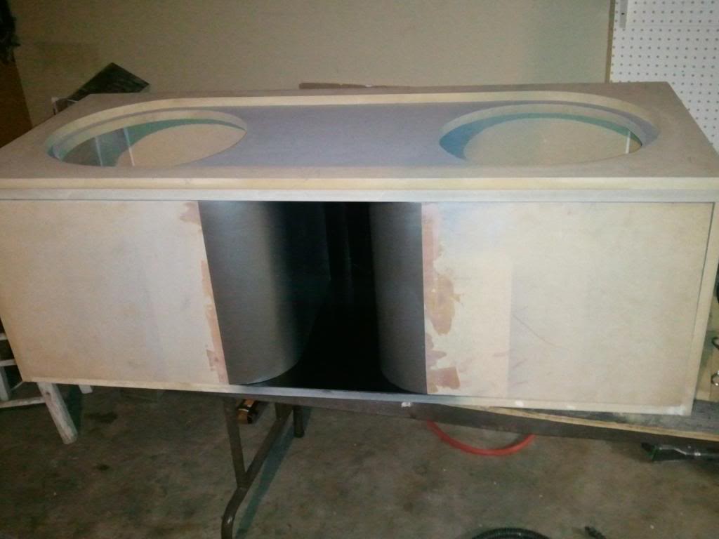

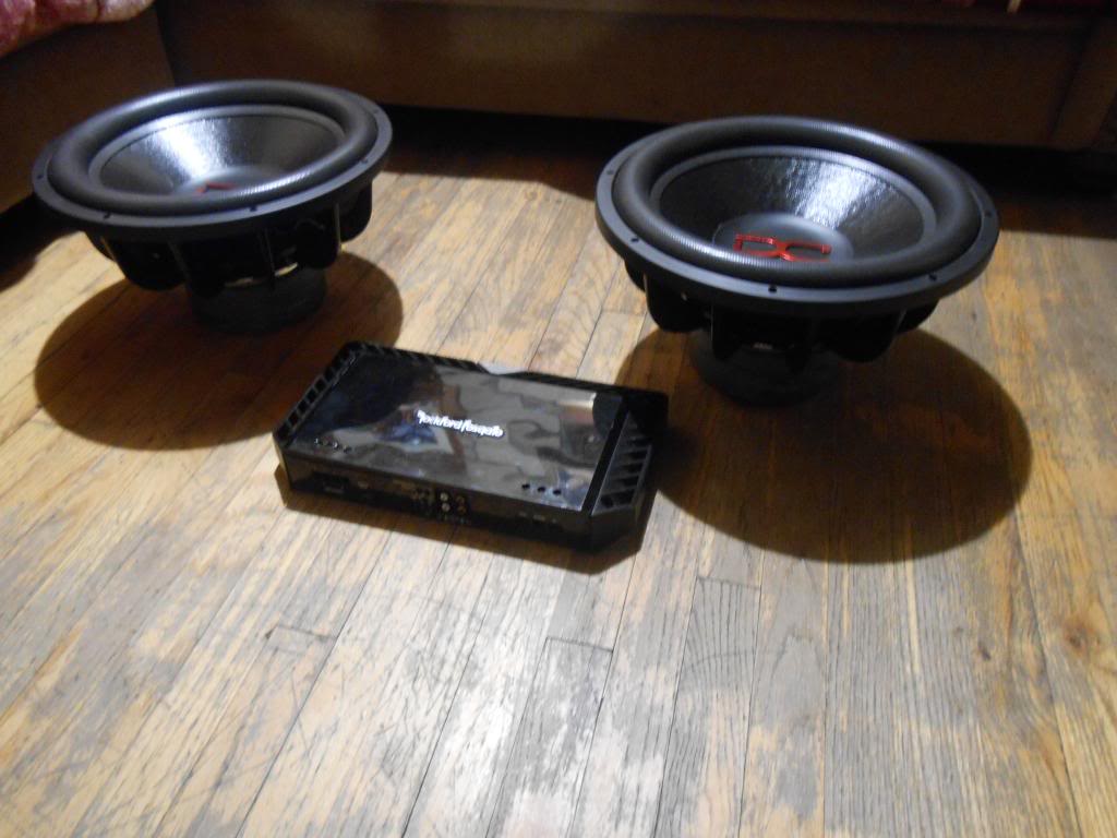

hi everyone i figured id show my current build on my tahoe, here are the details.
the subs are two DC AUDIO level 3 15 inch m2 dual 1 ohm
the amp is a rockford fosgate power series t1500bd
0 gauge cable up to the back
rockford fosgate power t400.4 to power all mids and highs
infinity kappa 6.5" component speakers on all four doors
all amp racks and box is built by me.
i am not finished with my install but this is what i have done so far :D

awesome work so far man that's some great skill work on that box.
Modded
That Guy
May 3, 2009
6,942
109
Nice work man. You real good gear going in.
Waiting for completed pics. :popcorn:
jdpber
GOLD MEMBER
Oct 18, 2010
27,202
29,112
The America

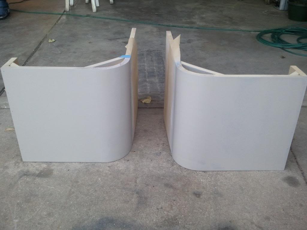

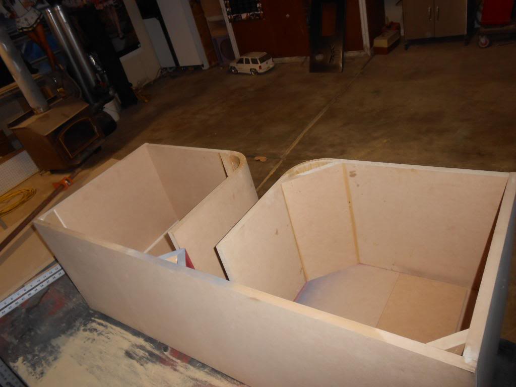

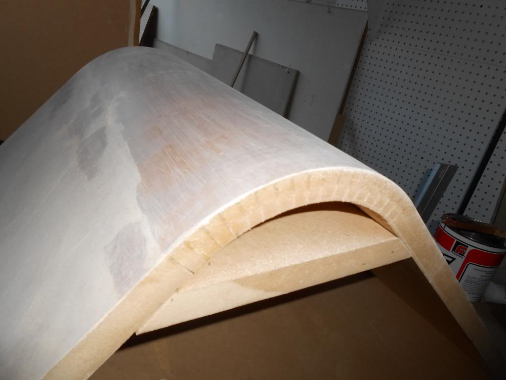

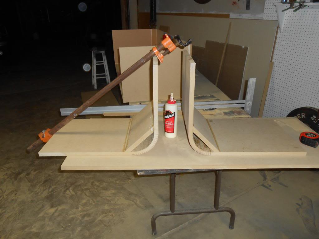

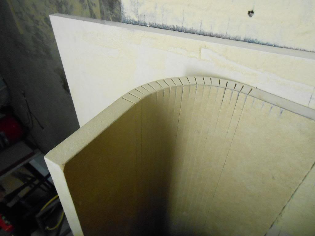

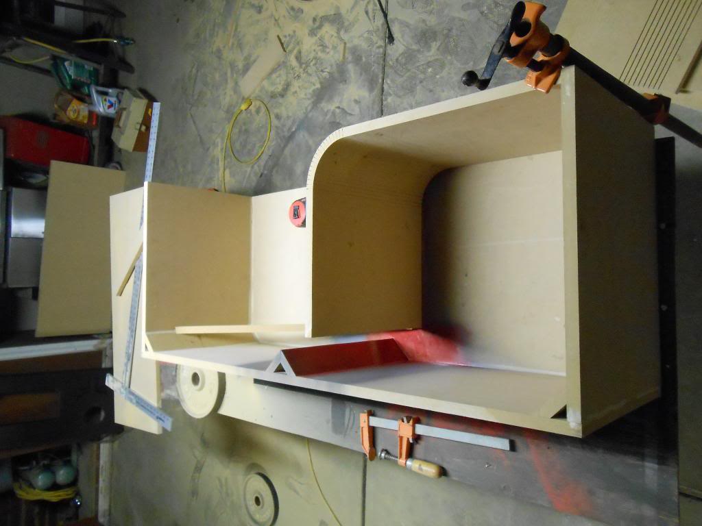

ME like this is going ot be nice.. great work bending the port walls.. that is exactly how i would have done it.. your build is off to a great start

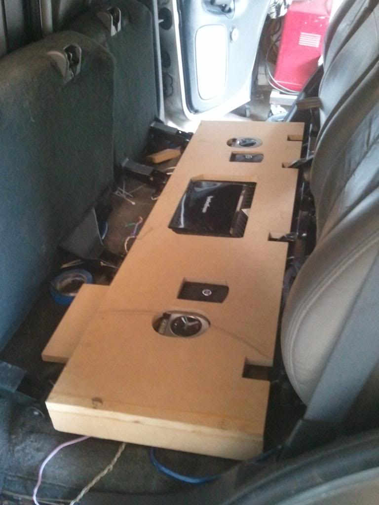

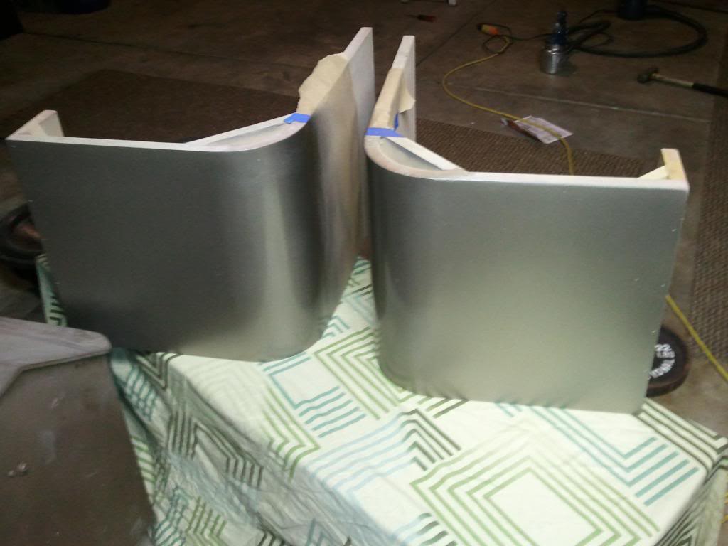

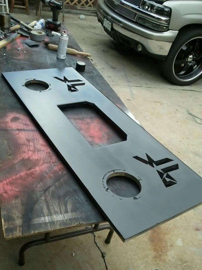

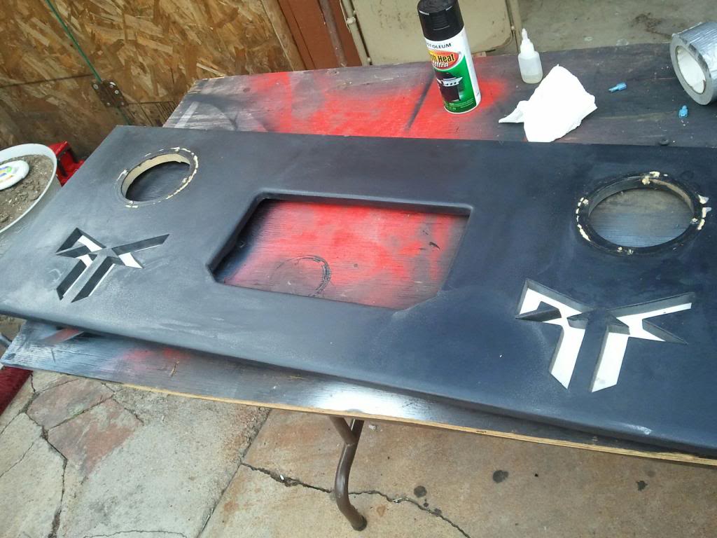

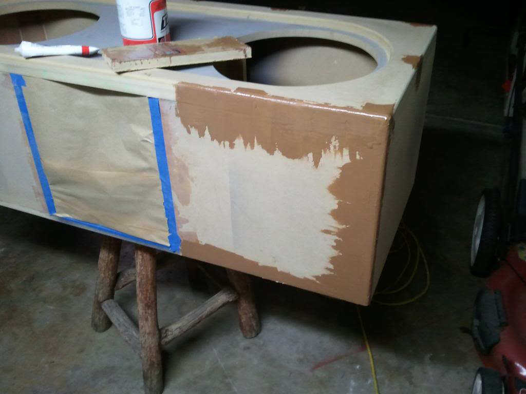

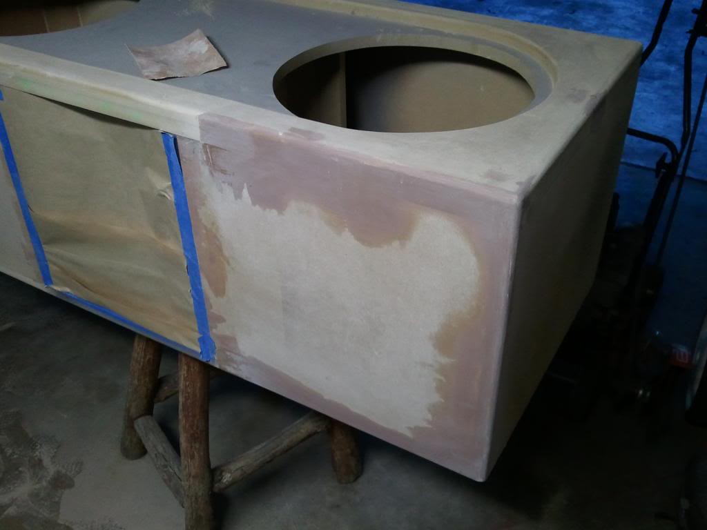

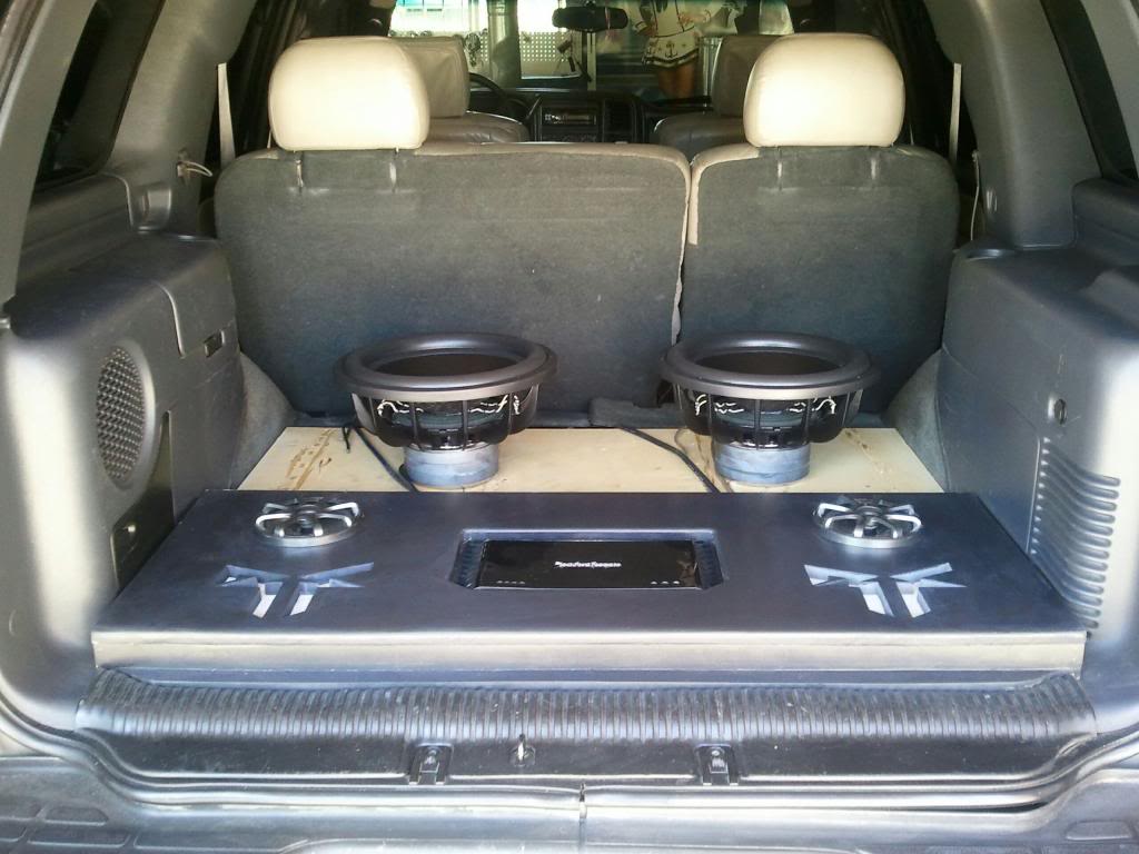

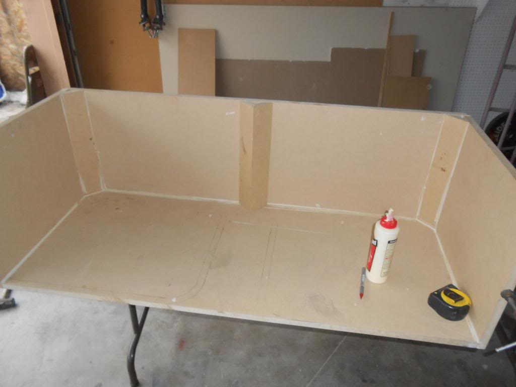

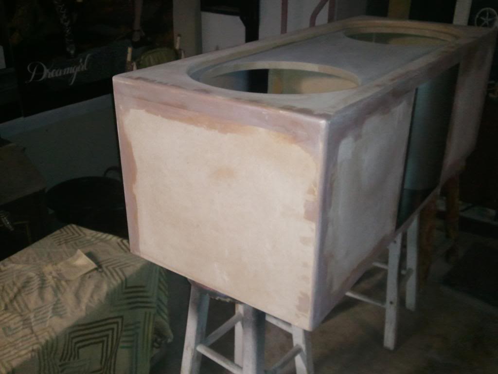

the amp rack i built for the mids and highs

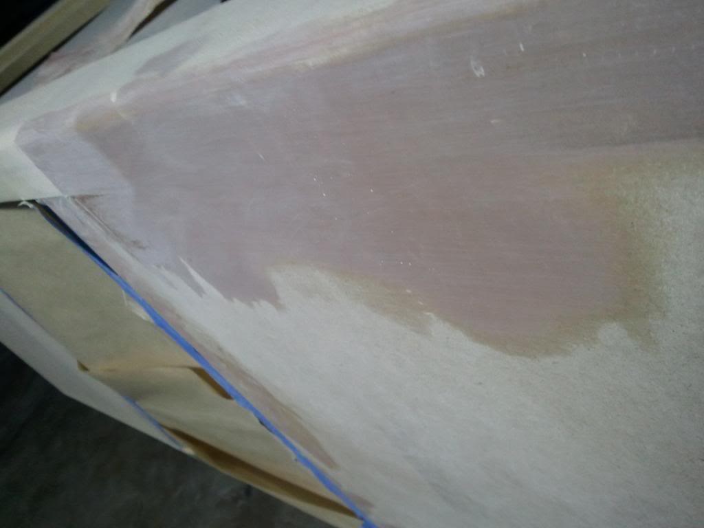

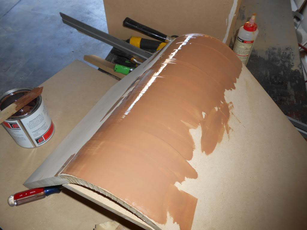

alot of sanding and body filler goes into this box to cover up every seem
josueh95
josueh95
Jun 11, 2012
781
32

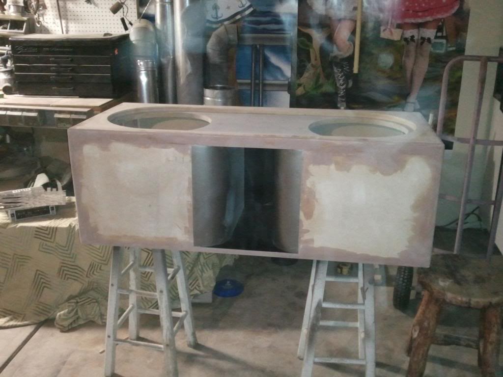

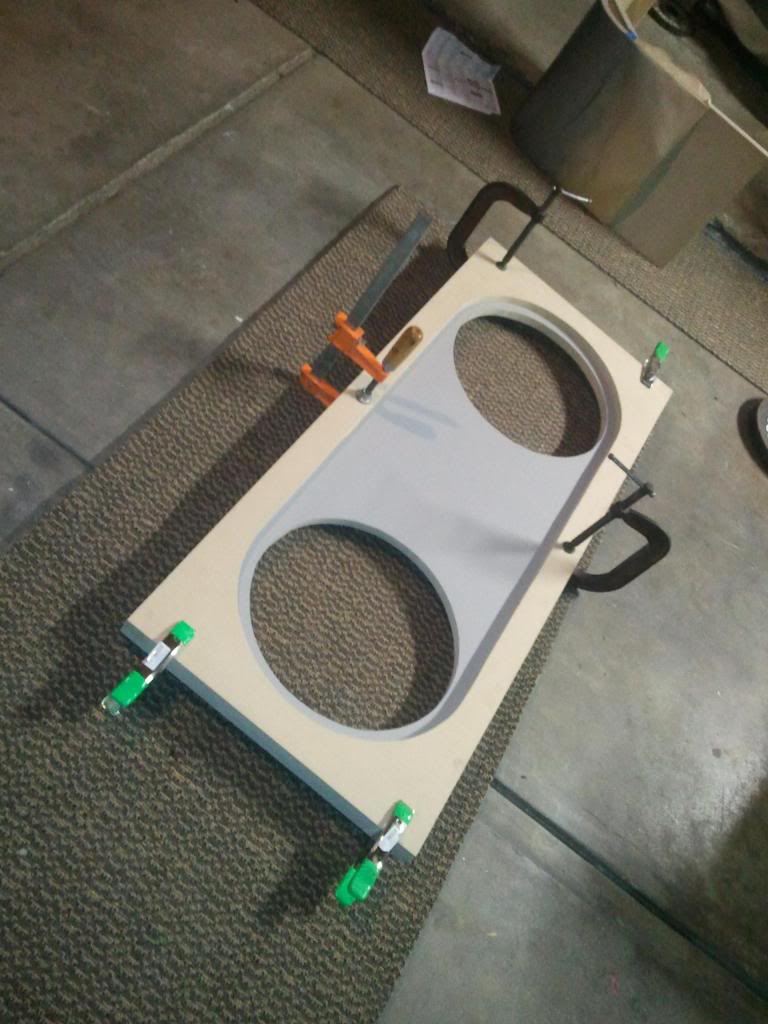

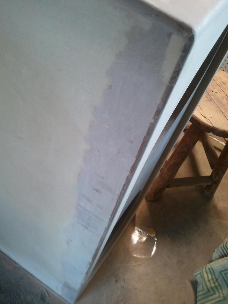

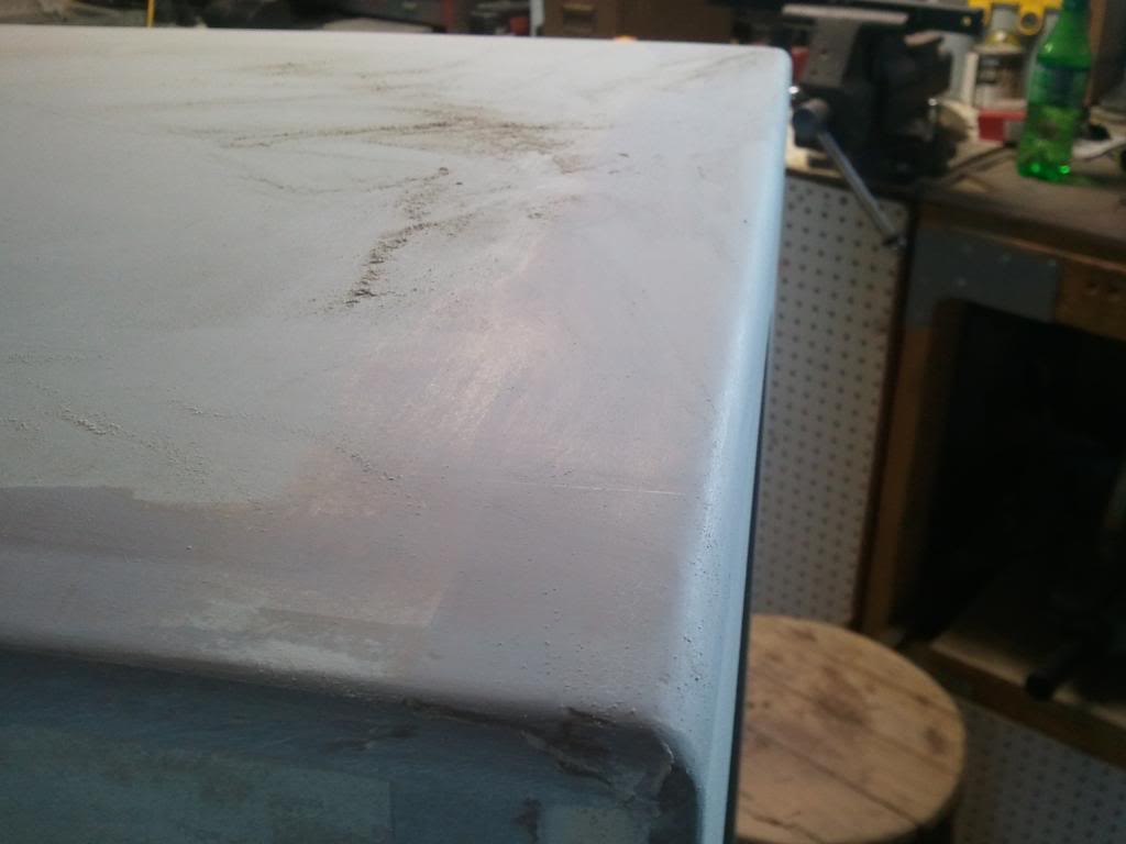

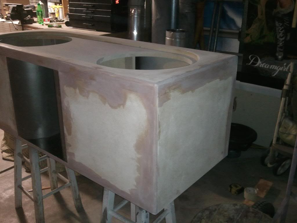

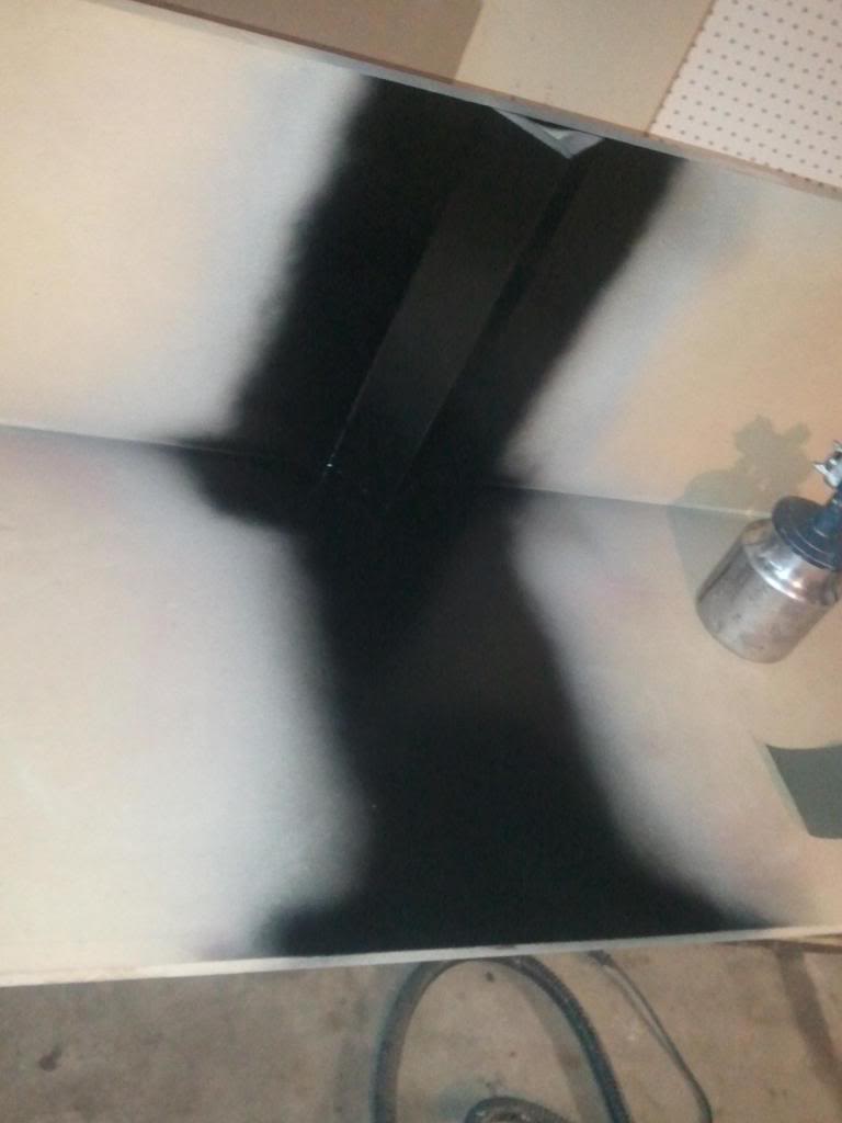

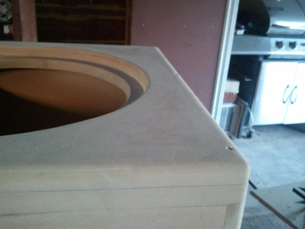

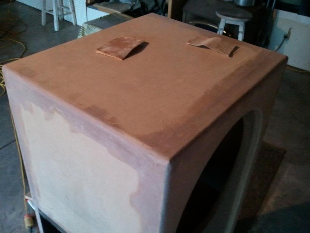

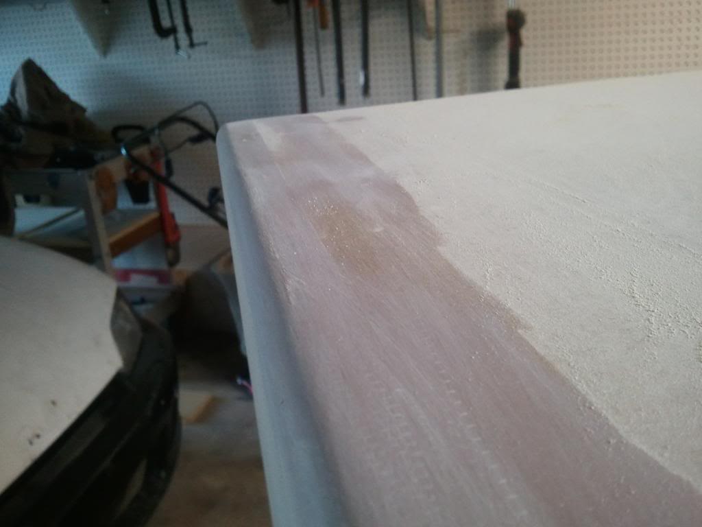

after hours and hours of sanding body filler finally my box is ready for paint :D

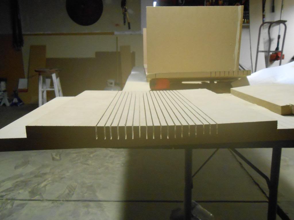

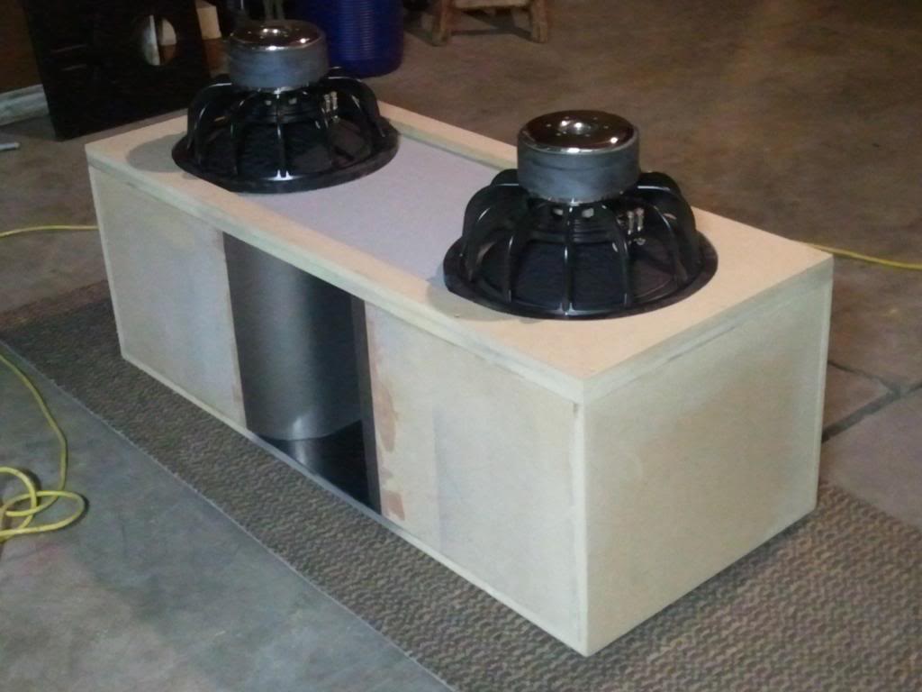

Sweet, you did the kerfed yourself?
Sent from my DROID X2 using Tapatalk 2
josueh95
josueh95
Jun 11, 2012
781
32
yess sir, did all of the work myself i am 17 years old but i have about two years fabricating boxes and improving my own skills. glad you like it :)

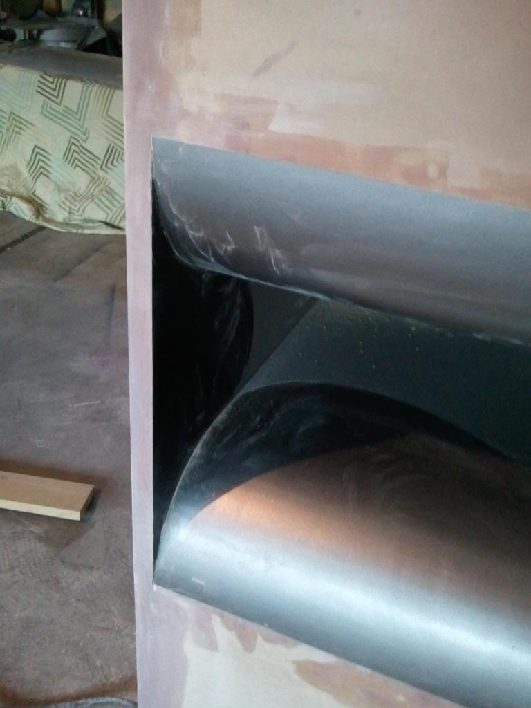

Nice setup man! im running the xl 18s myself dc makes a very solid product! im really digging the kerf port too whats your tuning?

damm you got some badass subs in there.. definitely cant go wrong with DC audio..thanks man my tuning is at 35 hz i jst want it for daily use.

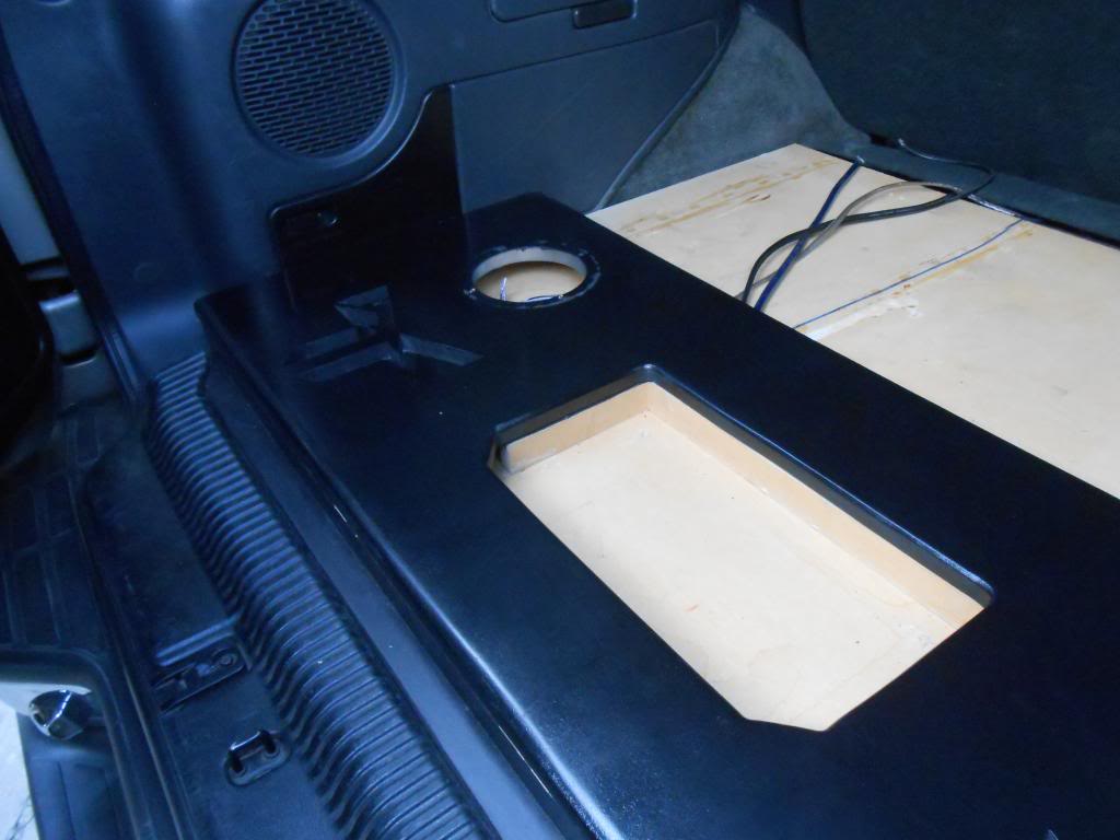

Now will that seat still fold down for use?? Where your amp rack is??
josueh95
josueh95
Jun 11, 2012
781
32
yess seat is still fully functional..with the seat folded down i get about 1/2 inch clearance
