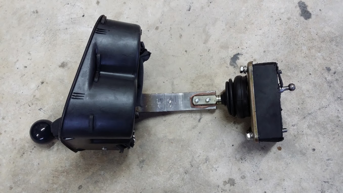

As far as the shifter goes, it's going to be perfect. I fabricated my own shifter to go with the short throw shift kit I made. The position of the shifter isn't exactly where I want it yet, but I'm still tuning the short throw kit. Once I get that fine tuned I can put the center of the shift pattern to exactly where I want. I'll take some detailed pictures the next time I have it apart so you can see what I mean. You really need to see the front/rear view of the shifter to understand how it's placement works. For right now, a side shot is all I have:

So just to satisfy my curiosity, you left the shifter in the stock f-body location? You didn't have to source one of those ridiculously expensive mid-shift kits that moves the shifter forward on the trans to the inspection plate?

I don't know how often he checks this thread so I'll answer for him. Yes, stock Fbody shifter location. Some guys have done the conversion to move the shifter forward, but it's usually the pickup guys that don't have a center console and still have a bench seat so they need the extra clearance.

Oh ok, thanks Mike, that was one of the potential roadblocks I saw to doing this in my Esky and I'm glad it's not necessary. I noticed the company that made the mid-shift kits has gone bankrupt and nobody else makes them, so after seeing all the truck guys on pt.net use it, I was thinking I was stuck, until I found this thread. Now that rockland standard gear has the transfer case adapter and I don't need the mid-shift kit, I'm going to start acquiring parts to swap in a t56 if/when my trans dies.

Mike is absolutely right. I'm using the stock shifter location as indicated in the pictures in my first post. My T56 is attached to a stock F-body bell housing and is then attached to the engine as it normally would be. With my 2004's center console and the stock f-body shifter the alignment is almost perfect - it's like it was meant to go into our NBS trucks. Look at the pictures in my first post of the center console with the cup holders removed to see this. I'm not sure if it is easy to pick out, but I did put a couple slight bends in the mount for the shifter. This moved it just a little to the driver's side - if you're have some basic fabricating skills this shouldn't be difficult. I can get you some more pictures of the shifter if you need them, just let me know.

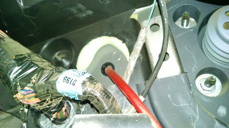

For the nnbs, the clutch pedal would be an obstacle for most people unless you have some fabrication skills. To my knowledge none of the nnbs rigs had a clutch pedal that'd bolt-in. The nbs trucks did, so the swap is pretty easy since the truck pedal assembly/hydraulics are a direct bolt-in deal.

You can buy the whole pedal assembly from GM.
For an NBS, yes, and It's a direct bolt-in for a NBS suv. Will it work on a NNBS suv, I doubt it since I don't think the two share the same firewall and to my knowledge GM hasn't offered a manual trans in any of the full size GMT900 (NNBS) platforms . Plus the whole pedal assembly and bracket is plastic so It's not easy to modify like a metal assembly.

That link posted shows the same pedal/bracket I'm using for the NBS.
If the NNBS firewall looks like this, then you all are in luck.
Right where that red power cable goes into the firewall is where the hole gets cut for the master/pedal/bracket assy.
