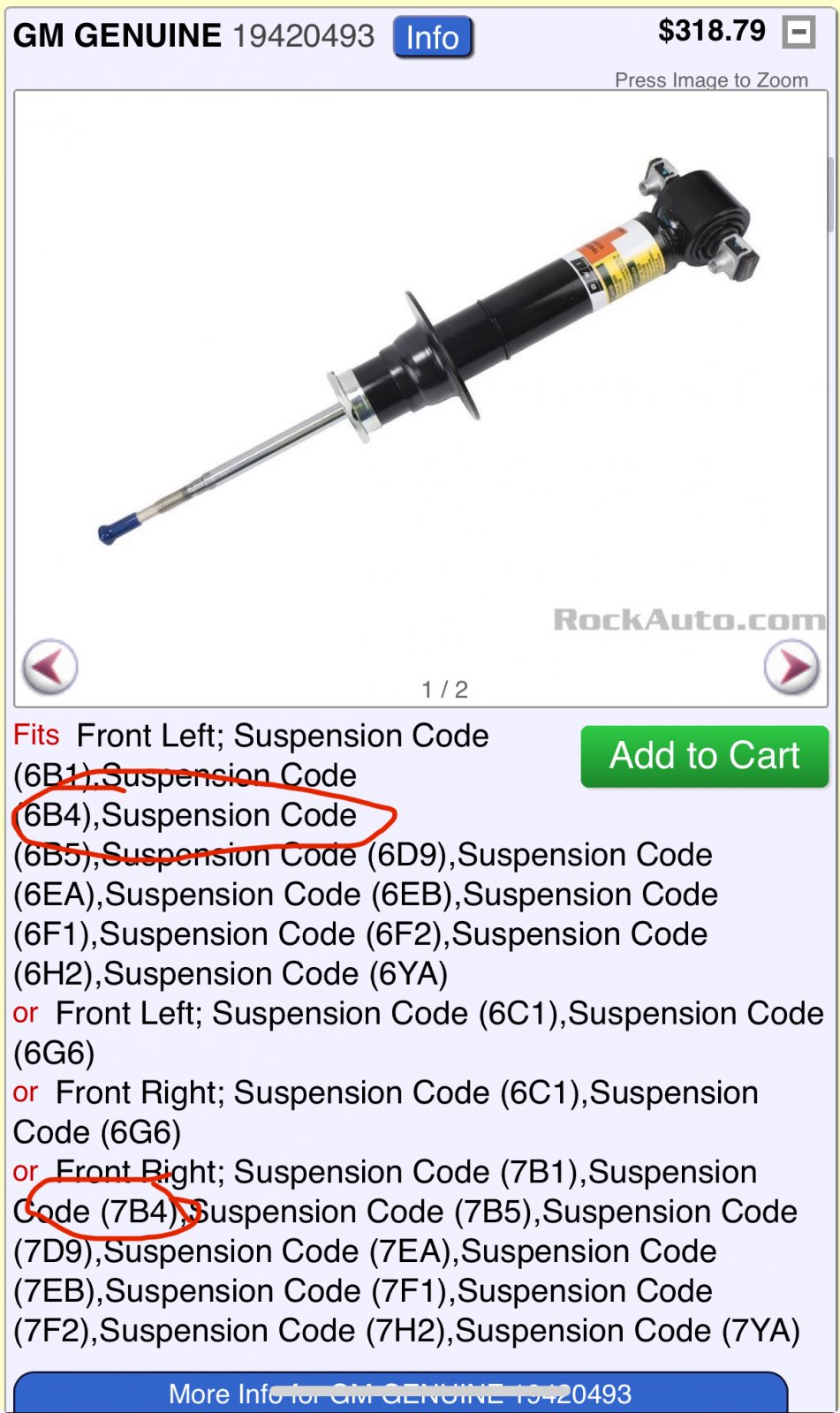

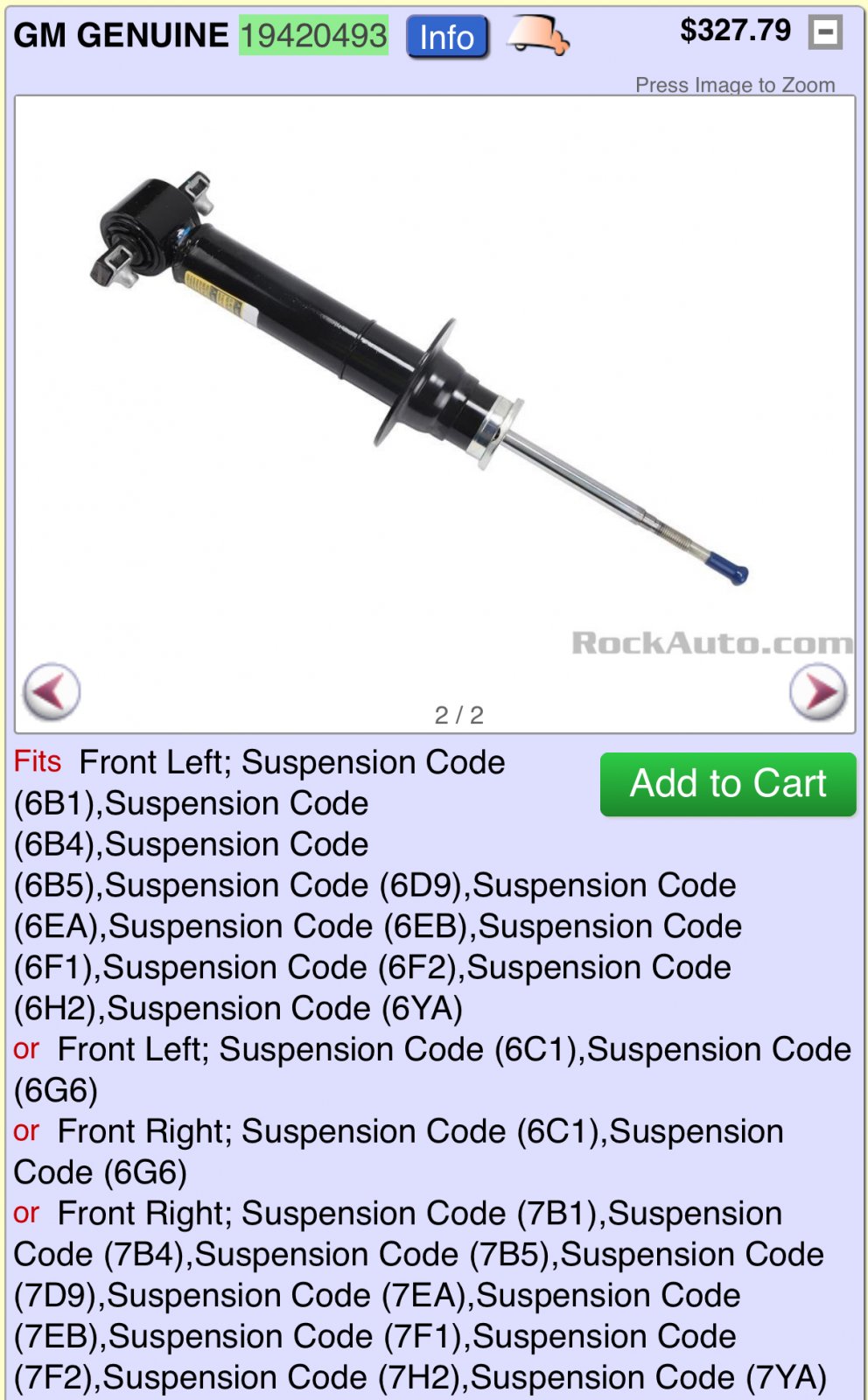

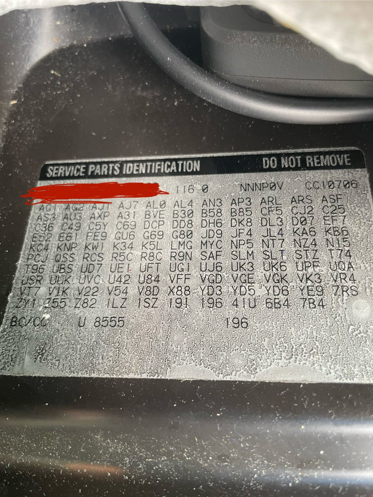

I had my buddy that’s a mechanic install them. And I do have the Z55 suspension, I picked out that strut because it matched with my RPO codes. What was the correct part?

Your RPO says Z55? I can see it on the lower left hand side

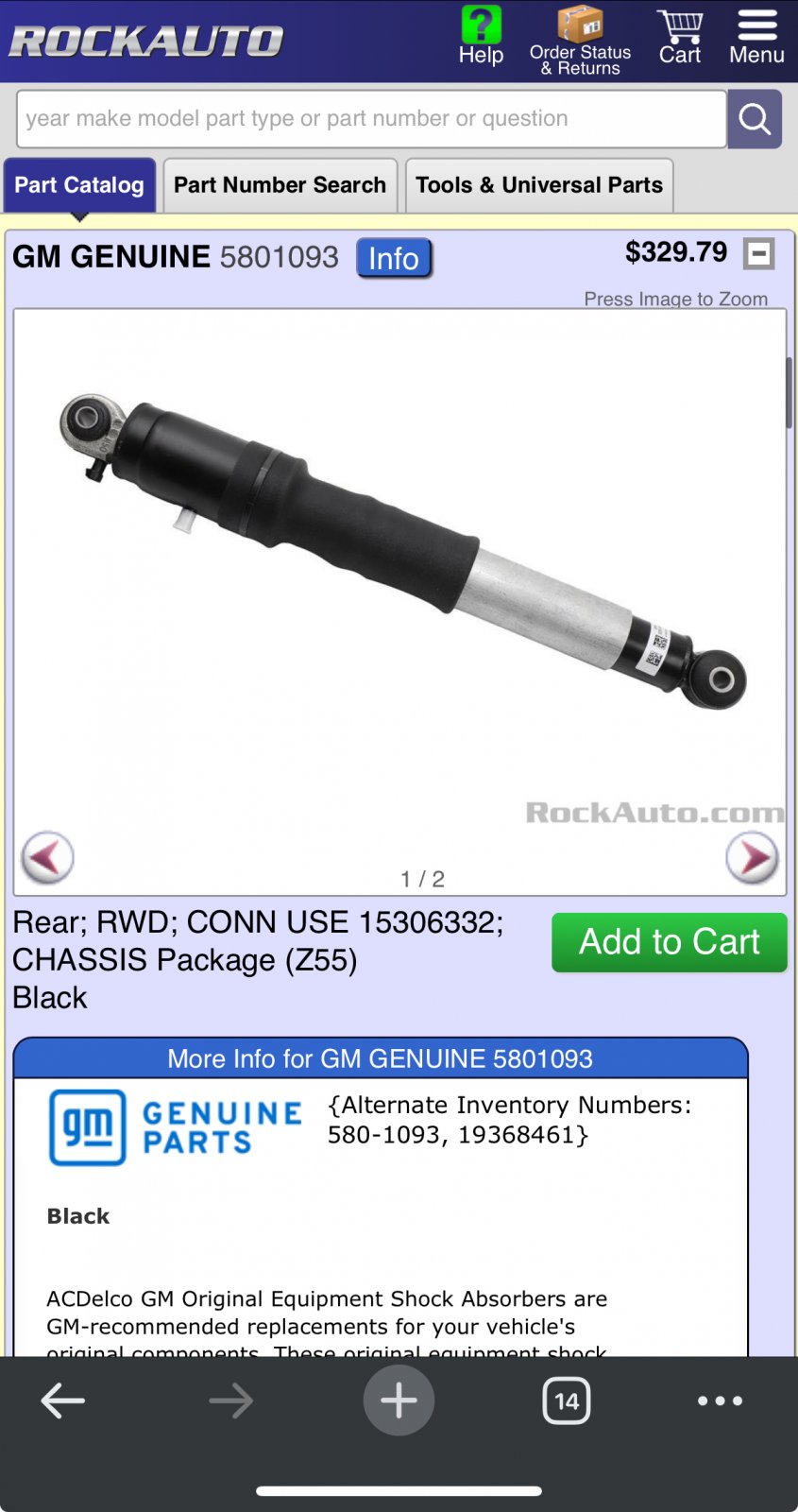

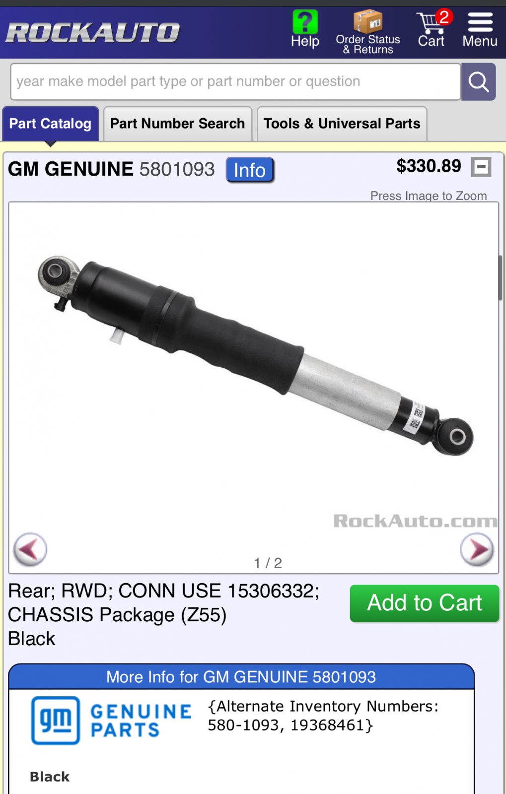

I got the rear shocks installed at the same time which says “Z55” and they’ve been perfect. As for the front struts, RA doesn’t say anything about Z55 on the OEM parts descriptions, it shows those other RPO codes, so that’s why I matched it with 6B4 & 7B4 code.

Was freaking out for bit in case I had bought the wrong part. My local dealer closes in 15 mins. Gave them a call, gave them the VIN and they gave me the part number and it matches the one I had bought (19420493).

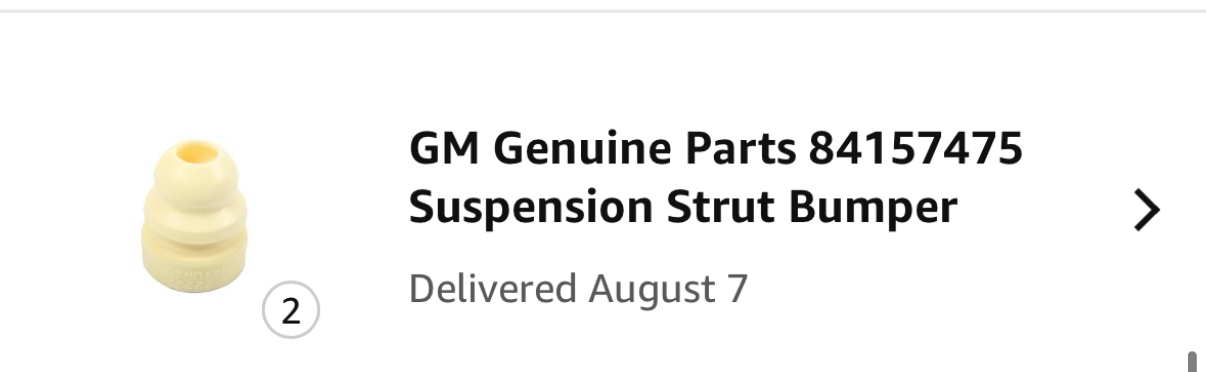

So I bought both of my rear shocks (GM 5801093), both the front struts (GM 19420493) and reused everything from the old struts except for the suspension strut bumper and bought two of them on amazon (GM 84157475).
