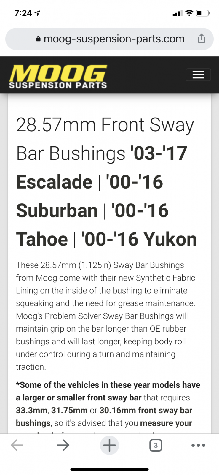

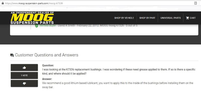

Some are designed not to be lubed. The moog ones installed are of that variety
Moog recommends lithium-based lube for the bushings on my sway bars.

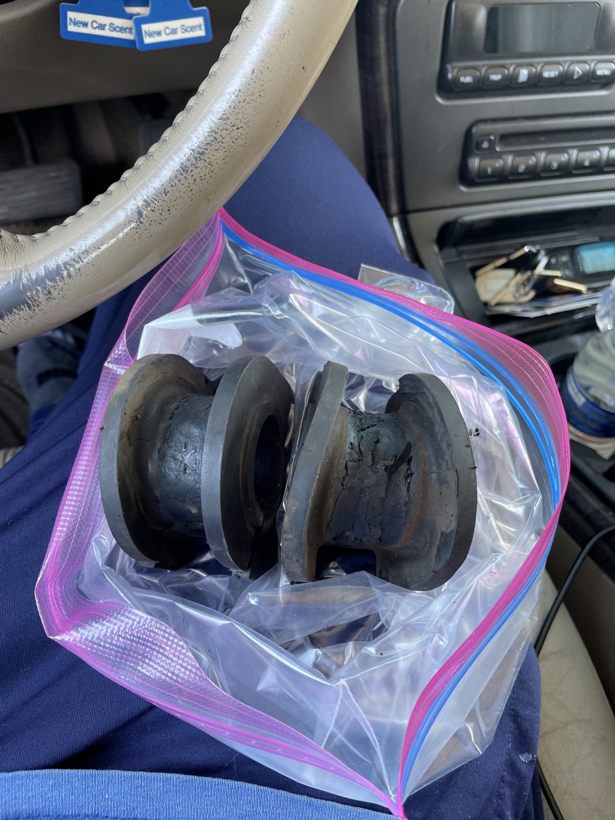

I finally found the time to change my bushings out. What could cause my bushings to look like this after 6 months. Pretty crazy

They look like you've been doing some "DareDevil Dan" stunt shit! You haven't been putting it up on the two side wheels have you? You know to get around slow poke drivers or to get into that tight parking space at work...Anything like that? LOL!!! Seriously, they looked like mine after 120K miles. You may have gotten counterfeit parts.

I finally found the time to change my bushings out. What could cause my bushings to look like this after 6 months. Pretty crazyView attachment 281587
They might be the wrong size. Hopefully you bought some poly ones from Energy Suspension, the ones with the grease fittings like I suggested. Mine have been on for 30k or more and still look great. And believe me I drive it hard.
