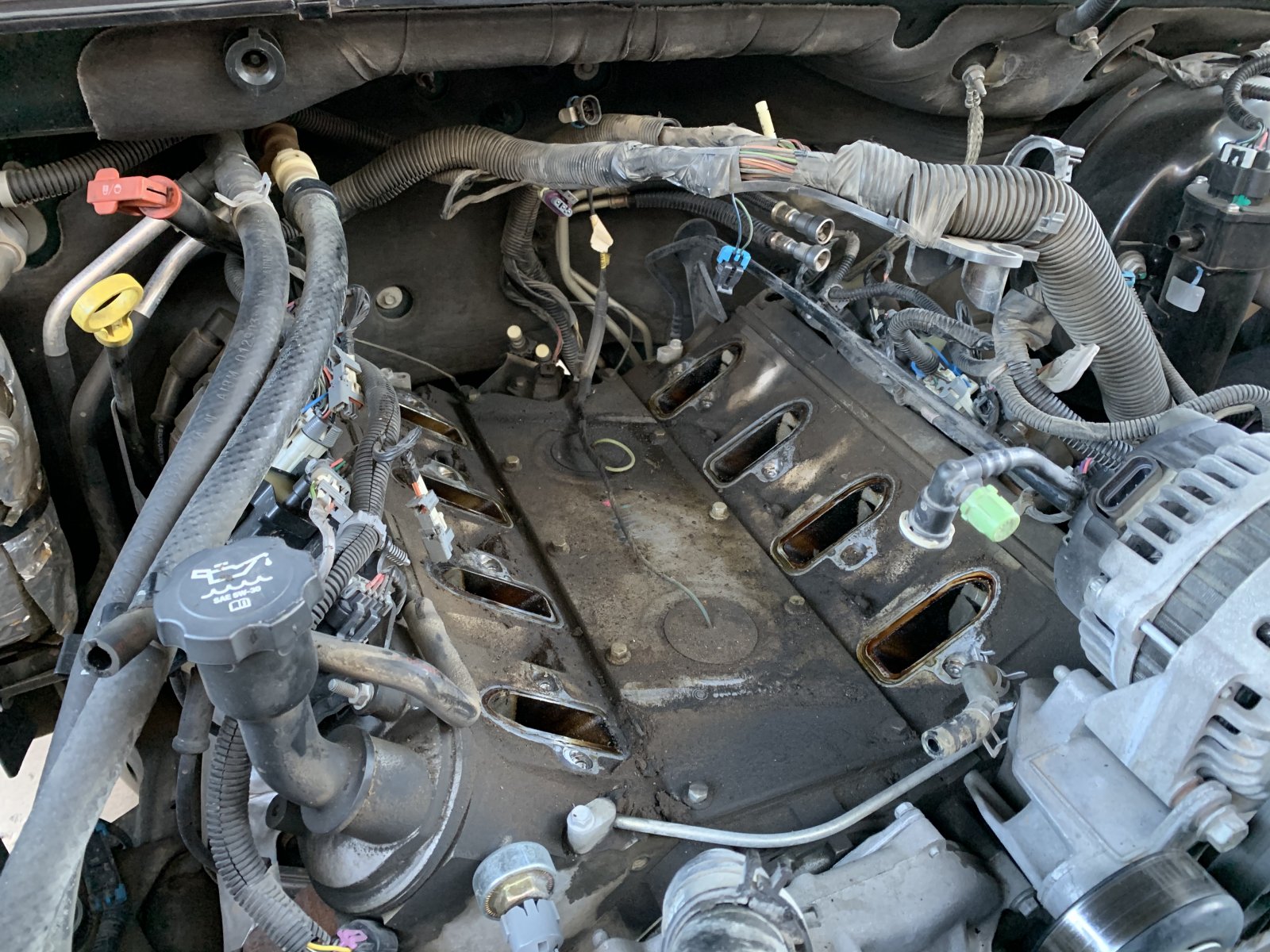

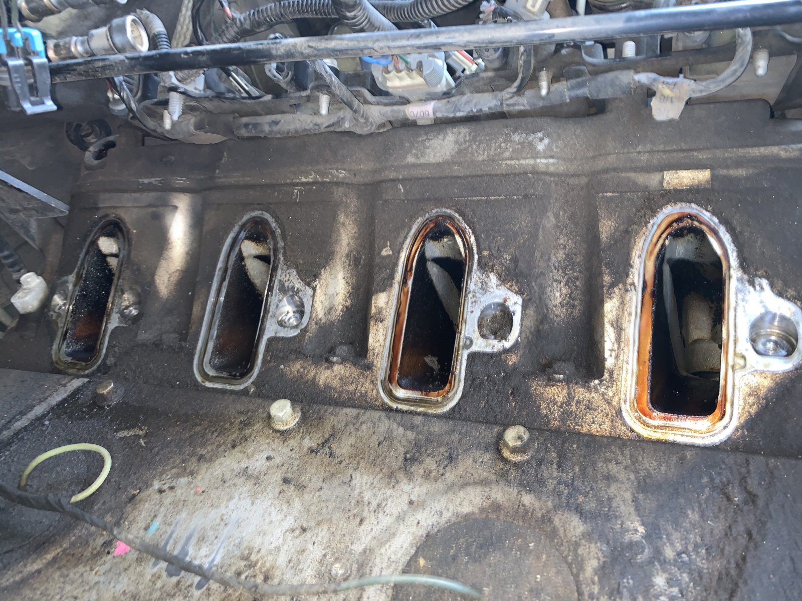

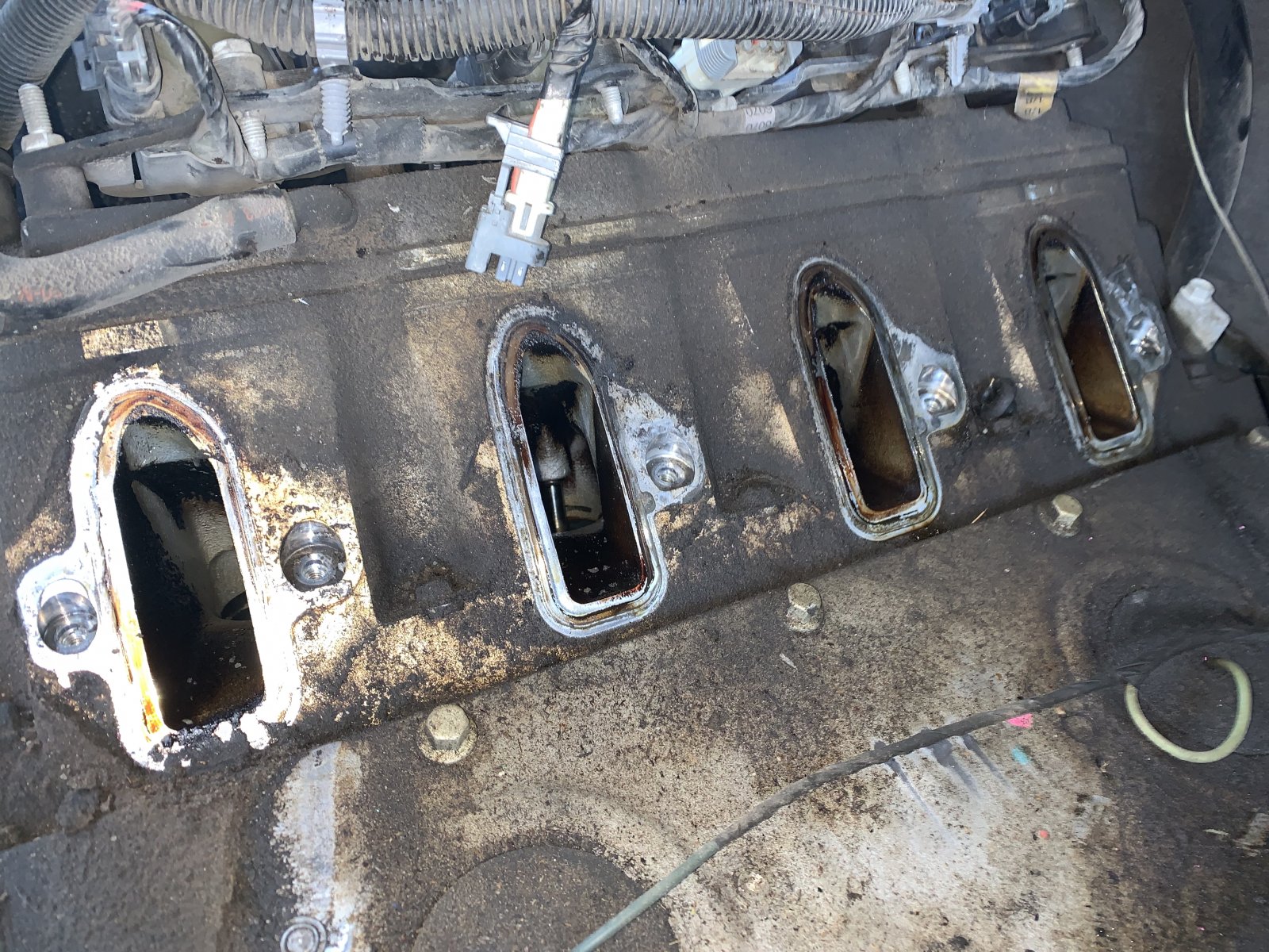

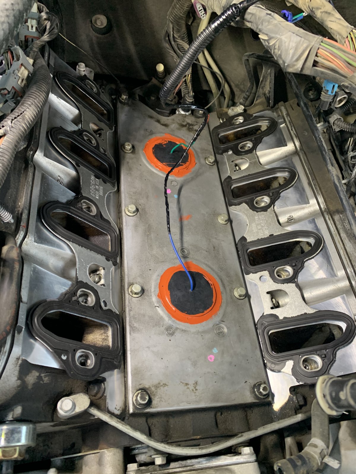

So I went on the road to travel for work last week and as soon as I left my wife said we have an engine light on. I had her run codes and found a P0171 and P0174. The temps had dropped into the teens for the first time this year. After some research it sounds like intake gaskets leaking. I did't do any real diagnostics as the engine was running fine when I returned and temps were back in the 50-60s. I needed to change the oil pressure sensor as well so at least this was a good opportunity to replace it. Also doing the knock sensors today before putting it back together. The previous owner had wired a knock sensor into the front of the passenger cylinder head!
