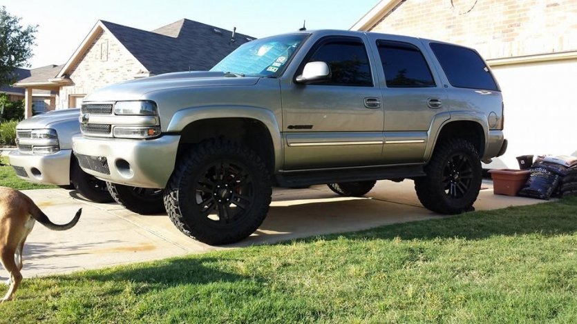

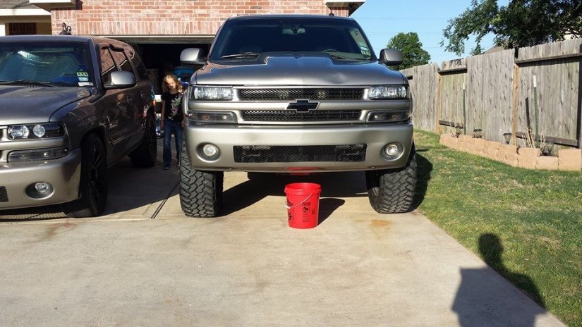

Rough country 6" rear kit, CST 3 - 4" lift spindles , pro comp keys installed but not cranked! Adjustable Panhard bar. This will allow you to run 35X12.50's with out rubbing. It'll be stout. As hell. Look at my wife's photos!
Z-56 Hoe
What do I do????
Jan 18, 2010
2,573
164
Houston
image.jpg. If you do the Z-71 rear springs you are gonna be sagging like crazy in the rear! Trust me I know from experience

thanks for the info, the wife's tahoe has a great look. the suspension is where is want my truck to be. cant wait to get all the parts and slap them on.
