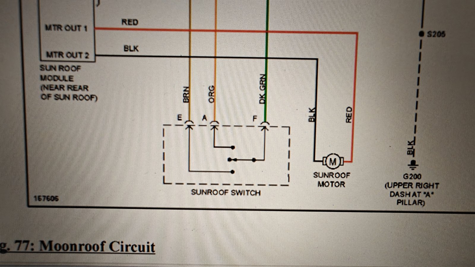

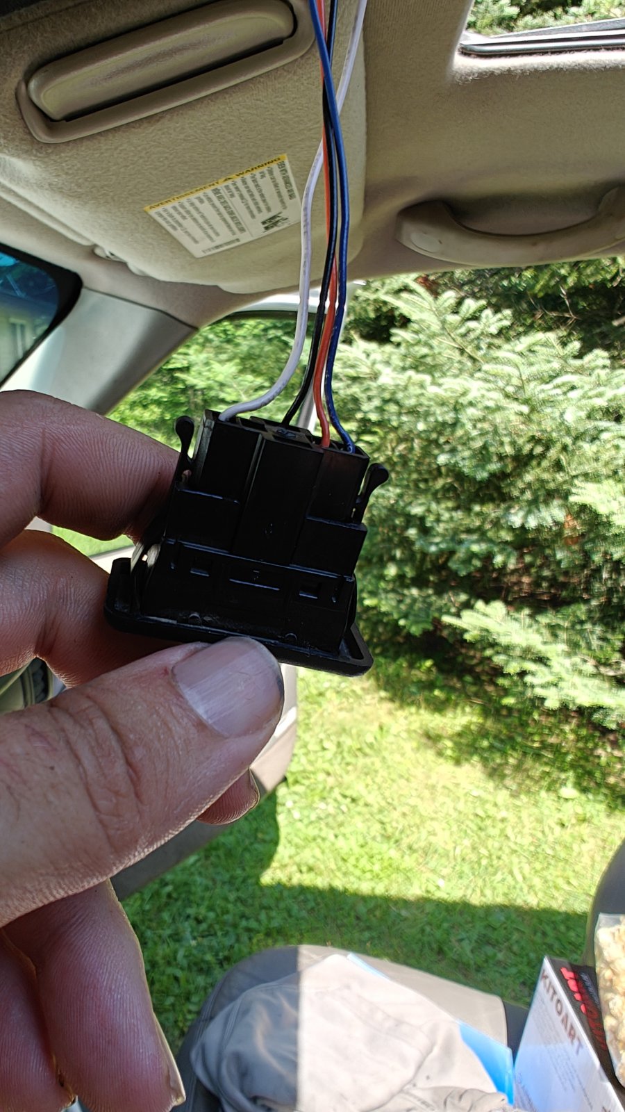

The switch on the schematic doesn't match what's in the vehicle. Orange is power and I do have voltage there. But jumping any combination of terminals in the connector doesn't anything.

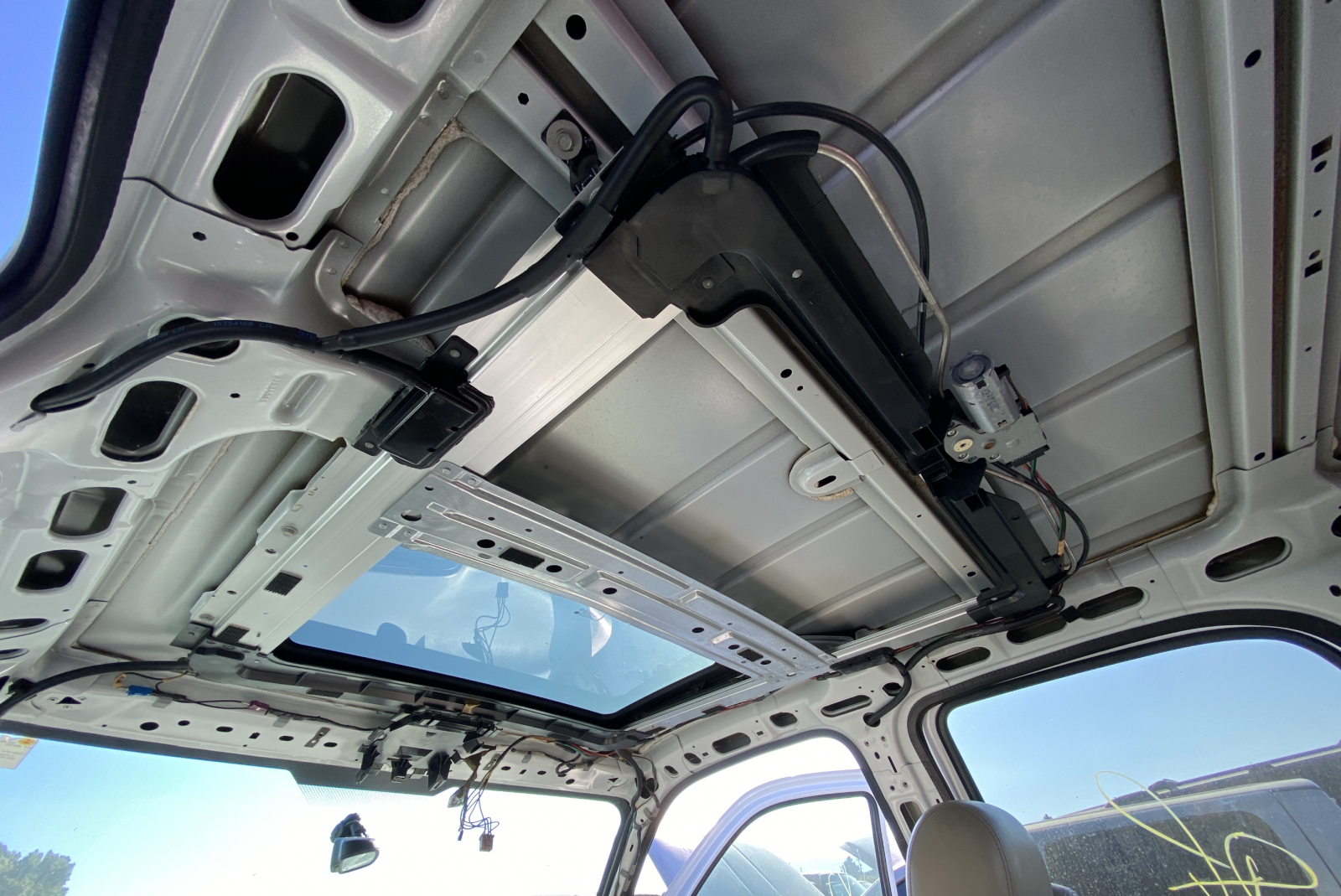

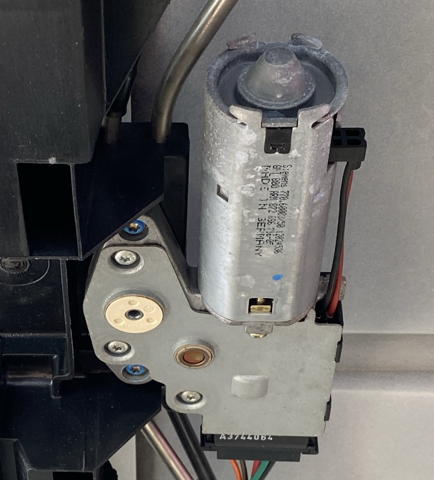

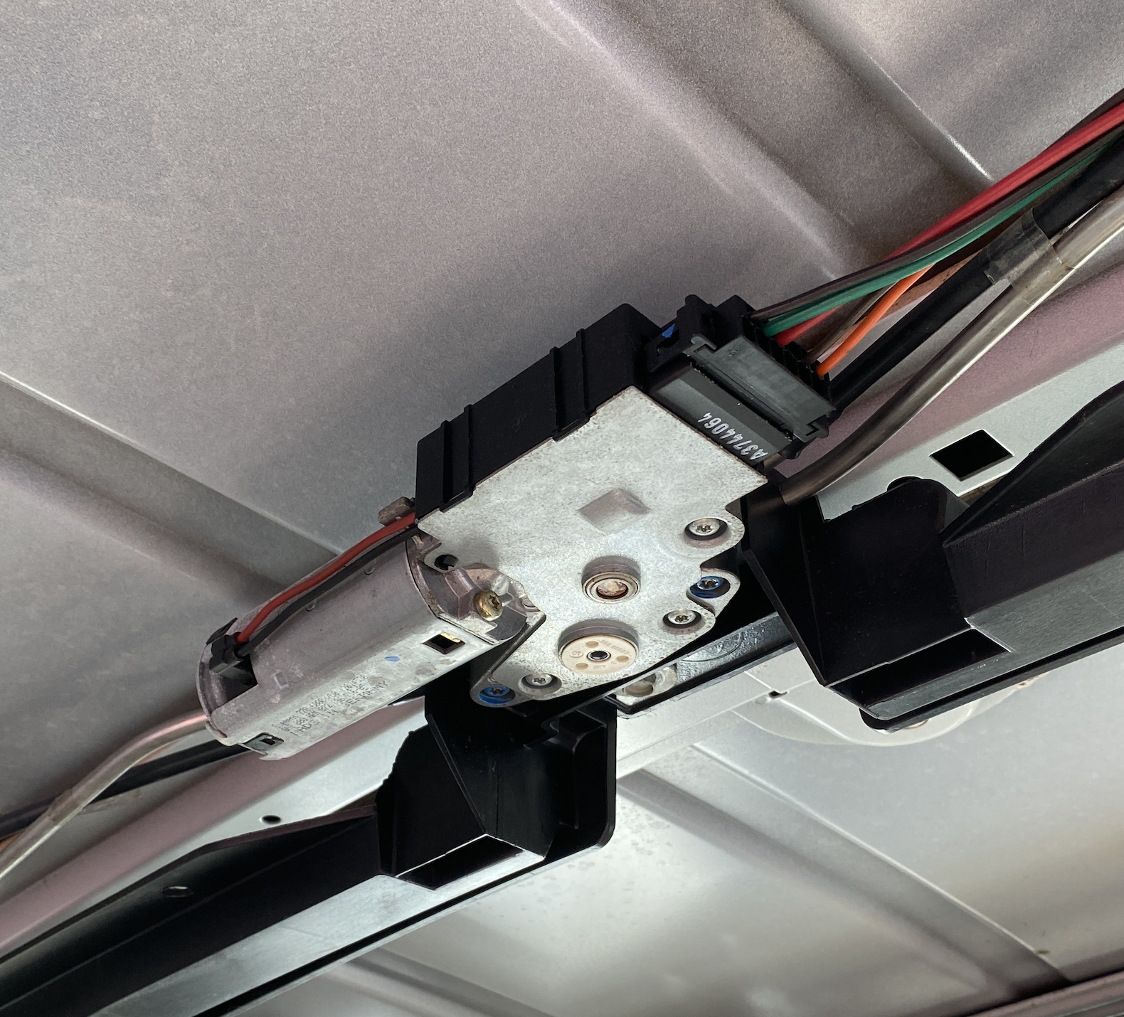

Should it turn out to be the motor, this is what it looks like as seen from the rear seats. The two blue Torx bolts hold it in place. If you need to source one online, also query Mercedes Benz ML320 from '98 to '05 in addition to your '03 Tahoe. It is the same Siemans motor, made in Germany, and usually listed at a much lower price. You'd think it would be the other way around but nope.
Photos are from an '04 interior. ** (a different model sunroof motor appeared in either '05 or '06.)

What's the easiest way to get at it? I pulled the interior pieces down around the passenger side doors but I can't really see much. The overhead console is help by a tamper proof torx screw and I don't have any tamper proof screw drivers here. Also afraid of messing with the plastic thing in the sunroof opening that holds the fabric in place.

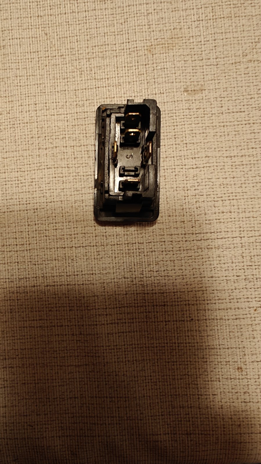

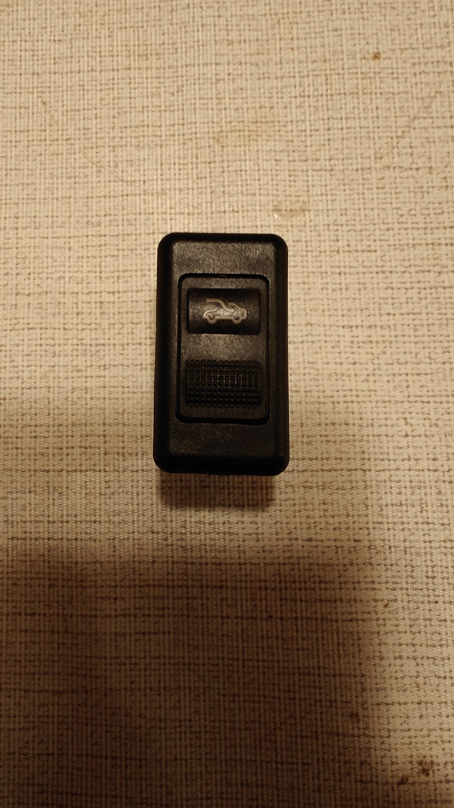

Does anyone recognize this switch? I kinda wonder if it came from a different vehicle platform because I don't believe it belongs in mine.

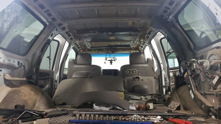

If it proves to be the motor, I'd remove the A, B and C pillar covers on the passenger side. Then drop the entertainment console to access the sunroof motor from a rear seat or the passenger side. Here's a wider view of what lurks above the headliner for references.

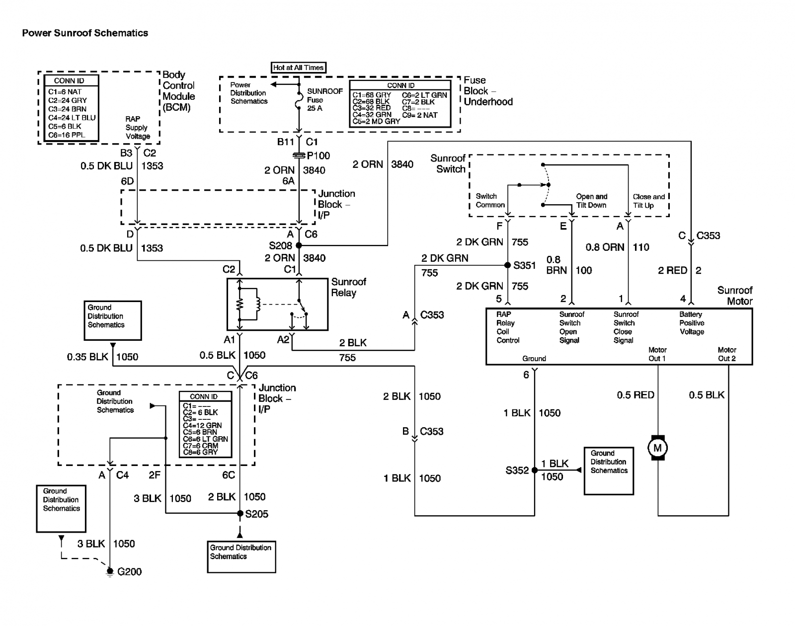

when I was diagnosing a sunroof issue in an 04 avalanche, this was the diagram I used for testing. and it matched up perfectly. some have mentioned that the avalanche sometimes has slightly different wiring from the SUV or Pickups but I haven't come across that yet. most electrical diagrams for 03-06 match up for both trucks and Suv's. and the relay that I tested on was located behind the electrical connector panel in the right side dash below the a pillar. (again this was an 04 avalanche) hope that helps.

Thanks @Roilux . It looks like the motor should be accessible through the rear passenger door if I can get the headliner dropped low enough. I have the trim pieces removed but can't see much yet. This even looks different than what I have. I'll have to see if I can get a decent picture later. I also don't have the rear entertainment system.

Thanks @BigDogYJ . That seems to closer match the schematic I have. I dug around last night looking for the relay but there wasn't on the passenger side of the dash. The only thing in there was some kind of connector module.

This is what I've figured out so far. The switch seems to be good. I did continuity checks across the terminals when rocking it back and forth and do have continuity between power coming in and both positions for actuating the sunroof.
Orange is power
White is tilt/close
Blue is full open/close
Black seems to be a path to ground which right now I'm not sure the purpose of. I also don't remember any continuity across any terminals to the terminal running to ground.

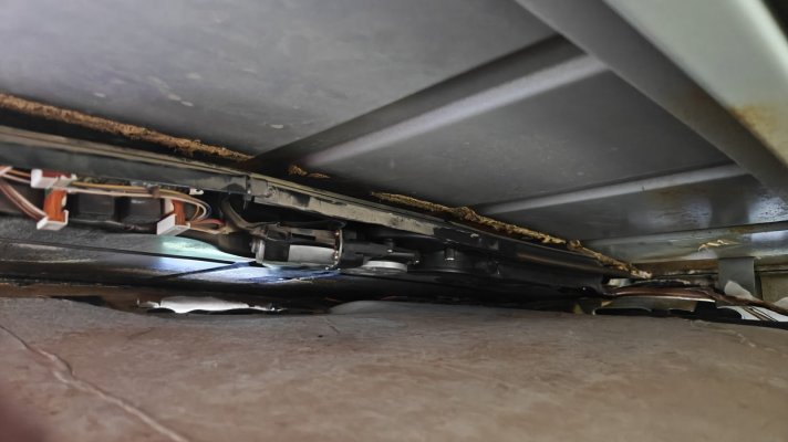

I've been having some conversation with Chat gpt this afternoon. The picture here is from when I had the headliner out a few years ago. But judging by this the sunroof is an aftermarket install. And apparently has a manual crank.
Jobi-Wan Kenobi
Jobi-Wan Kenobi
Aug 27, 2022
289
345
I am at a loss with what to do with this right now. I'm fairly certain that the sunroof is an aftermarket install but I can't find any kind of manufacturer info to tell me what it is. And I can't find any kind of manual crank to close it by hand.

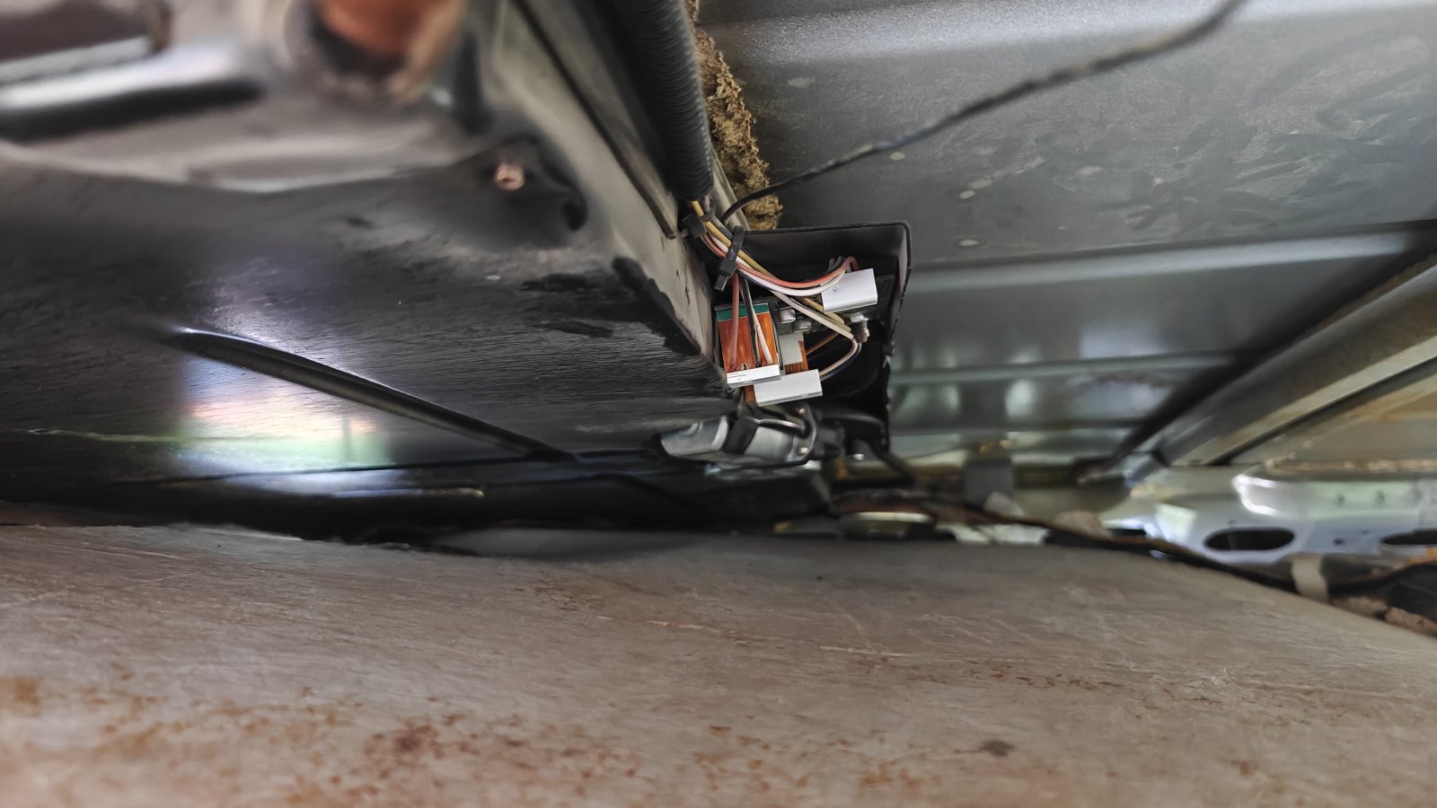

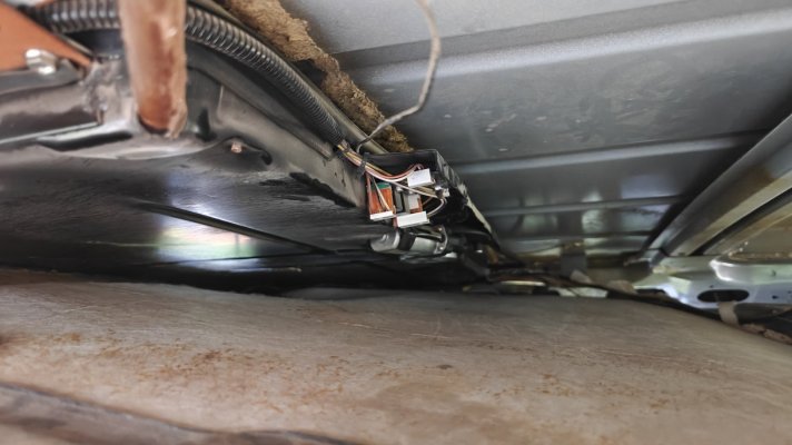

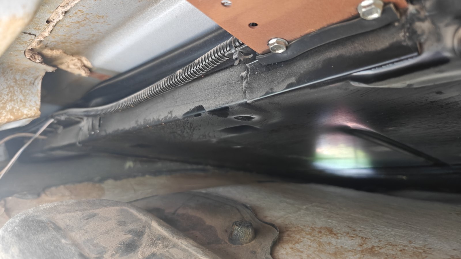

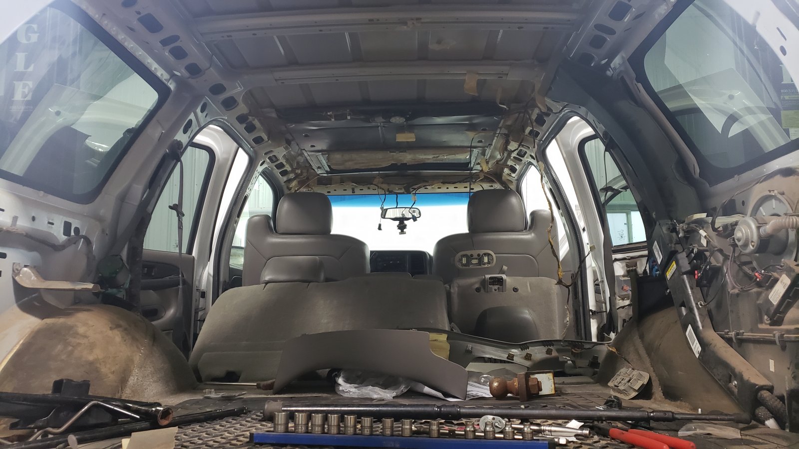

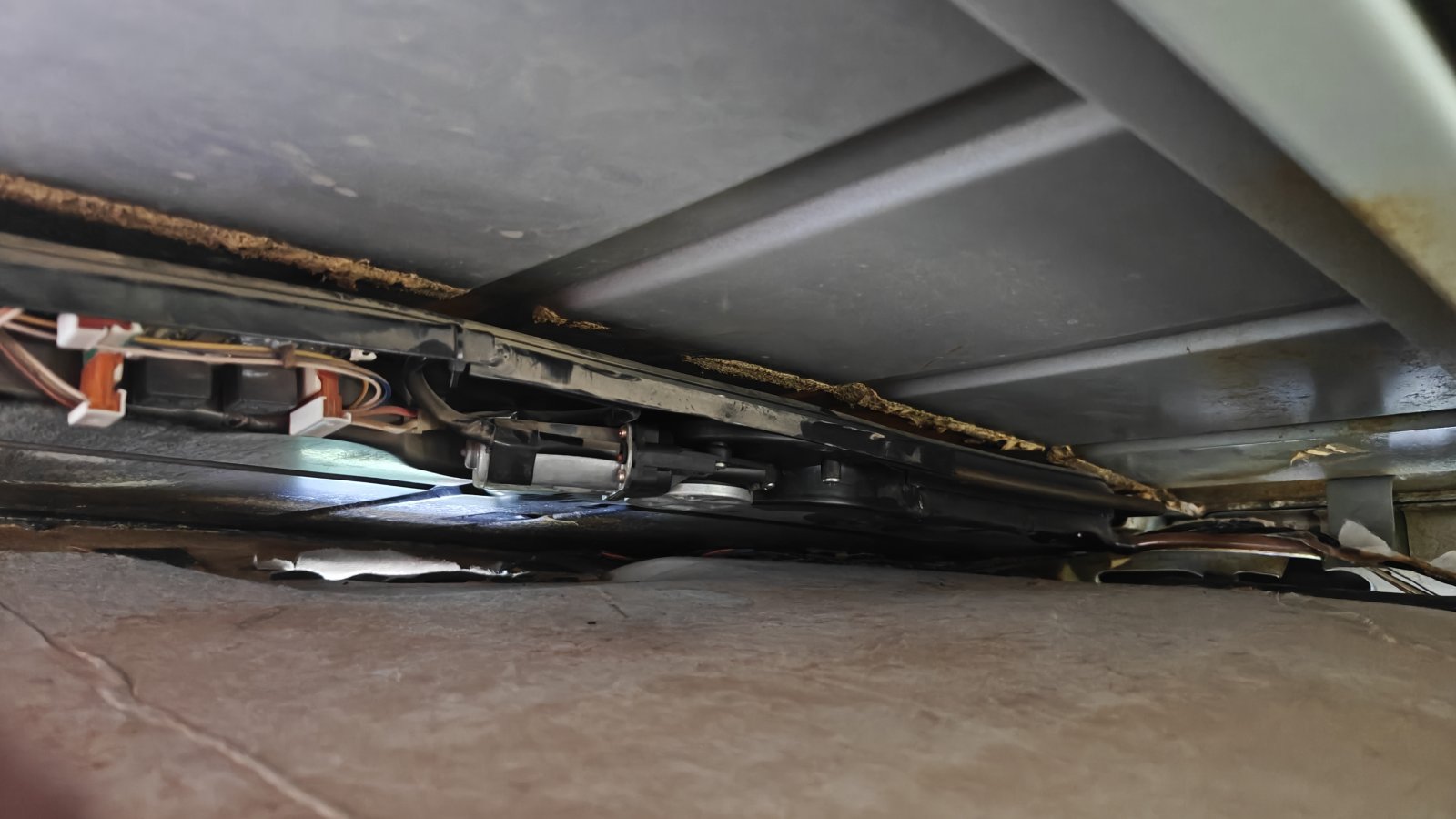

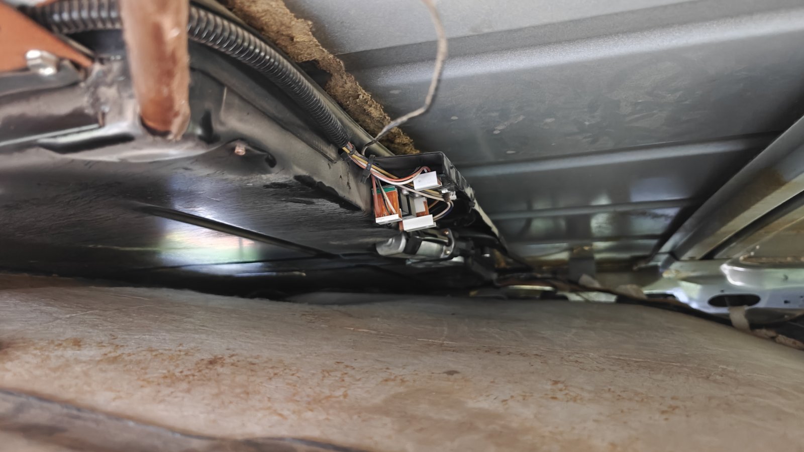

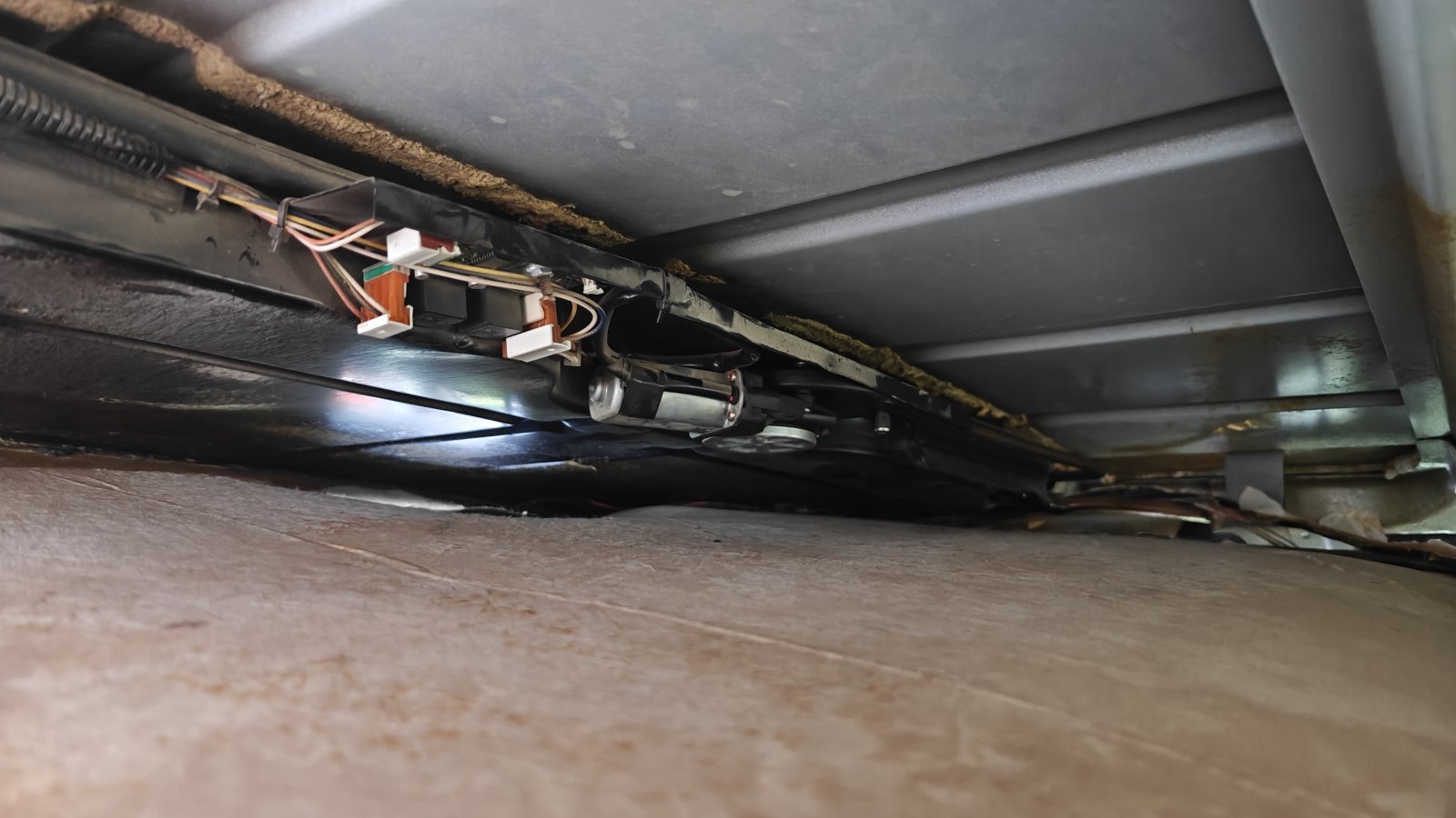

I have the headliner pulled down behind the front seats right now. The best access is on the driver's side.
Jobi-Wan Kenobi
Jobi-Wan Kenobi
Aug 27, 2022
289
345
Well I at least got it to close putting battery power to the motor. It didn't close all the way though. Also pretty sure it's a Webasto Hollandia, possibly a 700 series.
