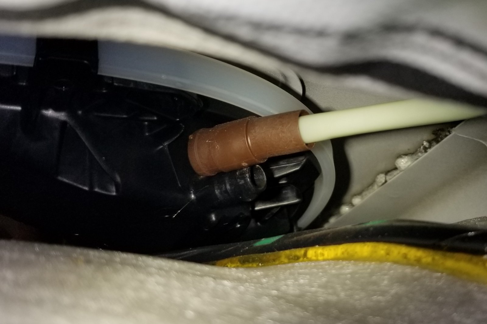

Was out with my 2013 Denali during alight rain and noticed water puddling in the passenger foot well. A little investigation revealed it was coming down
the A pillar. When we got home I pulled off the upper door trim and a pillar trim panel. There was water on the body under the cover. On a hunch I pulled down the headliner and put a small flashlight up there. Sure enough, the drain from the sunroof was pulled off. Not sure how long this had been the case but the leak had never happened before.
Good Catch... Good Picture. This should help out a lot of people..
It's common on a bunch of diff models !
