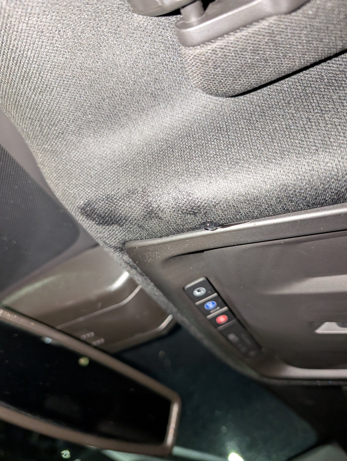

Hey, I'm opening this thread back up because I'm experiencing a water leak into the headliner of my 22 Yukon. BUT I DO NOT HAVE A SUNROOF!
Water accumulates in front corners of the overhead console area of the headliner and will saturate the headliner and pour/drip out of the plastic console panel edge.
Any ideas where to look?
