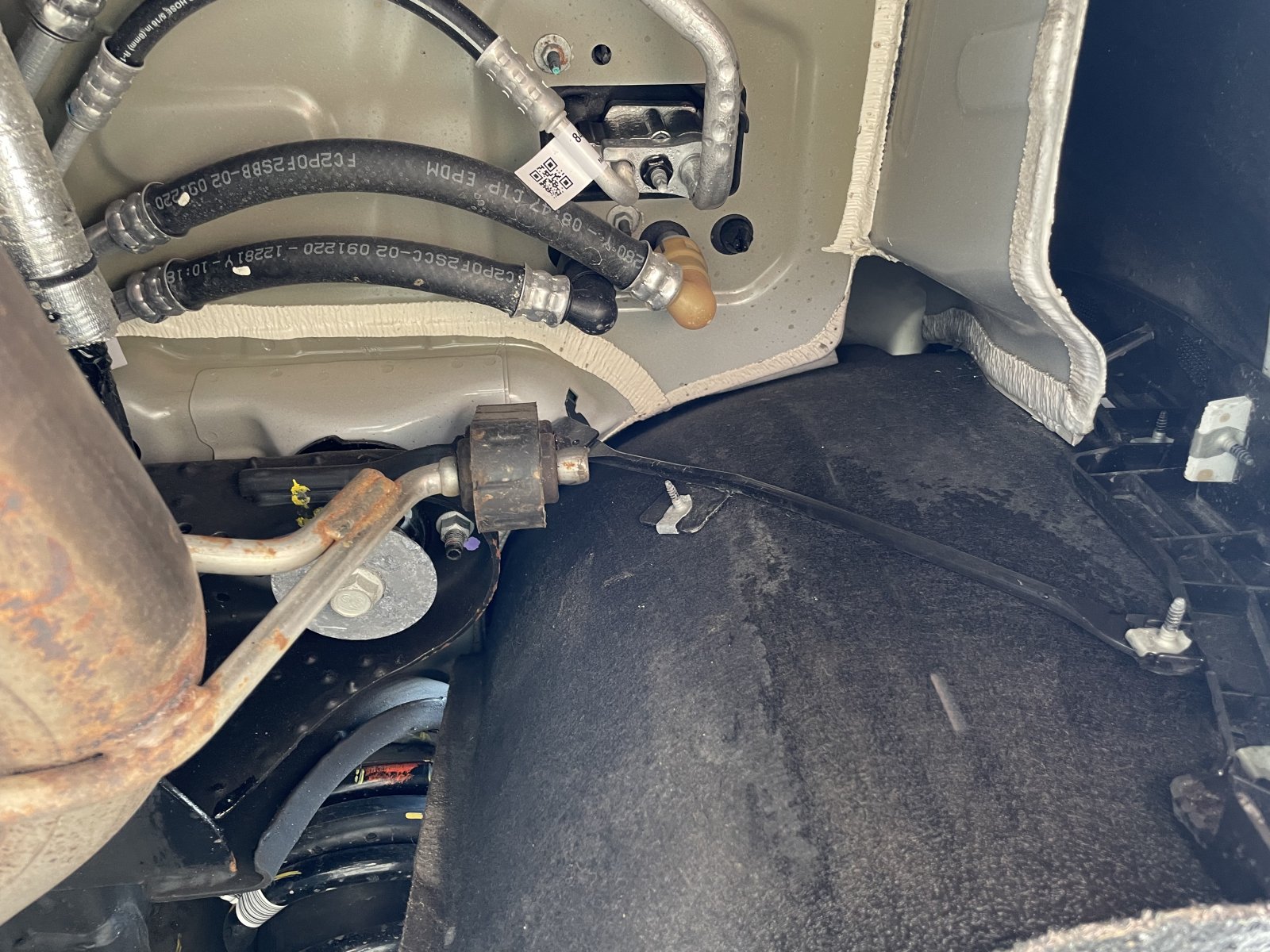

So I can't figure out what this is but any suggestions would help. Randomly today, the wife calls and says I can hear this sound and it's under the brand new yukon. I said well watch your gages and I will look tonight. Flashforward till dinner and it happens again. So I crawl under it at outback to see this drip (picture attached). All the levels appear to be normal from a quick check also. What in the world could be leaking down to what I would assume is the y-pipe. Also is the y-pipe if that is it really suppose to look like that? Thanks in advance but dinner wasn't going to be the same till I asked someone. Lol

If it’s clear and dries on the pavement and the A/C or defrost was on, then it’s probably drainage from the AC condenser.
My ‘21 Tahoe makes a sizzling noise when I park it after running the AC which seems to be normal from another thread on here. Looks like it’s dripping mead the same location on yours.

Tnyukon21
Jul 30, 2021
Thank you for the lead! Driving me nuts and couldn't find it but didn't really know what yo call it either.

Yup just got home a while ago and was taking stuff out the rear and heard the sizzle. Had heard it previously from front passenger right below the head unit but today noticed more of the sizzle.

Wipe it with a white cloth so we can see the color. Does it dry up or stay a droplet on a cold pipe? That will help determine if it's oil or water based.
