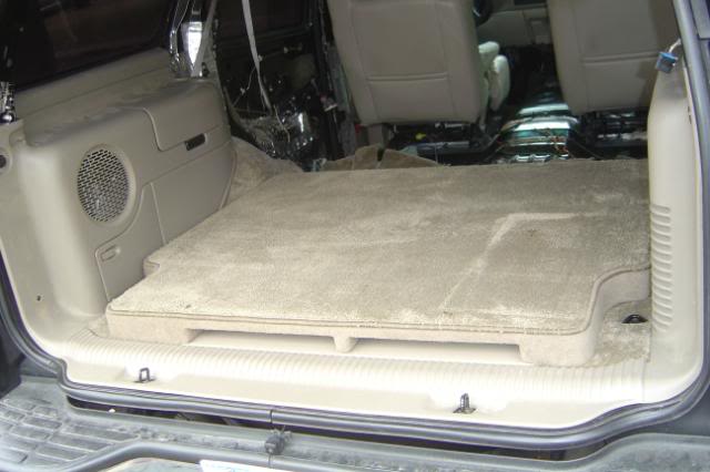

Heres a pic of my custom made box. Cant really put anything else back there. If i have to use it, i just undo and it comes out..

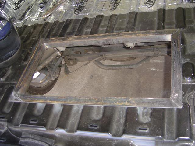

JK did you cut a hole in your floor or something? I cant pircture how you have the subs in like that with enough mounting height
JKmotorsports
Rollin the boosted grocery-getter
Apr 29, 2009
2,417
157
Austin, TX

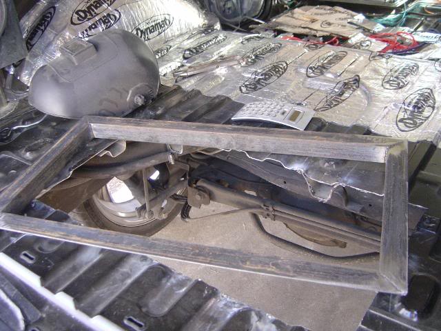

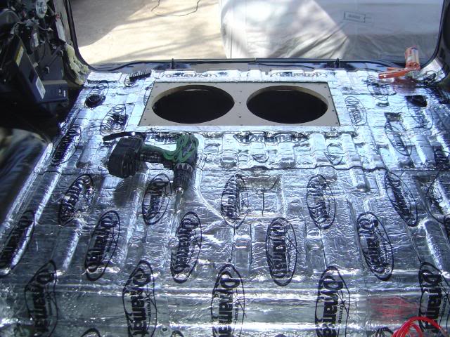

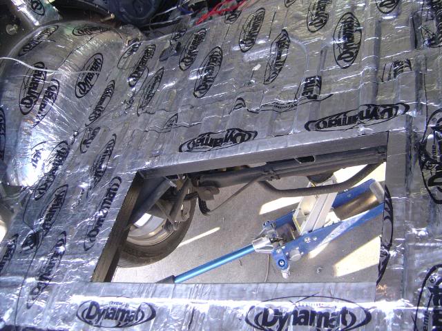

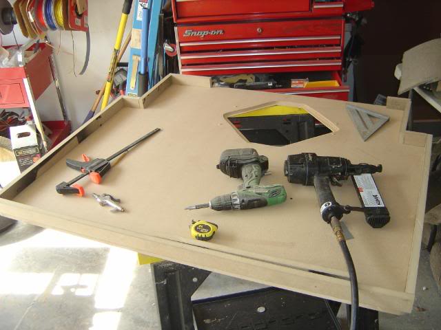

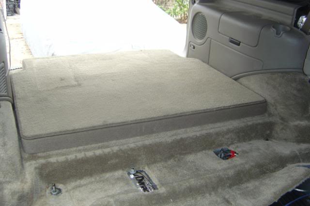

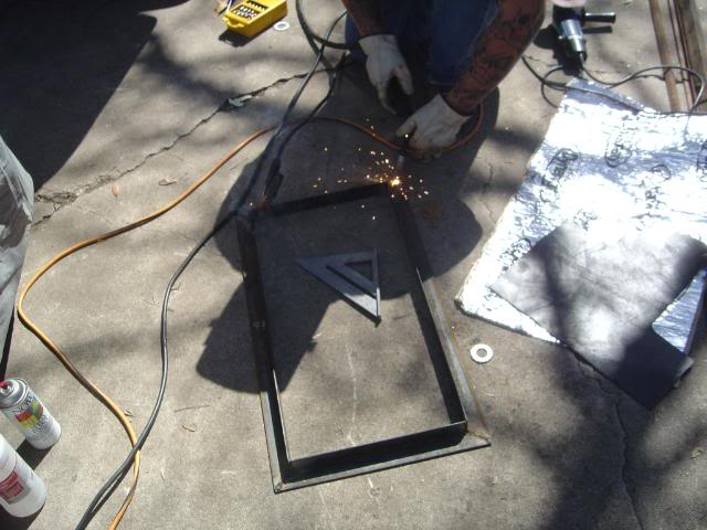

Cut out an opening in the floorboard and welded a metal frame/housing for the sub enclosure.
You may notice the enclosure is off center a bit. Had to do this because the fuel filler neck to the gas tank ran down the driver side and it was easier to just offset the enclosure rather than modifying the fuel filler tubes.
Without and with the stock cargo mat:

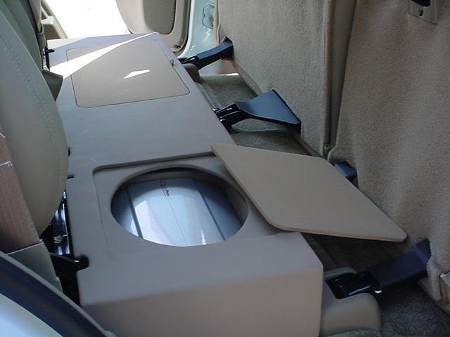

And if you want a place for the amps, here's a pic of an amp rack I built underneath the 2nd row. I used speaker grille cloth for the removable covers so any heat from the amps can escape:
