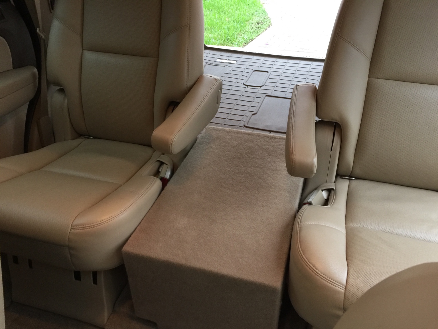

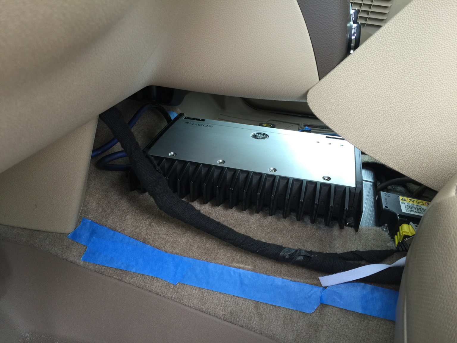

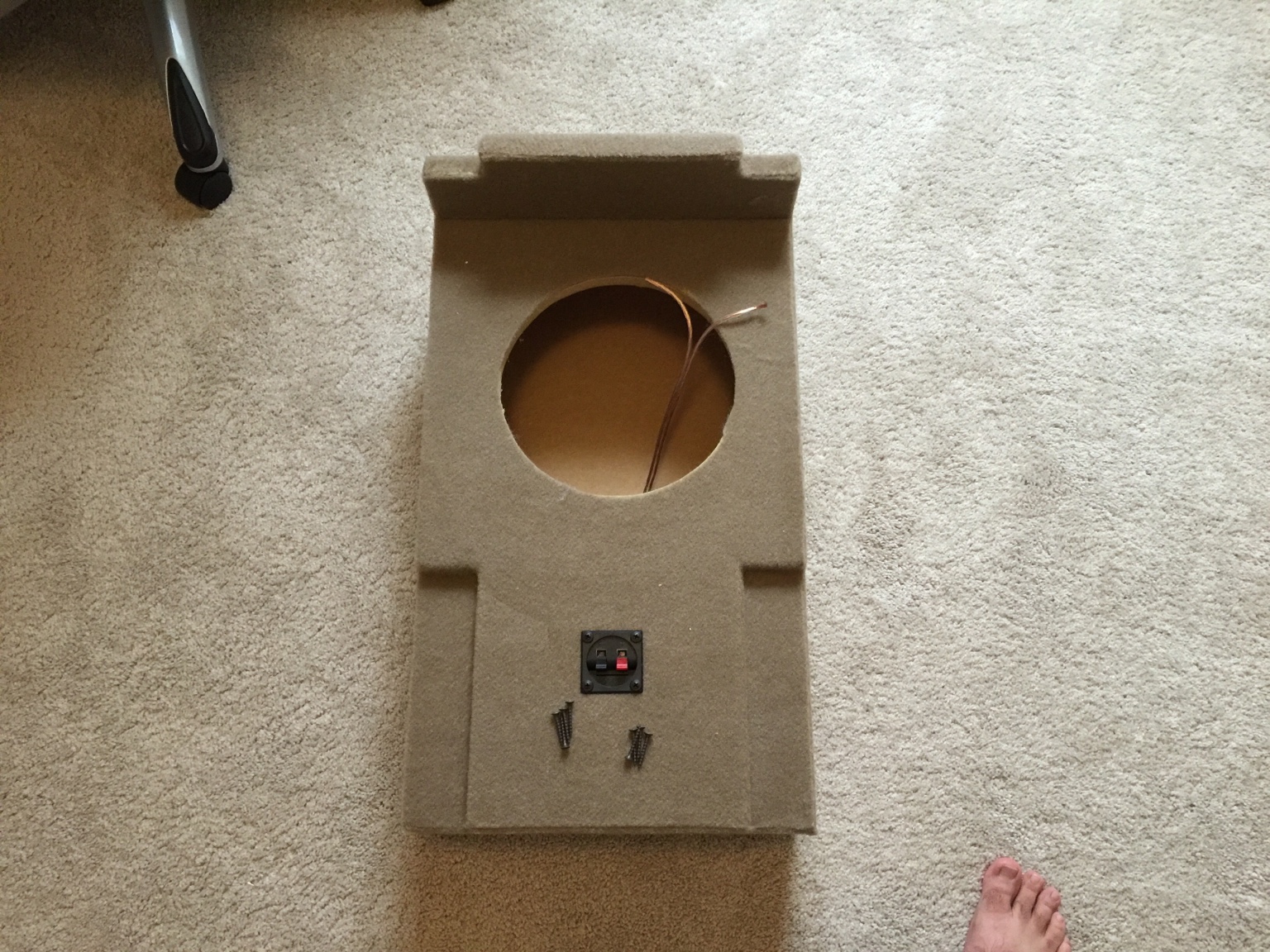

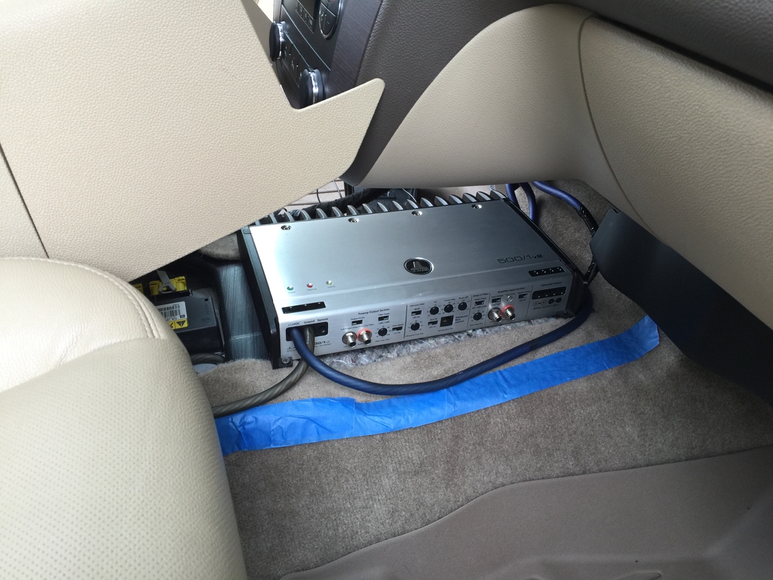

I used my JL 500/1 amp and hid it under the console where the stock bose sub was mounted.(Note: this is not a small amp and I still had more space.) The box that I purchased (http://www.ebay.com/itm/2007-to-201...subwoofer-Enclosure-Box-Console-/221236119840) mounts directly between the two power captains chairs. I must say that Rodney makes a quality box for the price and he is a great guy! one thing that is going to be crucial to your success is the AudioControl LCi2. This thing is going to write all the wrongs done by the Bose system.
I will post up some pics now and let the questions flow.. I am more than happy to walk you through the install. There are some things i am leaving out but i assume that they will come up as questions and i can answer from there rather than rambling.

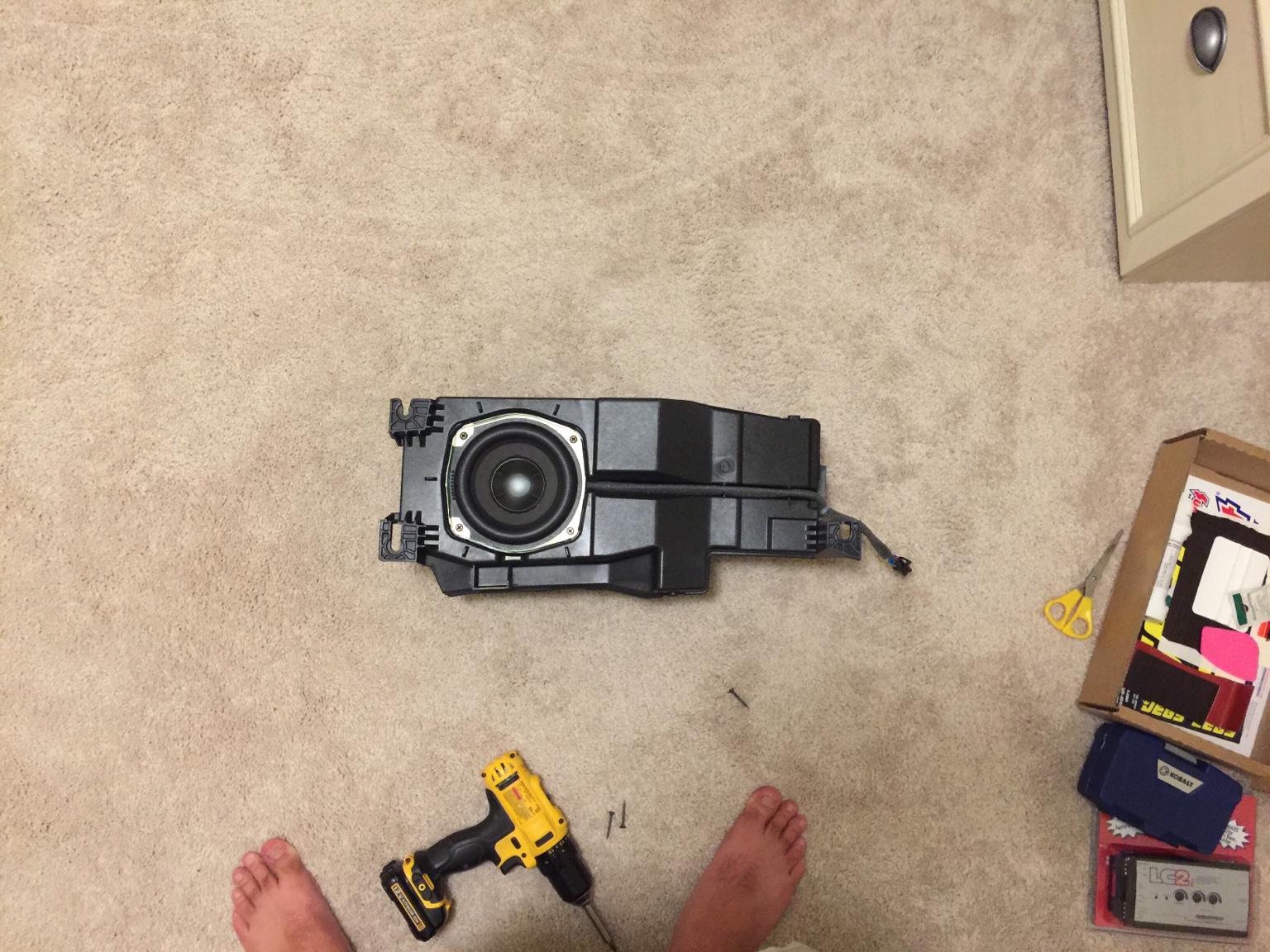

Here is the cute little guy that Bose thought would be sufficient.

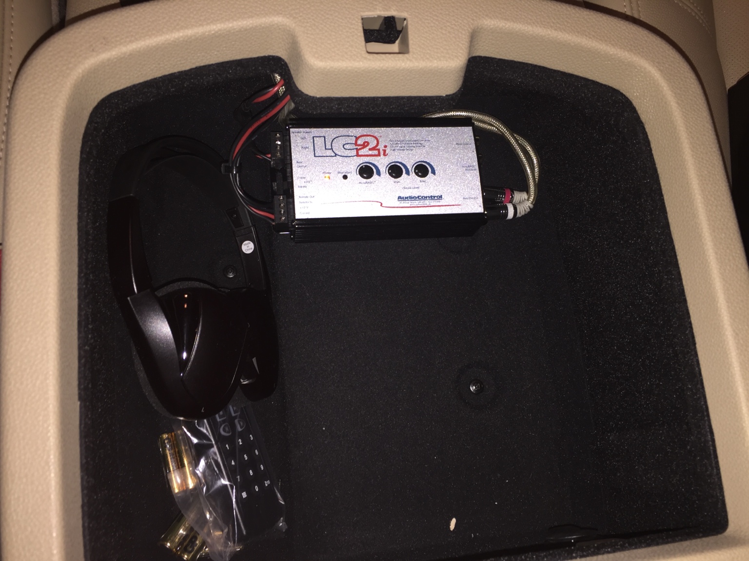

LCi2 in center console storage for fine tuning sub or turning off on the fly. Very important in my opinion.

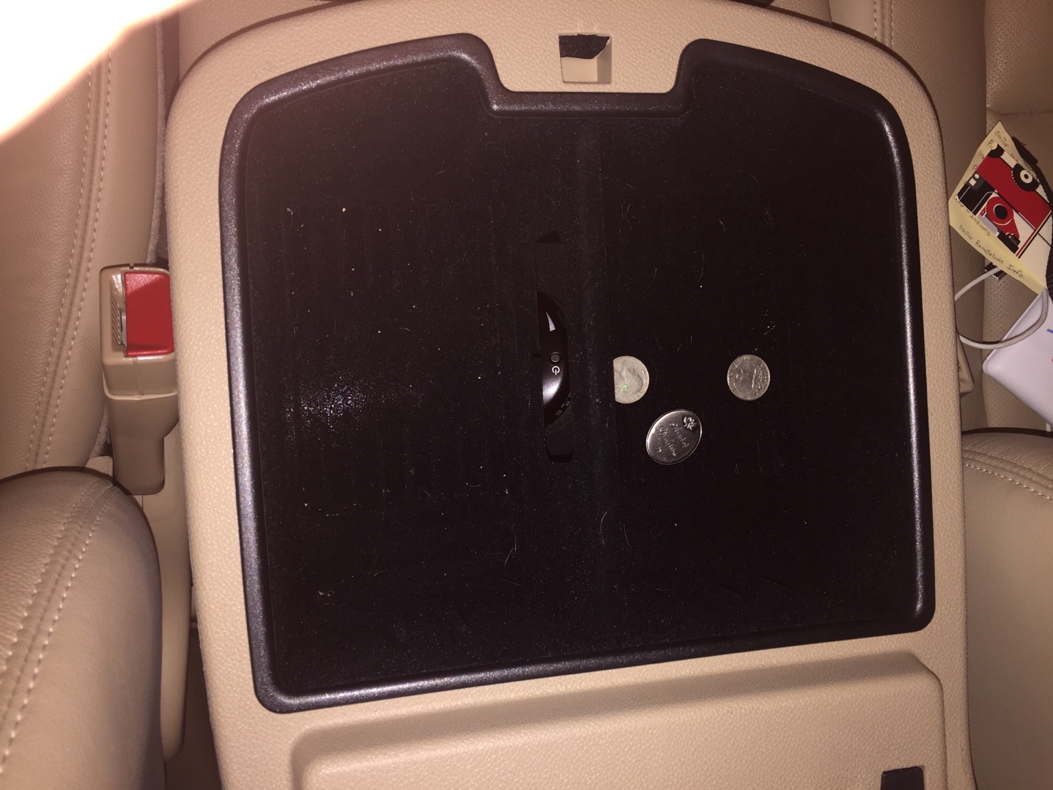

Can't even see with organizer in there

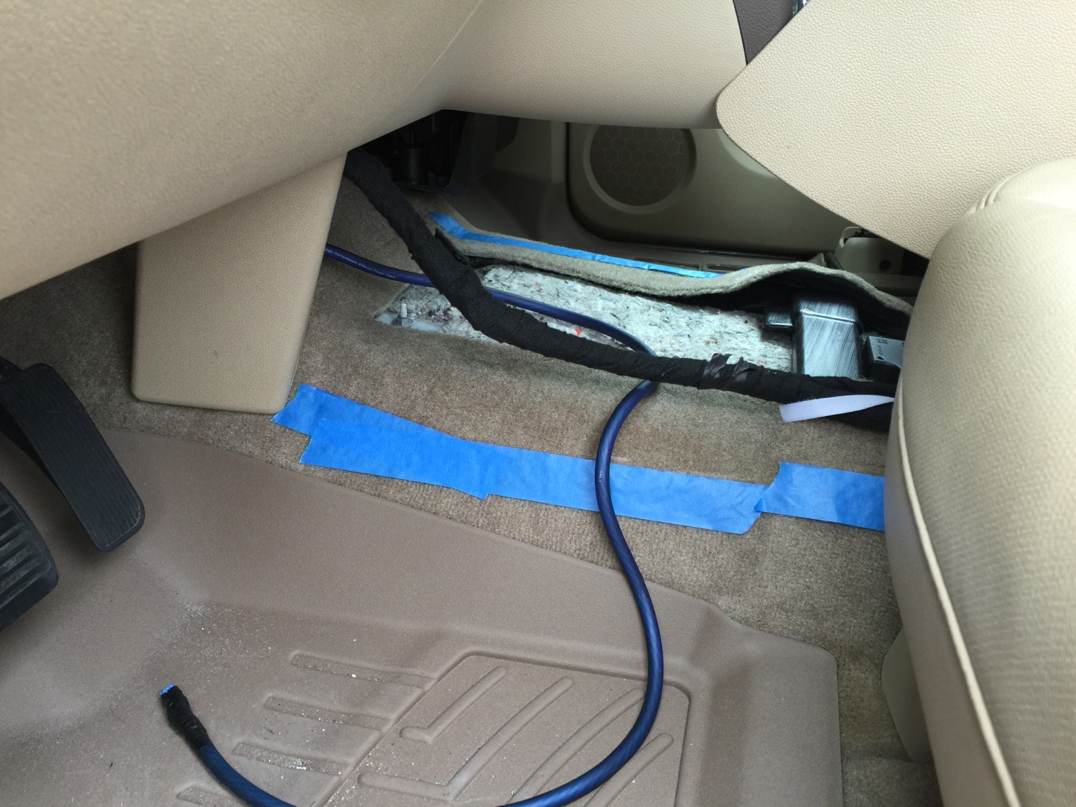

Will you take a pic of the stock sub wiring harness you tapped in for the LOC? Just wondering which wires I need to tap in for the signal. Where did you come through the fire wall for your power wire? Thanks!

Why the tape around where console was? Is it just for reference when mounting stuff so you know where your working within? I didn't tape but can see the lines in the carpeting. Hoping I didn't make a mistake there. About to drop a jl 900/5 in the same spot. Did you just screw the amp into the floor? Thanks and looks good man. If I didn't have hybrid and had captains in back would do exactly this.

Mcopco, Yes the tape was just for a reference point. I mounted my amp to the plastic vent that runs through the center console with screws. May not be the best option but it is very secure and worked for me.
I do not have a picture of this which I regret because this was one of my questions before I started this mod. The stock Bose sub is a dual voice coil so it has 4 wires connected to it. When you take out the sub just take the wires of the subs terminals and test them for signal. I used the solid color wires not the striped. I connected the wires to my LC2i using crimp connectors and spare wire. I hope that this makes sense, if not just let me know and I can explain further. Maybe even pop out the cup holder if needed.
Thanks.
I just got mine in over the holiday weekend and haven't even secured it. It doesn't slide much but certainly not safe of I had to do some evasive maneuvers or was in an accident. The vent is a great idea I don't want to screw into the car really.

Just wondering about where & how you brought the power wire through the firewall. I really don't want to drill any holes in it.
Also, is there a write up on removing the center console?
I'm going to try & build a similar box & it seems like removing the console will at some point be helpful for wiring everything together.
