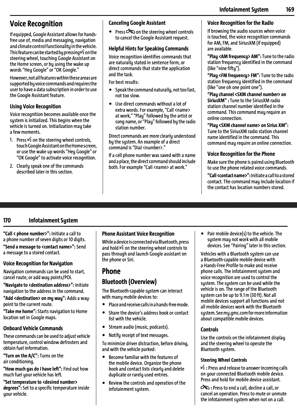

I’ve been playing with the voice commands also. I wish there was a cheat sheet with the key phrases.
Right there on pages 169 and 170 in my 2022 Owners Manual:
WalleyeMikeIII
Feb 22, 2022
2,765
2,631
Sunny and Snowy Minnesota
"Tune" has worked on nearly every previous GM product I've owned (They told me up front on my '15 Sierra Denali not to use the voice recognition software because it was awful. They were right!)
Now all of the sudden "Tune" gets changed to "Play"
Engineers... They're not happy unless their changing something.
Mine is a GMC, but I have a salesman buddy at the local Chevy/Cadillac dealer who says "Give it a year & they'll probably change it completely again" I believe him...
Because GM didn't design or implement the Google Assistant, which is what now has control over your vehicle...they just made the rest of the car contollable by it.
If you have a google phone or google home device or iPhone or AirPod or Alexa, "Play" is what you say to these digital assistants...
