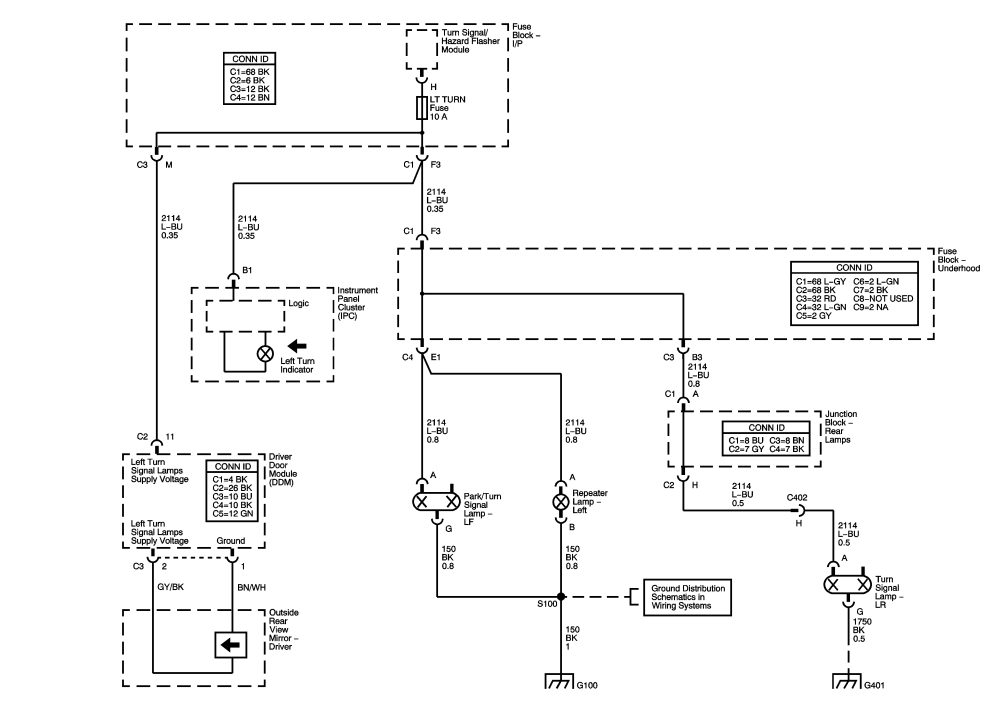

Only thing I could find common to the left front and rear turn signals is their power feed between fuse block connection a terminal F3 of the Instrument Panel fuse block and the Fuse Block under hood terminal F3. Sounds like one of those 2 points is corroded or broken wire occassionally making contact when stuff works. Flash module is common to both turn signals and the one on mirror so if the module were bad then none of them would work at all. When the indicator on the dash flashes along with any working on that particular side also flashing that means there is atleast one bulb electrically open (AKA Burnt out) OR a wire leading to one or more is broken OR a terminal along the path is corroded OR the bulb socket itself is corroded. All of these would be an electrical open.
What I would do....when the problem arises, goto terminal F3 of underhood fuse block and see if 12v is there on and off. Probably wont be since on the other side of the fuseblock terminal E1 is where both left front and rear turn signals are fed from and Y is there. Then work your way back and see where it is and isnt. My bet you will have to pull the fuse blocks and you will find corrosion, especially the one under the hood. Not uncommon.

Basic first step put a test light on the socket of front or rear bulb when turn signal is on and not working.Do you have power -Do you have ground should take 30 seconds to test.IF not let us know.If not trace pwr or ground back form there rockola1971 was nice enough to print you the exact pic you need to trace it.
