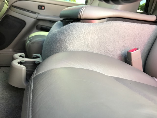

I also have the JL Stealthbox under the center console up front. A bit pricey but very nice IMO. Retains the console up top but ditched that jump seat. We screwed the 2 cup holders back in.
I had mine delivered with light grey carpeting to match the interior and it is bolted down with the front seats so it cannot be stolen or seen and the sub is down firing.
I did this and will probably fit out the rear cargo area with a second sub in that OEM box so I do not have a free standing box taking up space or inviting the hard core window shoppers if they can see thru 5% over factory. Lol

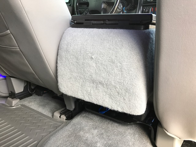

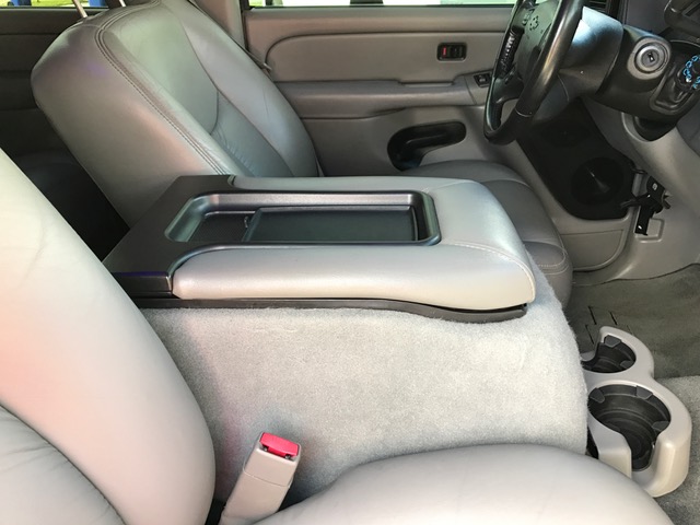

Here are a couple pics of my JL Stealthbox installed (10W3v3-2 Subwoofer). I am pretty happy with the output. It will hit when it needs to. It cannot compete with some of the other setups on the TYF, but again I did not want a separate box, wanted to keep it OEM looking and not take up any extra usable space in the interior if it wasn't behind a panel or under the seat where my JL Audio XD700/5 Class D 5-Channel Amp is located.
Pricey yes, but nobody was ever going to sit in the middle of the front seat like I did in the older days straddling the transmission hump next to my dad. :)

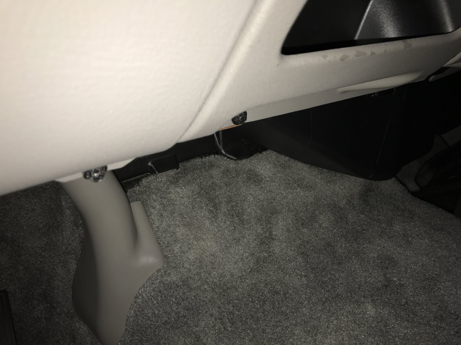

Plus I think you have open heater vents there right ?
Fosscore
Apr 16, 2014
10,885
19,845
I love the ideas that come up on TYF each day. Guess I'm too OEM or conservative on some things, but appreciate the thought and creativity.
Yeah there are 2 heater vents as you can see here.

Was the same way in my 2500HD. It originally came with the jump seat and I bought the ducting that goes under the front seats and put that in when I first switched to the center console. It worked out too because even though I had bought a Bose console when I did my full interior swap from a donor truck with the JL Stealthbox you can't use the center console vents like the Bose trucks have.
Basically if you want to switch up to a center console it'll only cost you a few bucks to get one of the ducts and it just pushes into place on the floor under the carpet. I also opted not to buy the glove box that matches the center console and cut mine to fit saving about $100 and it looks/fits better than the OEM one does.
