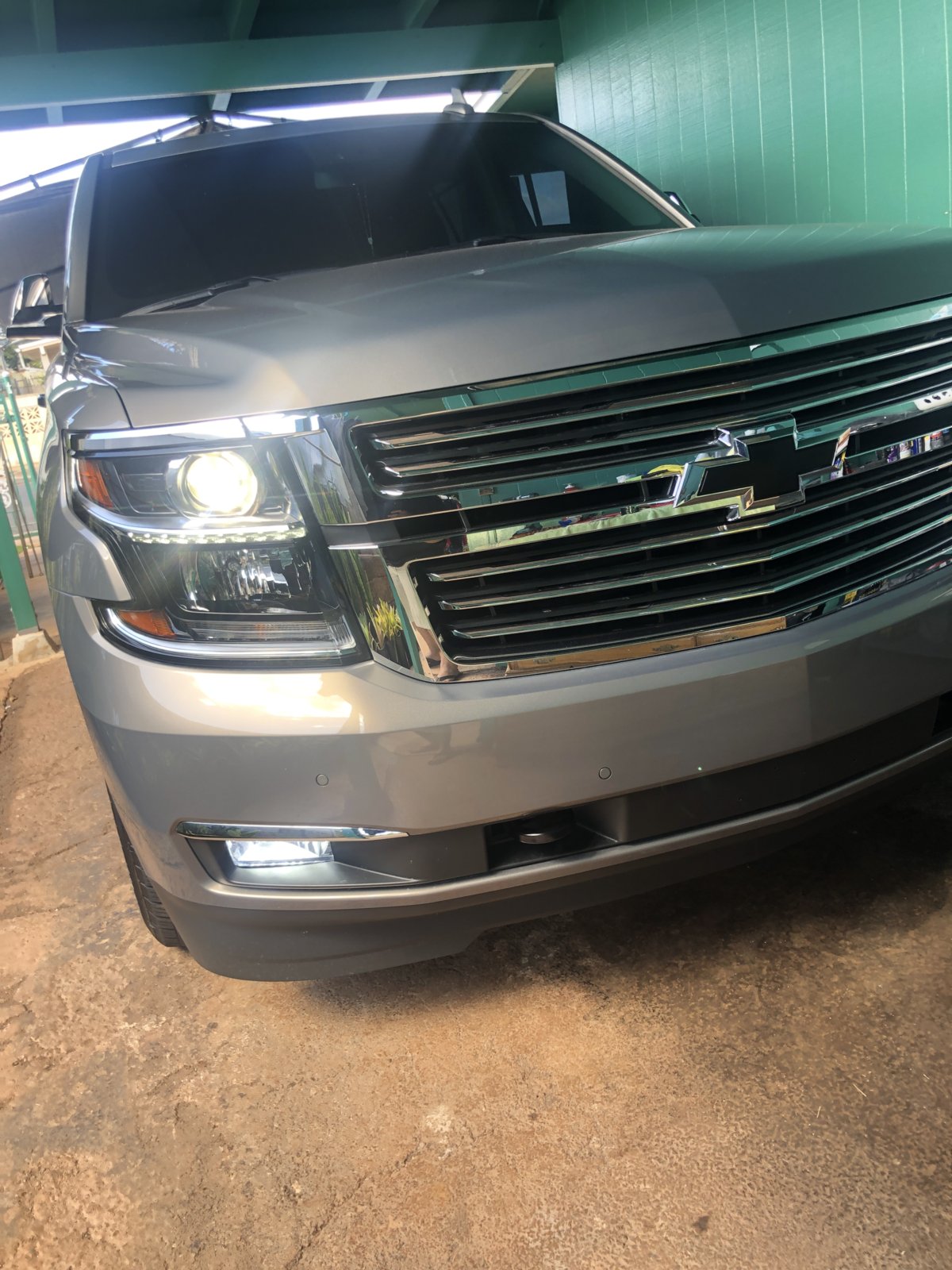

After ordering all my leds kits for my 2018 Tahoe thinking it was all the same 2015-2018 H11 for the headlights low beam as seen on YouTube but to find out it’s DS3 hid. Has anybody change there stock hid on there 2018 Tahoe/Yukon ?
I was able to change the fogs to led 6k
Looks off with the stock hid on the headlights

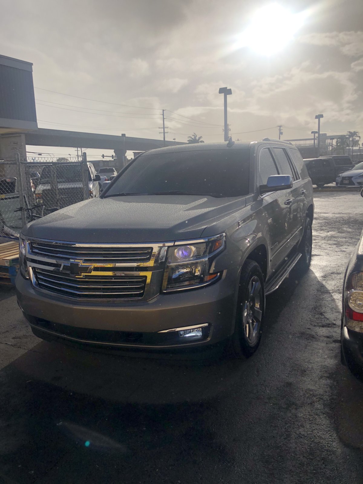

I change the stock hids today to 8k.has anybody put hids on there fogs ? I remember on my 08 Tahoe hid would melt the fog lights lens

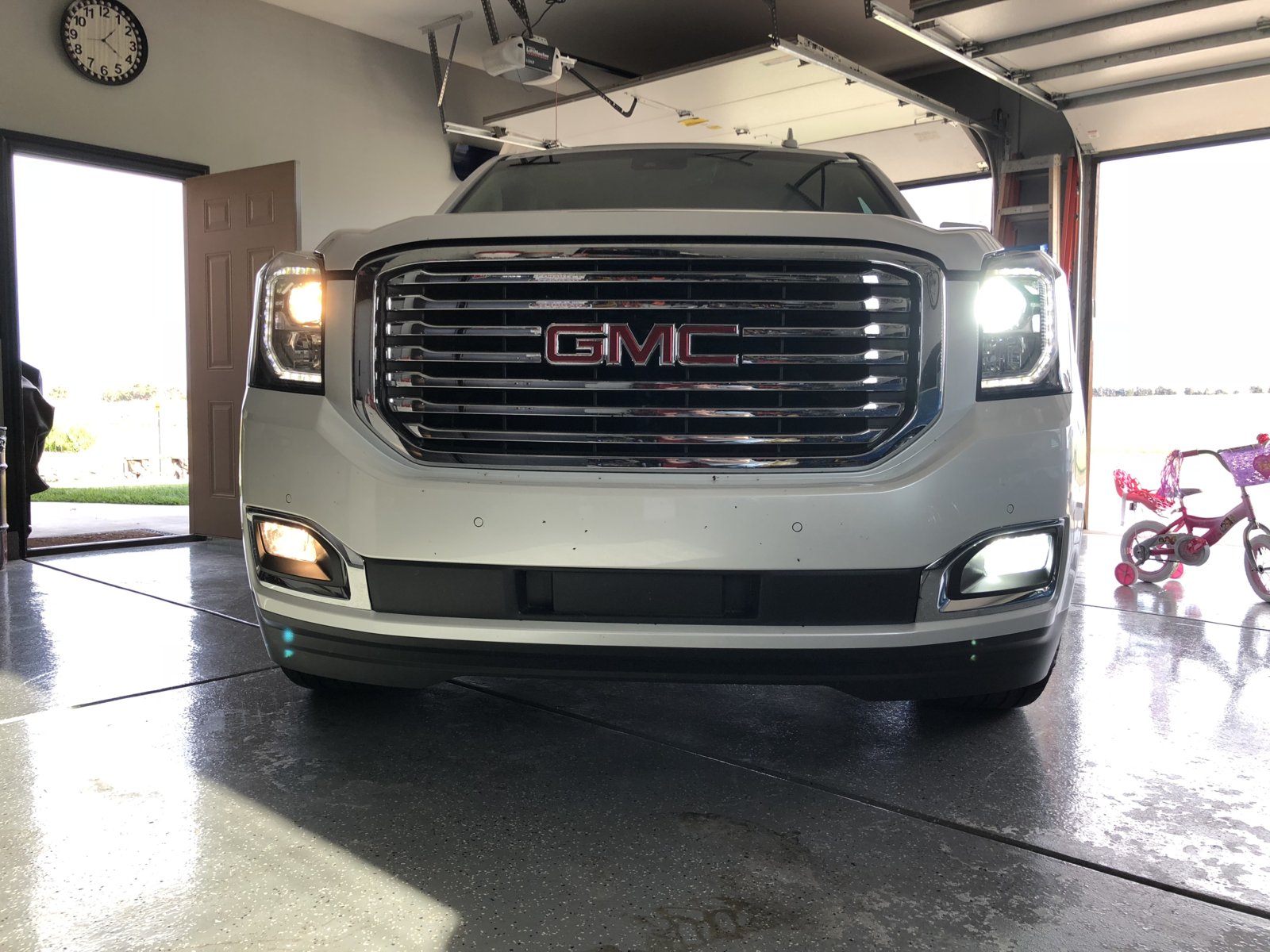

I just got a 2018 Premier. I replaced the factory HID bulbs with Innovited 5000k bulbs. $26 shipped. + 6000k Lasfit led fogs $31 (but look more like 5000k and had to re-aim the fog light housing because they were so bright everyone was flashing me). Paired up both are a very close match. Never had any issues with Innovited products. Installed a complete 55w kit im my wife’s camry 6 years 0 problems. Pictures attached are reversed so the first picture is after. Second is factory I’ll try and get a picture with both tomorrow
C413D900-863C-4103-AE01-816CF79D3770.jpeg 5F262543-7A1E-4F93-AFD8-100246AE905E.jpeg F478E412-8A95-4FF7-A914-FE52BE9184DA.jpeg 2A1FEBB0-1291-4AE2-84FA-C37C67308122.jpeg

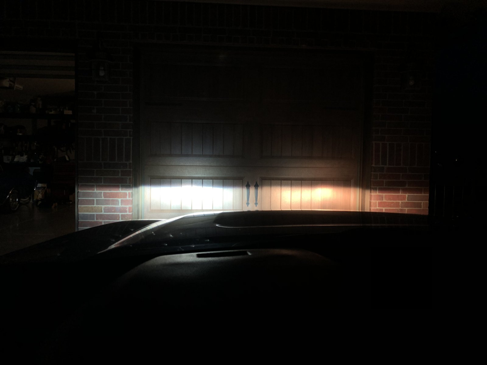

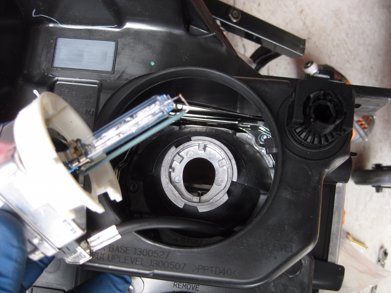

@Tiki I knew I had these somewhere. You can see the difference in the mounting holes.
Halogen H11
HID
For reference, these are the factory HID bulbs.
Sent from my iPad using Tapatalk

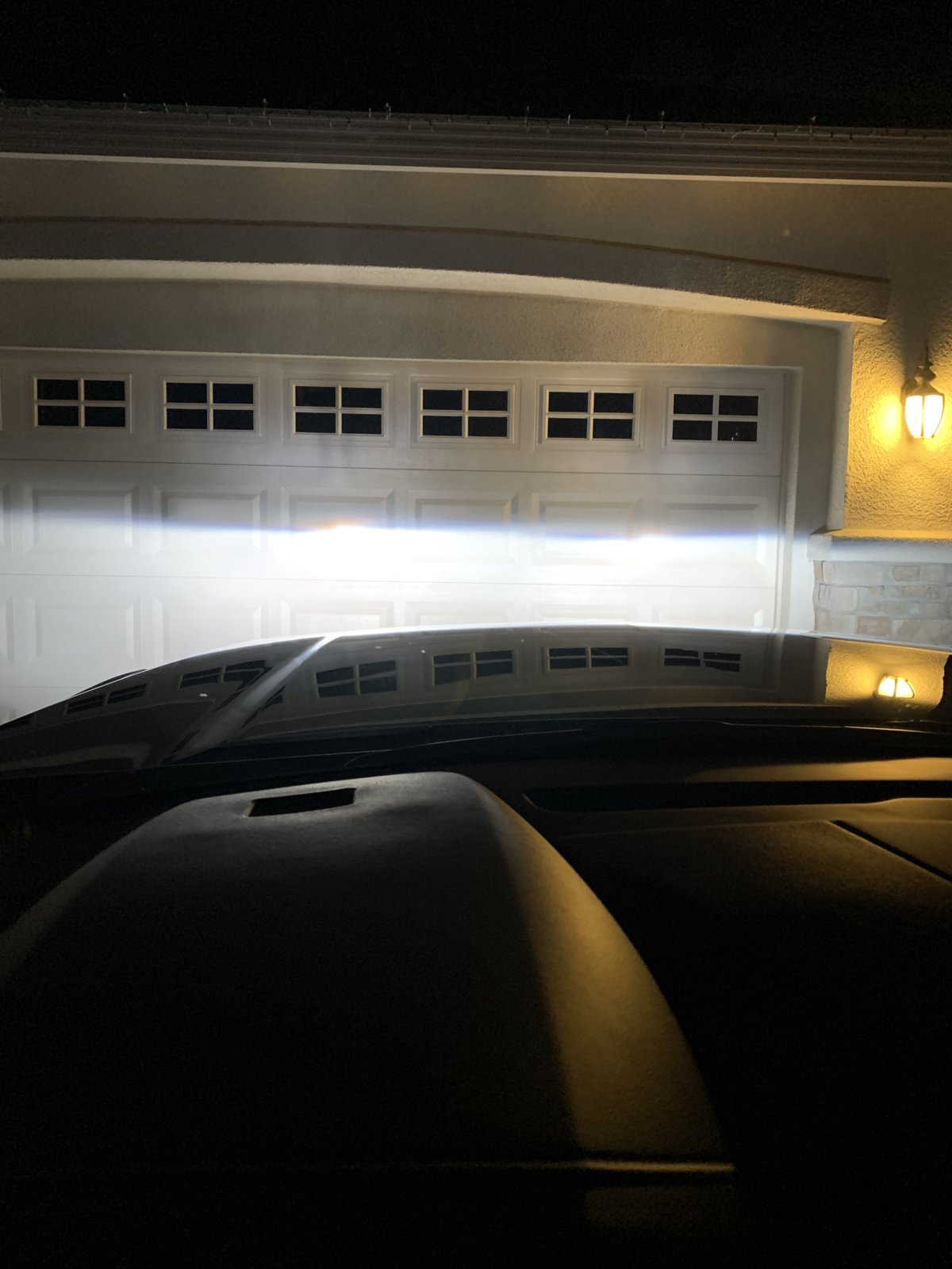

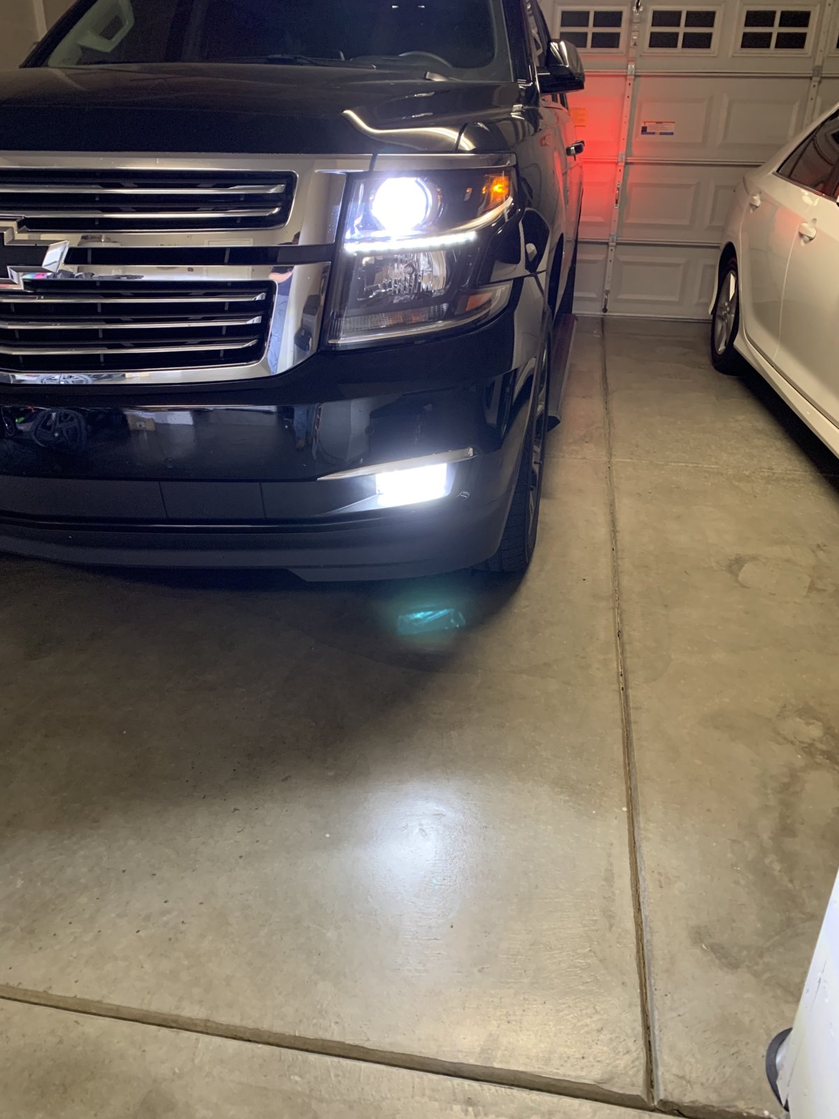

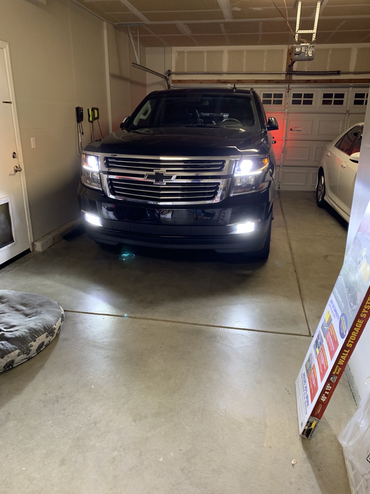

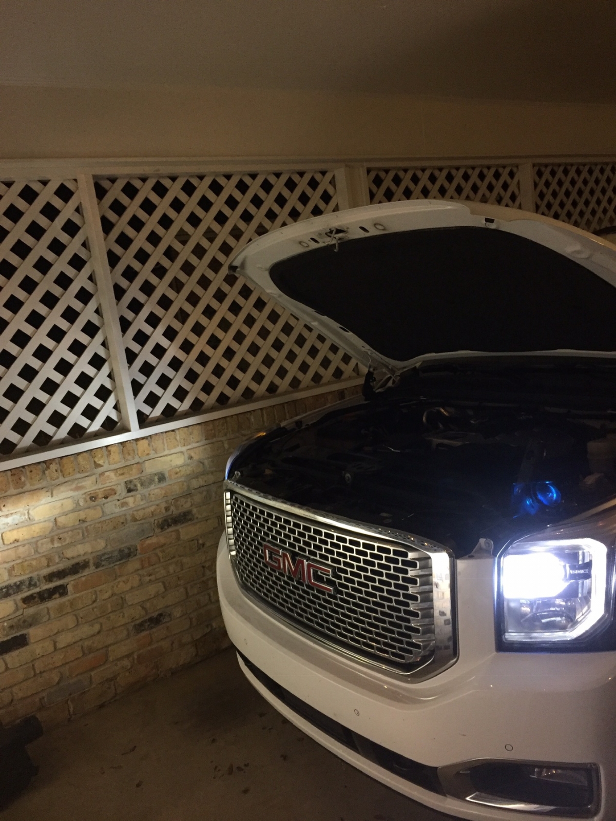

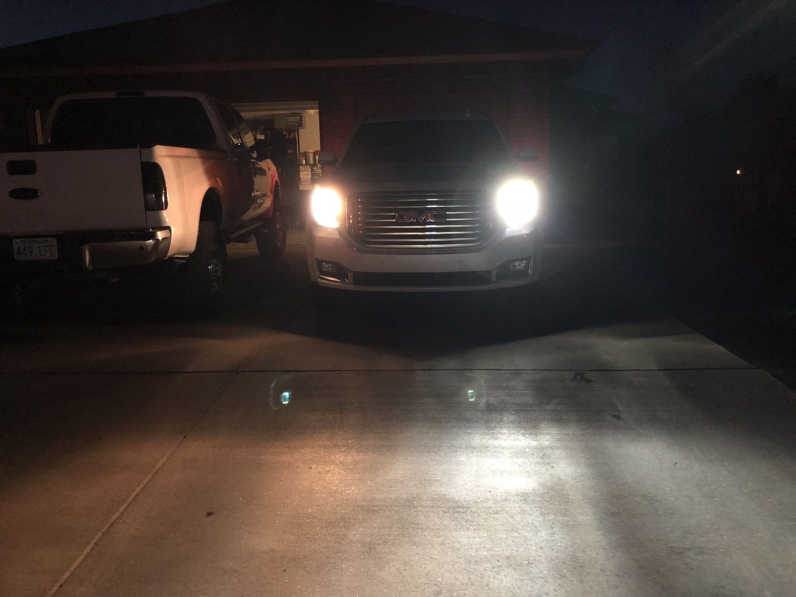

There is a simpler solution to swapping in the whole factory HID housing. I bought all an HID kit for our 2017 Yukon SLT from Vanquish Auto. Check them out. They have a quality canbus HID kit and I have been very happy with them. I also bought their 6000k LED high beam and fog light kit. In the pics you can see a clear comparison between the 6000k HID on driver side vs stock halogen on passenger side.
