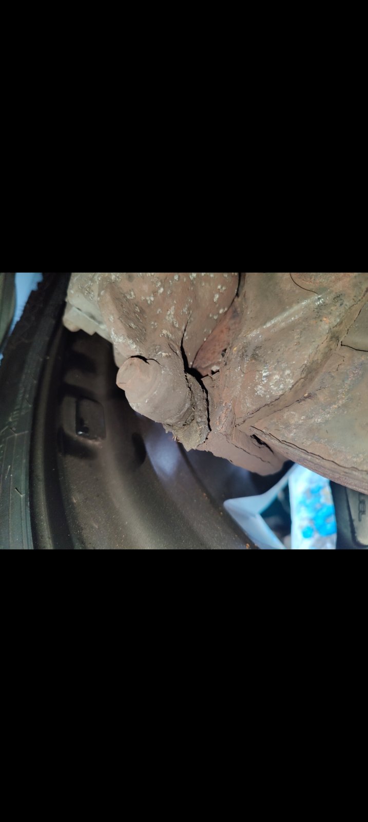

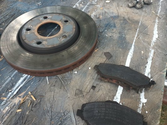

Before I get to taking this rear right caliper apart just wondering if anyone has thoughts based off pictures it looks like the rotor has wear along outer edge, would that most likely just be from the slide pin boots blown out or the whole caliper going, wheel spins freely when I had jacked up, but my vehicle is definitely pulling to the right when driving and recently started pulling left then right when hard braking at highway speed
52,954
Time to tear it apart and see what it looks like. Hard to say just from looking at one rotor. Time for new rotors and pads regardless so I’d have those parts ready if it was me. New calipers might be in order also but you wont know until you get into it.

Nice pics to tell the whole story.
It’s just an internet diagnosis, but going to the cheapest, easiest first methodology, consider an internally gummy / sticking brake hose allowing the caliper to drag.
It’s a good excuse to upgrade to braided stainless lines and still get a win if that doesn’t correct it.
10,520
15,262
As @Rocket Man recommended, tear the caliper apart and assess. Cleaning and re-lubing the pins may resolve your issue. I believe that PowerStop pads include new rubber boots for the caliper pins.

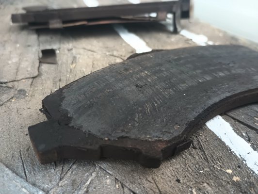

I had one on my wife's 13 Chrysler minivan just yesterday. She said it made some noise when braking. I took it out for a drive and sure enough, kinda like grinding noise on hard braking but did also get a brake overheating smell.
That van's brakes have always dusted badly. It seemed odd that just last week I had cleaned the wheels and washed it, and when I test drove it, only the front passenger wheel was completely covered in brake dust. Well, the pads on that side were literally gone! So I replaced the pair. The other side was basically at 50% life on the pads, so I know the caliper was dragging. I lubricated the pins, and will keep an eye on it.
I looked at my maintenance log and I had replaced the fronts back in 2019, and the van has only been driven 22k since then. SMH. The set before that I had replaced as well and want to say they lasted something like 35k.
Not impressed. I'm used to brakes lasting 120k+ on my GMT800s...
