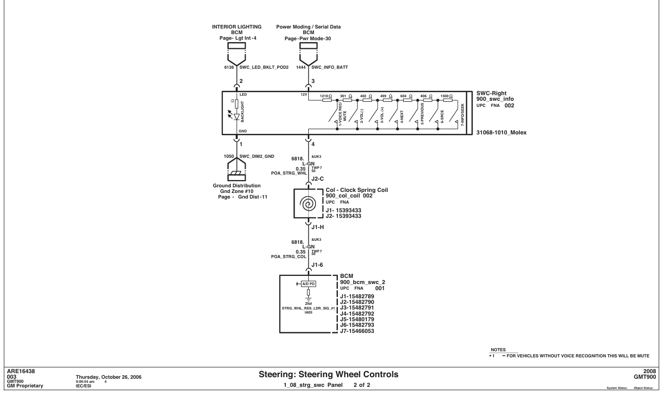

I am finally getting around to working on my 2010 PPV. I bought a replacement steering wheel https://www.ebay.com/p/12037509309 that has buttons on both the right and left side. The original steering wheel only has buttons on the left side. Does anyone know if I also need this wiring harness to make the buttons on the right work: https://www.ebay.com/itm/261842037454
Thanks.

That harness may already be on your new steering wheel?
At least that's what it looks like to me in that ebay listing..

Thank you. Yes, there is a wiring harness in the new steering wheel, I just didn't know if I needed an additional harness because my PPV didn't come with the right side buttons. I just received my Foxwell NT710 today and hopefully will be able to unlock the radio and if it works I will update this with whether or not the audio control buttons on the right side of the steering wheel work with no additional harness.
