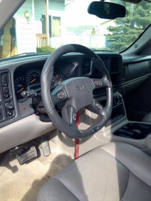

Well crap... You have the model before the model that had the Driver Information Center... Here's a shot of mine. It's a 2004 and it came with steering wheel controls and that cluster. So you have a different cluster, steering wheel, steering shaft cover, and radio. My mom's 99 Silverado has the same interior so that's how I know. And I'm sure the cluster wiring harnesses are different. Sorry I don't think this will work without doing something major..

I'm OK with a cluster swap. I want to do a set of esky guages anyway. I'd be on with building a harness for the controls. Any reason why I can't do that?
Will a newer steering fit? I mean like is the shaft the same size and spline.
Justinj360
Senior Member
Jan 2, 2014
476
87
I'm sure it's possible but there would be a lot to do... I think this is where my helpfulness stops. I know about the physical differences between the 2 kinds but I don't know about the wiring and programming and stuff. A new steering wheel would probably fit but I don't know for sure. I haven't taken an older one off before. I would imagine the shaft and splines and stuff are the same though. You might need a newer shaft cover though. Here's another shot of mine. You can kind of see the shaft cover in it. I think these ones are more square than the older ones
