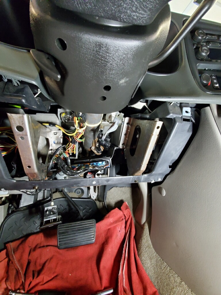

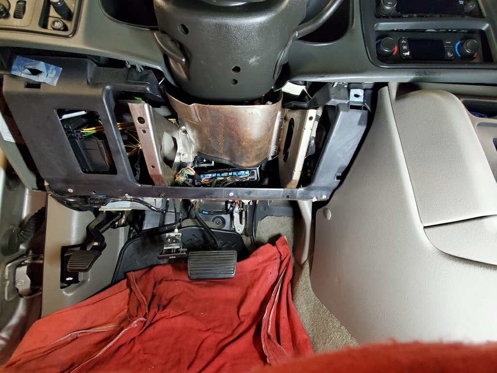

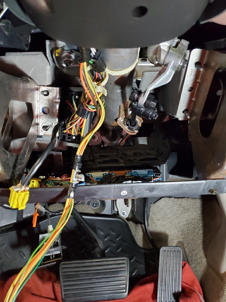

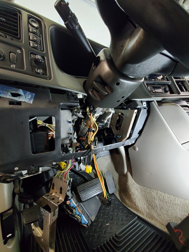

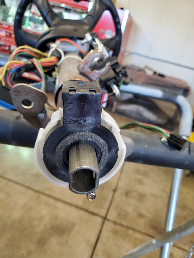

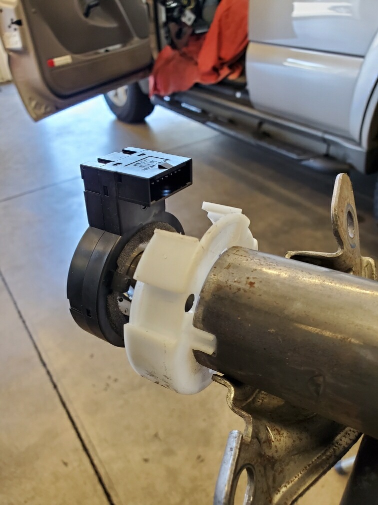

Recently replaced mine doing it the way @ivin74 described. Beer was involved too and seemed to make it go faster.

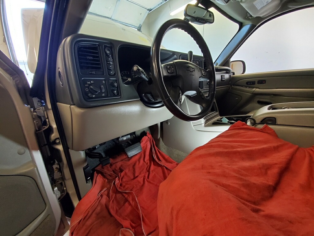

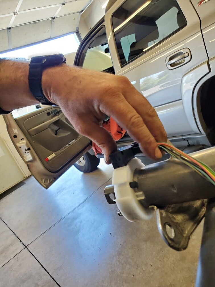

On my 2005 Z71 I just installed new wheels and tires and the wheels did not have the TPMS sensors on them and every time I start I get that message and I just clear it and it stays out till I do a restart.
In your case: sensor bad or a fault in the system. You have any codes or just the TPMS warning? If I remember right, your Tech 2 should be able to pinpoint. Others will chime in if I am wrong.

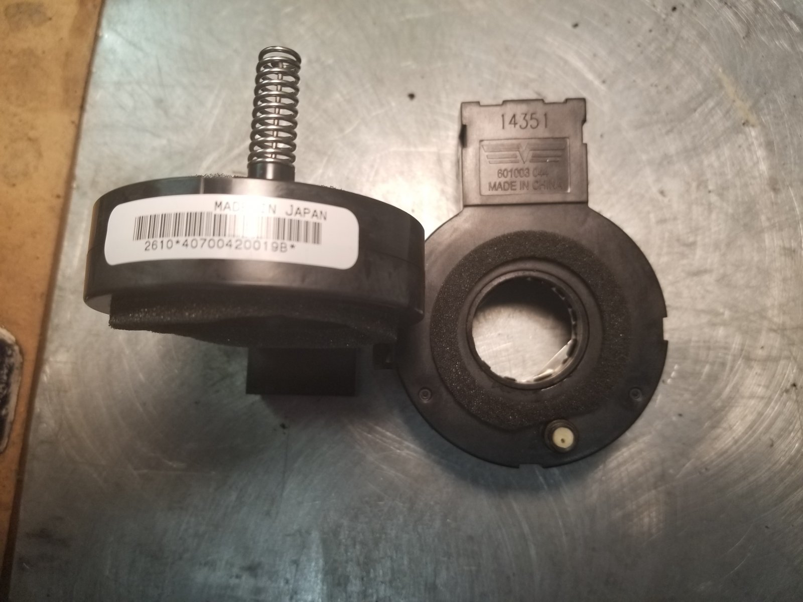

You made that look too easy! I wouldn't have thought to go the extra steps to completely remove the steering column. You're a pro for sure. So, look at these two sensors, the one o20210609_110154.jpgn the right is made in China and failed day two. The one on the left is made in Japan. (The one I installed today) So do you suppose the Chinese one was a counterfeit?

You made that look too easy! I wouldn't have thought to go the extra steps to completely remove the steering column. You're a pro for sure. So, look at these two sensors, the one oView attachment 281477n the right is made in China and failed day two. The one on the left is made in Japan. (The one I installed today) So do you suppose the Chinese one was a counterfeit?
The one on the right is a Dorman.
