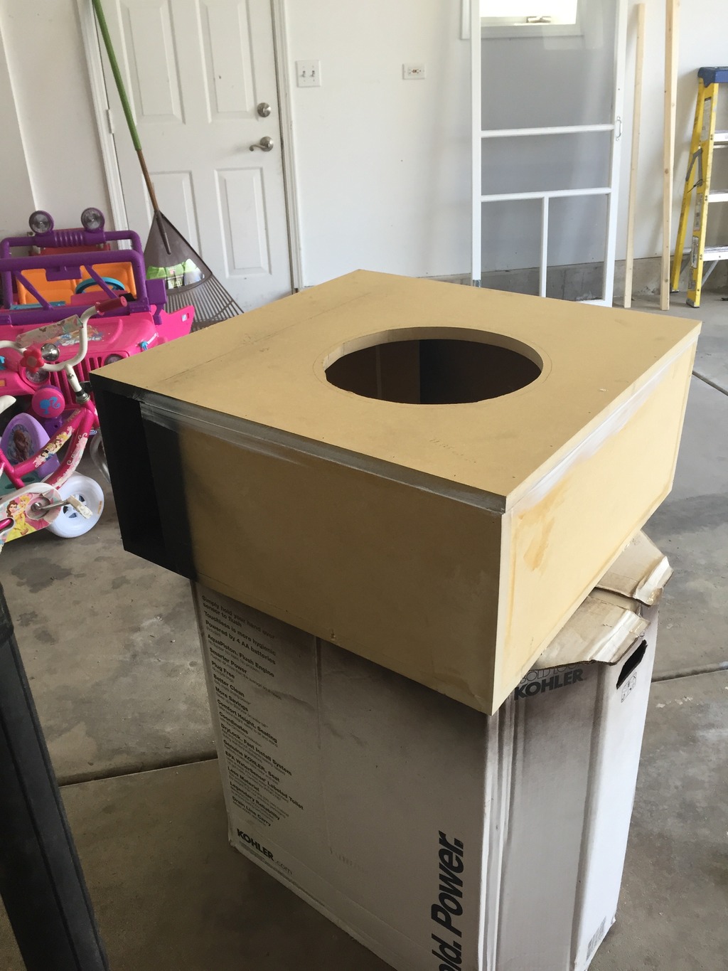

Wanted something "subtle" as in not too flashy, looking like a flea market stereo, but also wanted to keep use of as many seats as possible in this vehicle. Built a custom enclosure for my 12" Fi Q series subwoofer
Like i said i wanted to keep it looking neat so i tried to make the box look like a third row seat when in the folded position.

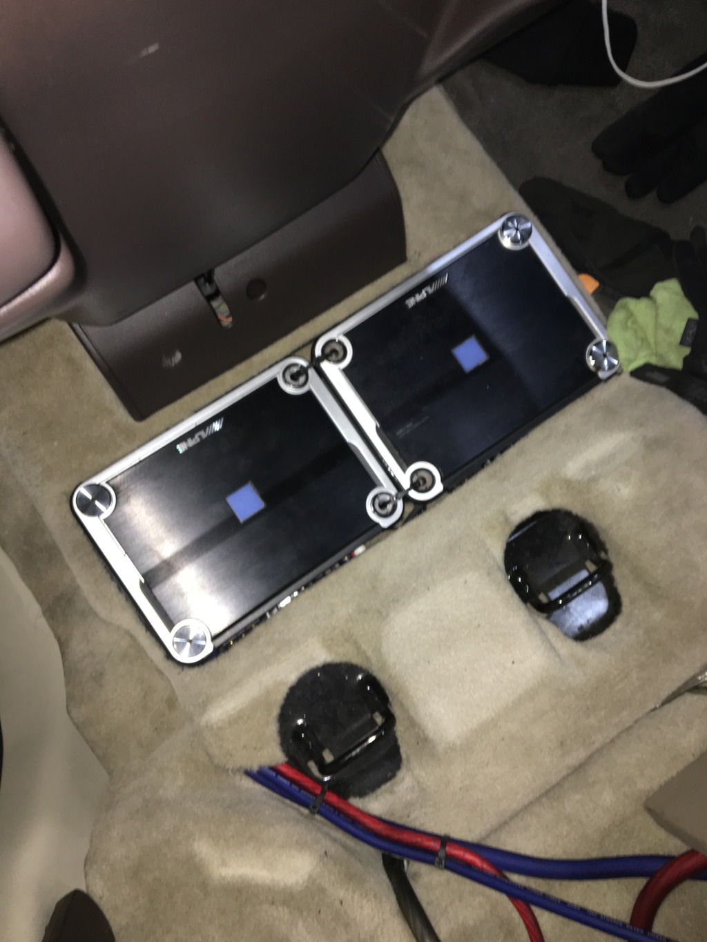

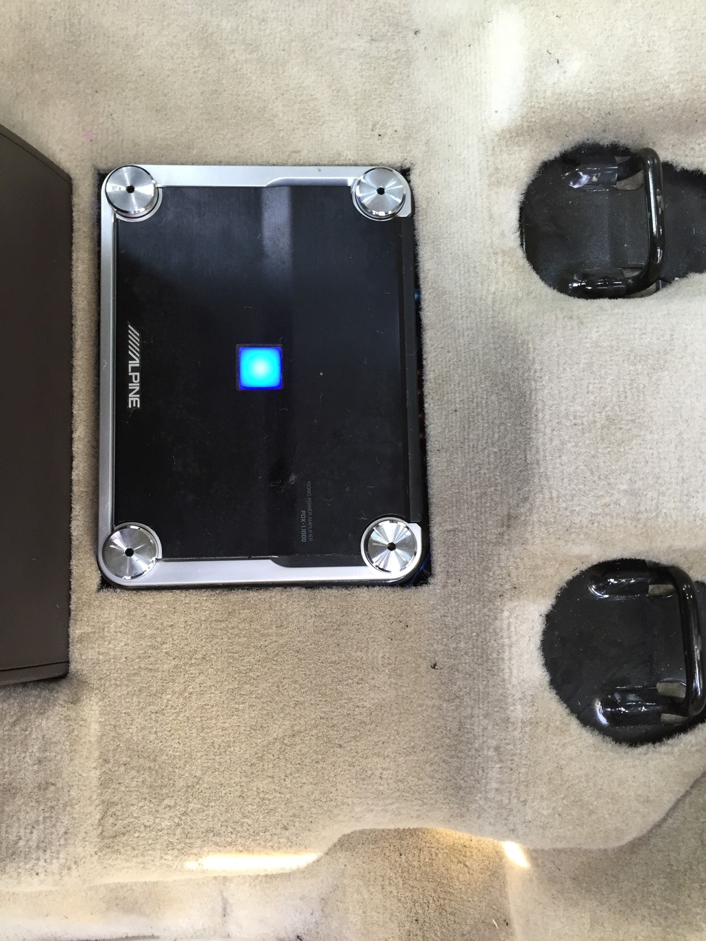

Started with the amp for the sub under the seat, 1 Alpine PDX1.1000
That ended up not being enough so then i upgraded to 2 Alpine PDX1.1000
Then those weren't cutting it, so now i have a Rockford Fosgate T15001BD, and needing a new carpet surround :oops:

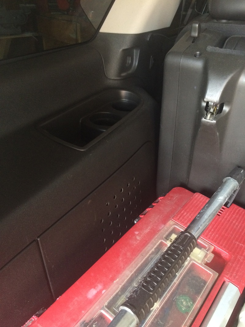

Lift carpet a little mount a mesh grill underneath on top of the plastic. Lay back over carpet. Should look cool.

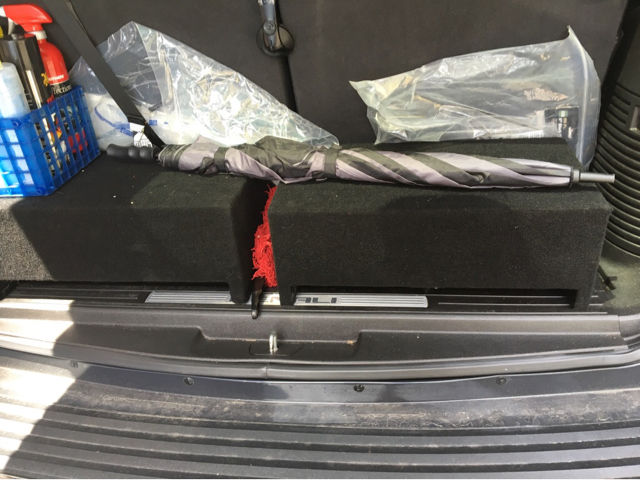

My setup. 2 shallow 10's for easy removal.
