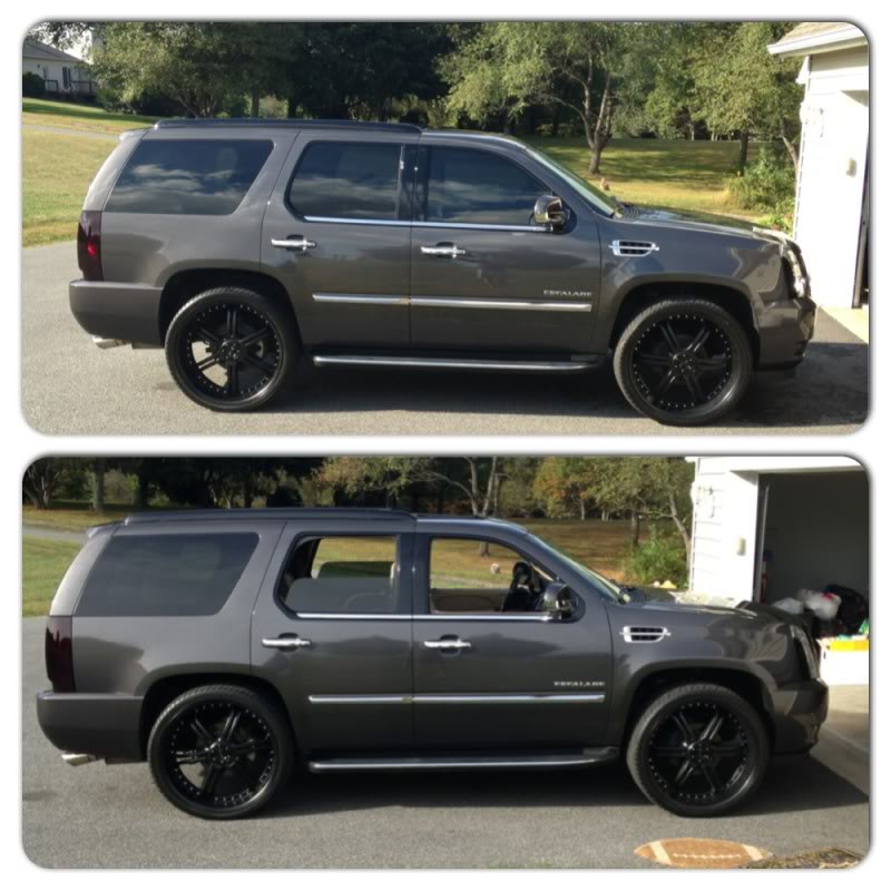

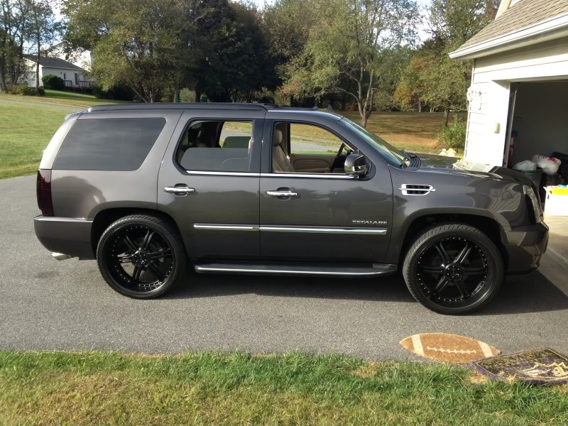

So I decided to install my rear springs today. Very easy install. I also left the 1" spacer as well as a 1/4"-1/5 stock bottom rubber mount. So probably isn't a full 3" drop yet. So once I do the fronts I will take out the spacer and rubber mount. Looks ok. Def takes away that huge stock gab. has a little bit of a cali lean on it. So I should hopefully be doing the fronts shortly. Any some pics of it

Yeah I remember that. These are the same wheels I had on my 07 Tahoe.

Very nice but you gotta take pics from a different angle from your sig toooo confusing lol

What kind of lift are you putting on it?

Bwhaha. Shut it Nathan. Lol. I would love to go as low as you but def don't want to with the 26's. lowest I will go is 2/3-4. Hah

Looks much better getting that rear down. TOTM got you moving huh...jk.
I'm with Ben, pics be blending. If I scroll fast enough up & down, I can put ur ride on air. HAHA

I still have the bump stops in. So far feels fine. But I also still have the spacer in. I am going to see how the front sits after I install that. Plus I will see how the springs settle in the rear. I can tell you this kit is quality. The ride is night and day compared to the lowered Tahoe with groundforce springs in the back. But also I think the escalade air ride helps as well

Also can say this is defiantly a lot lower in the back then what my Tahoe was

what is the offset of your wheels like 15? look like they stick out a lot. Be careful ive had more than a few cutomers warp there 1/4 panels on 26s when truck came down and hit tire since offset stuck out way to much

I can't remember off the top of my head the offset. They actually don't stick out in the back at all. Fronts stick out like 1/4 if that. Front going with the 2" drop beltech spindles I also had these rims on my 07 Tahoe with 2/3 kit
