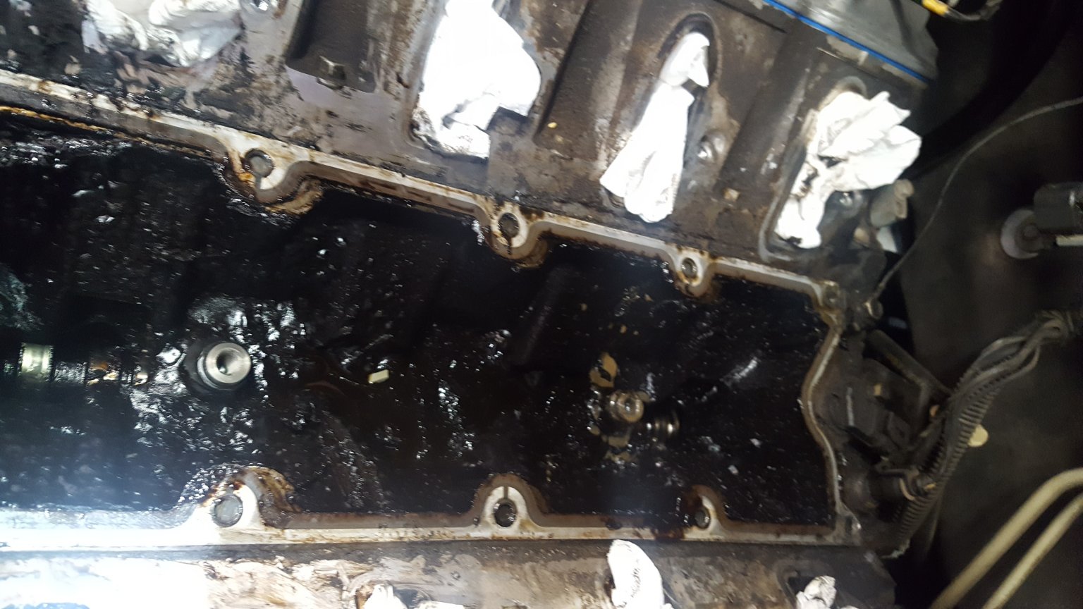

pulled off the intake for the knock sensor. the one in the rear had standing water, and a torn boot going down in to the valley. When i pulled the valley cover off, more sludge... What a freaken surprise. cleaned all that crap out. replaced the oil pressure sensor. going to button it up tomorrow. RTV'd the new knock sensor harness to the valley cover. no more water is getting in there!
my buddy who did my filter is a mechanic, he drove the car and said it's actually driving cherry. He said it sounda/feels great! so that's pretty good news.
